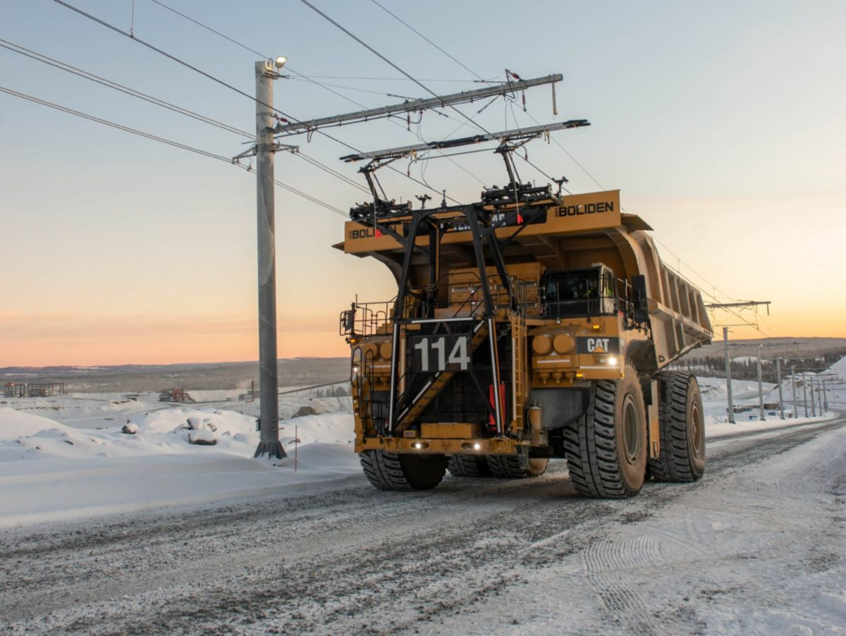

I left the auto electrical trade many years ago, around 1990, I sidewards moved to low voltage (50 - 1000 volt AC) although the electrohaul truck was from memory 11kV so auto electrics did involve high voltages with some applications.
1667663634645.png It seems some trucks do use high voltages! And I saw the problems testing ignition systems by touching the spark plugs when using capacitor discharge, he survived, but more by luck than good judgement.

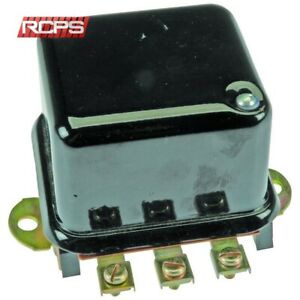

eBay has several, all looking much like the Amazon one, and as the attached pic. One said made in USA so hopefully built properly, but not sure it's worth taking a chance buying another.
What we'll most likely do is change the dynamo for an internally-earthed one, and use a conventional UK control box, have several kicking about. But it's not straightforward as it's an unusual layout, the pulley has a long overhang, so will need a special bracket making up.
