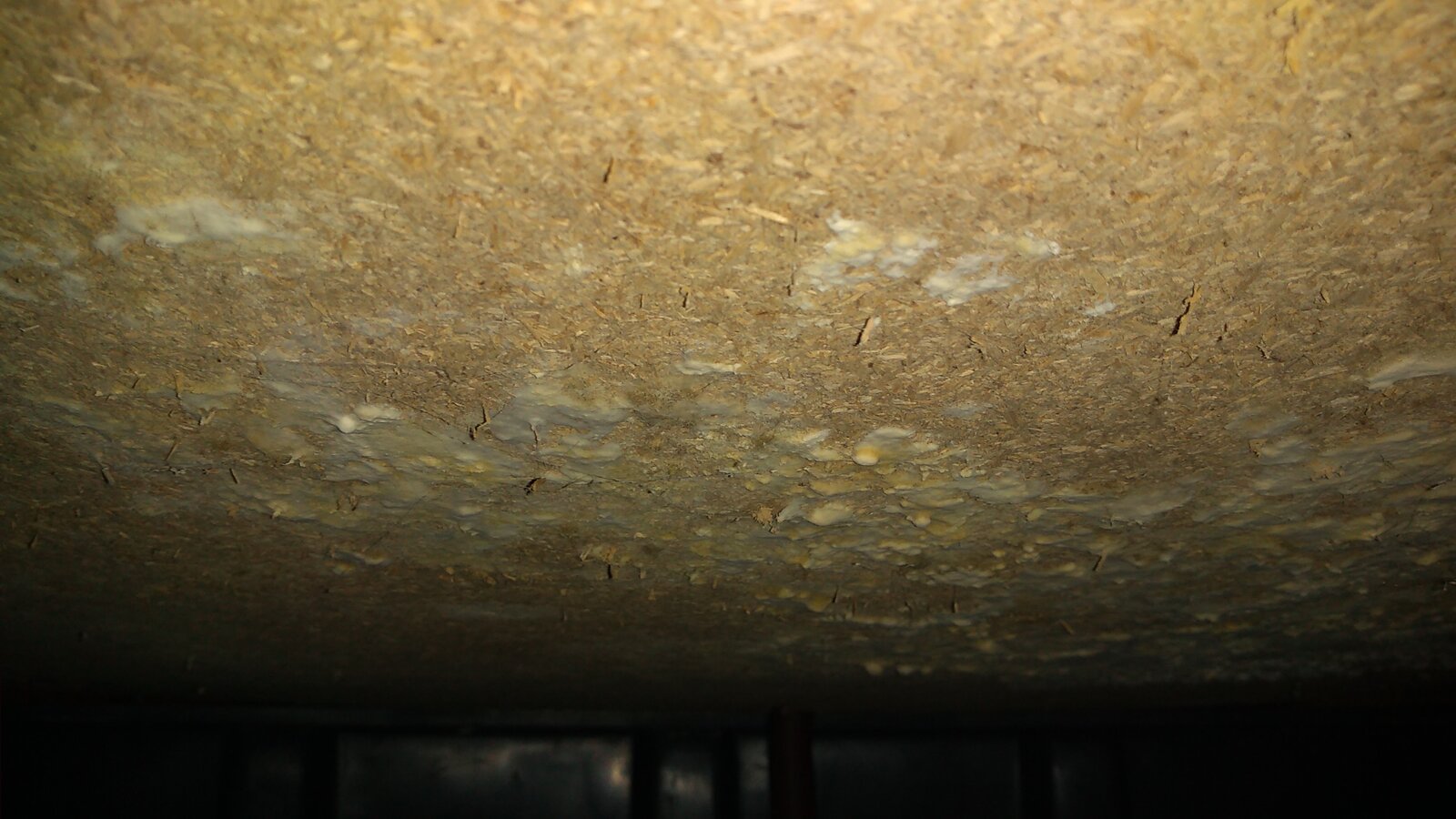

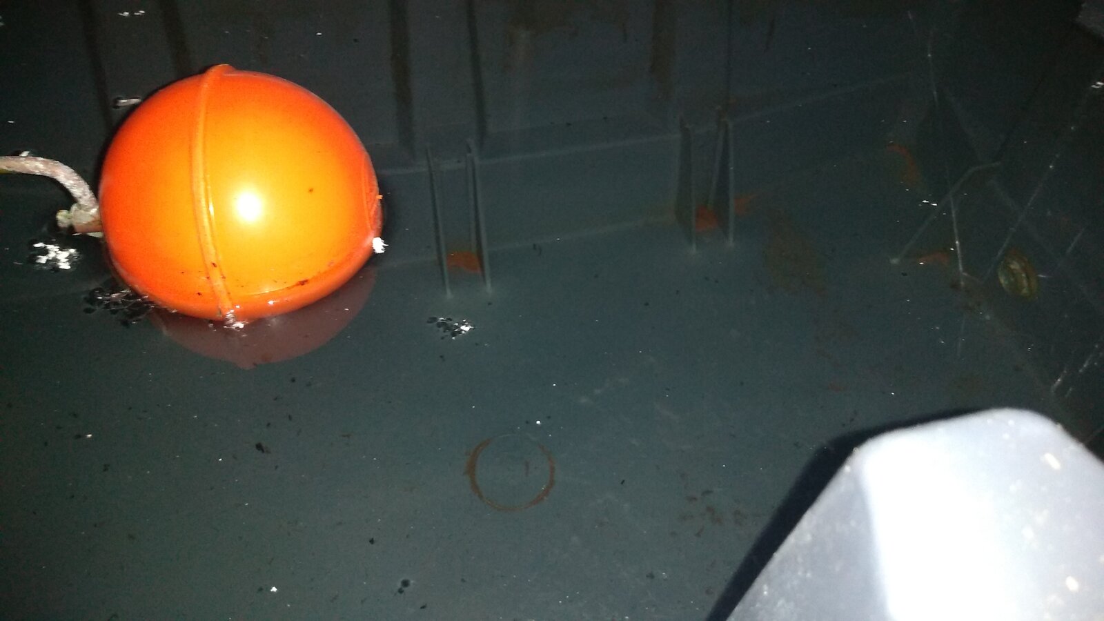

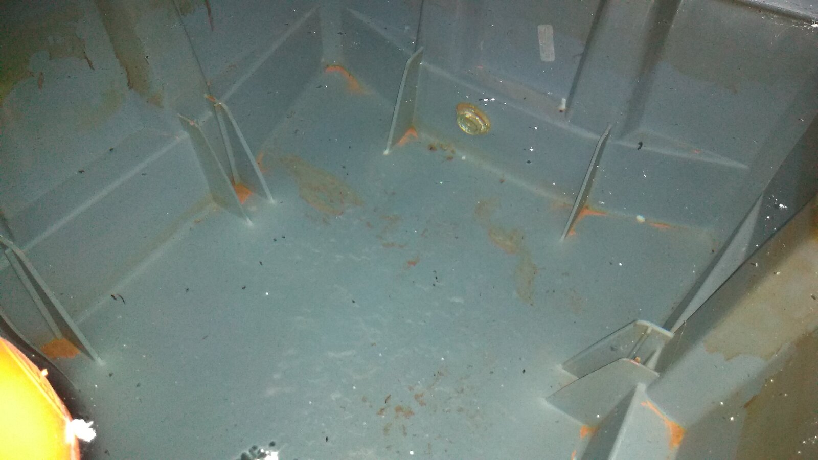

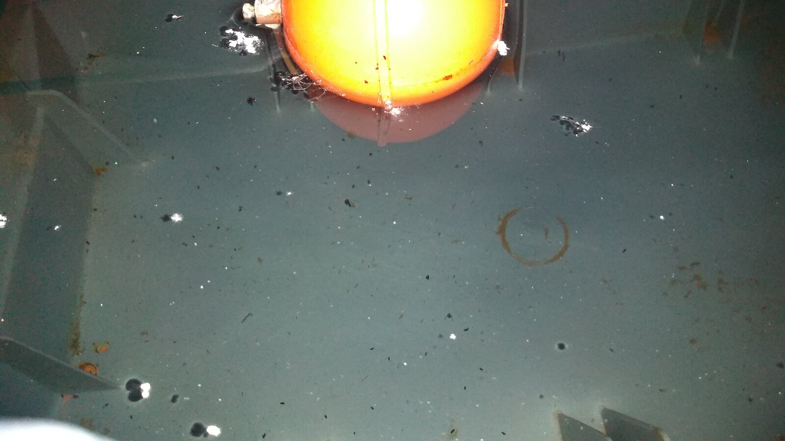

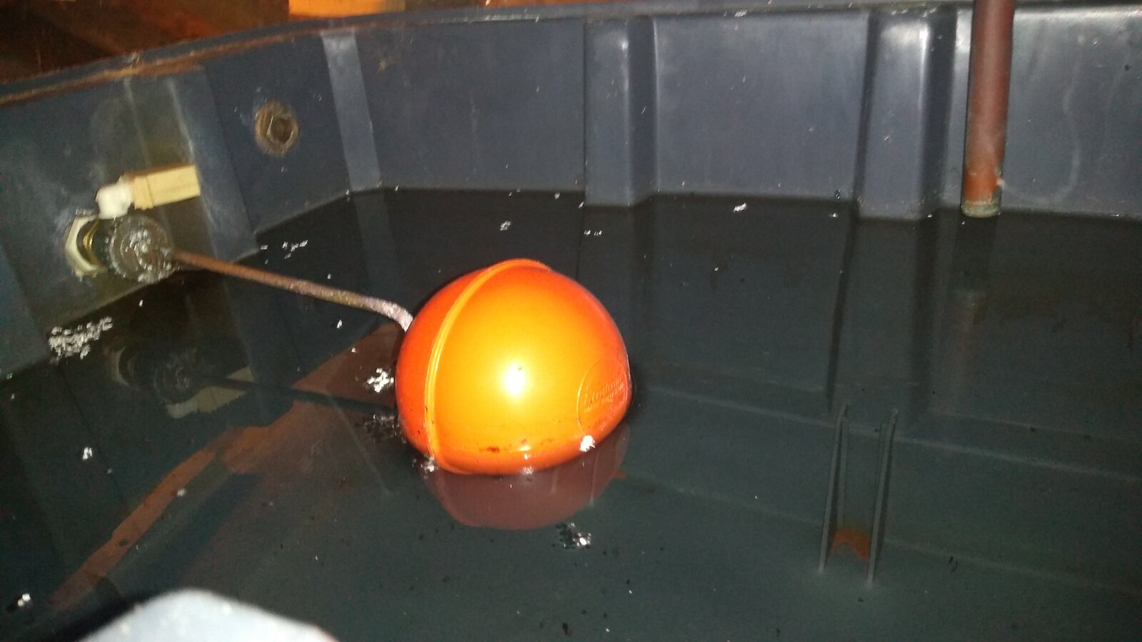

Took a look at the inside of the tank just now, and whilst there I thought I'd take some photos so those with a more experienced eye could say how it looks in the scheme of things. I appreciate not all nasties are visible to the eye though!
We've got vermiculite insulation so I think that's what the white floating bits are.
The underside of the "lid" has a coating of white mouldy stuff, so I took a snap of that too.

I am surprised just how clean it looks!
But it is the bacterial content that is the danger!

I would not want to drink anything from a tank like that.

Yours doesn't actually look very dirty, but is likely to be infected. I'd renew or replace anything in poor condition. You need a proper plastic lid, hygenic and tight-fitting, and an insulating jacket.
I once had a grubby fibreglass CWC. I drained it through the cold bath tap, scrubbed it out and rinsed it, again draining through the cold bath tap, when it looked sparkling clean used the chlorine tablets to sterilise it. This prevented dirt and cleaning materials washing into the hot cylinder.
It is difficult to drain a F&E tank without washing sediment into the pipes, so you need to bale it out into a bucket, then sponge it clean. You can use biocide in an F&E tank since you won't be drinking it.
At the time we were not living in the house much, so it was no great hardship. It did have a close-fitting lid, the dirt was limescale and rust particles, with a few drowned spiders. Lids can certainly harbour micro-organisms so need to be cleaned, as does the ballcock or anything else in the tank.
