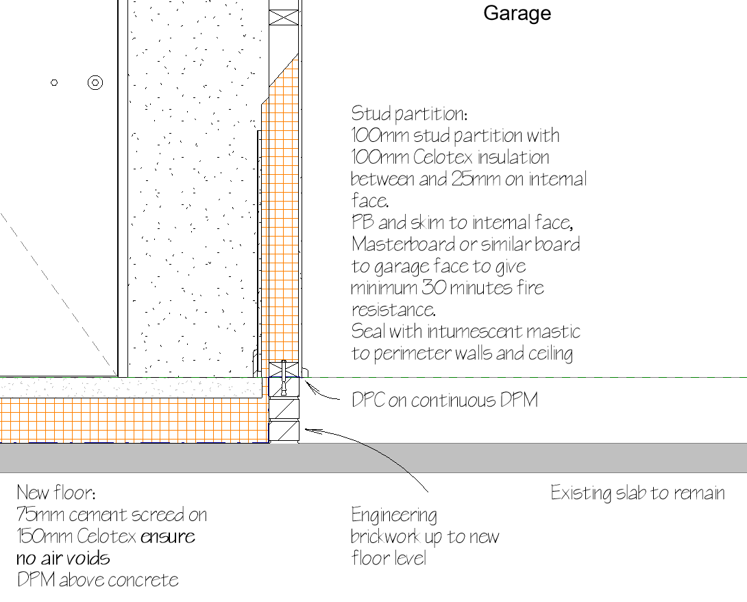

The drawing is from my hard drive, so you wouldn't have found it.
You don't need a breather membrane. There should be no gap between the two pieces of insulation, the gap can be on the back. You may find that your 4x2 is actually more like 94mm anyway.
I don't understand the bit about a "bund" for the floor, but there should be no air gap in the floor

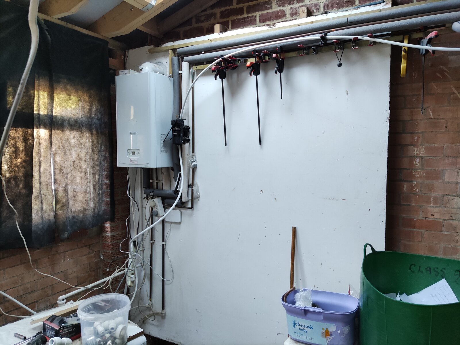

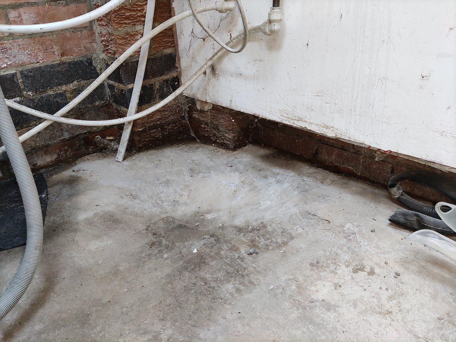

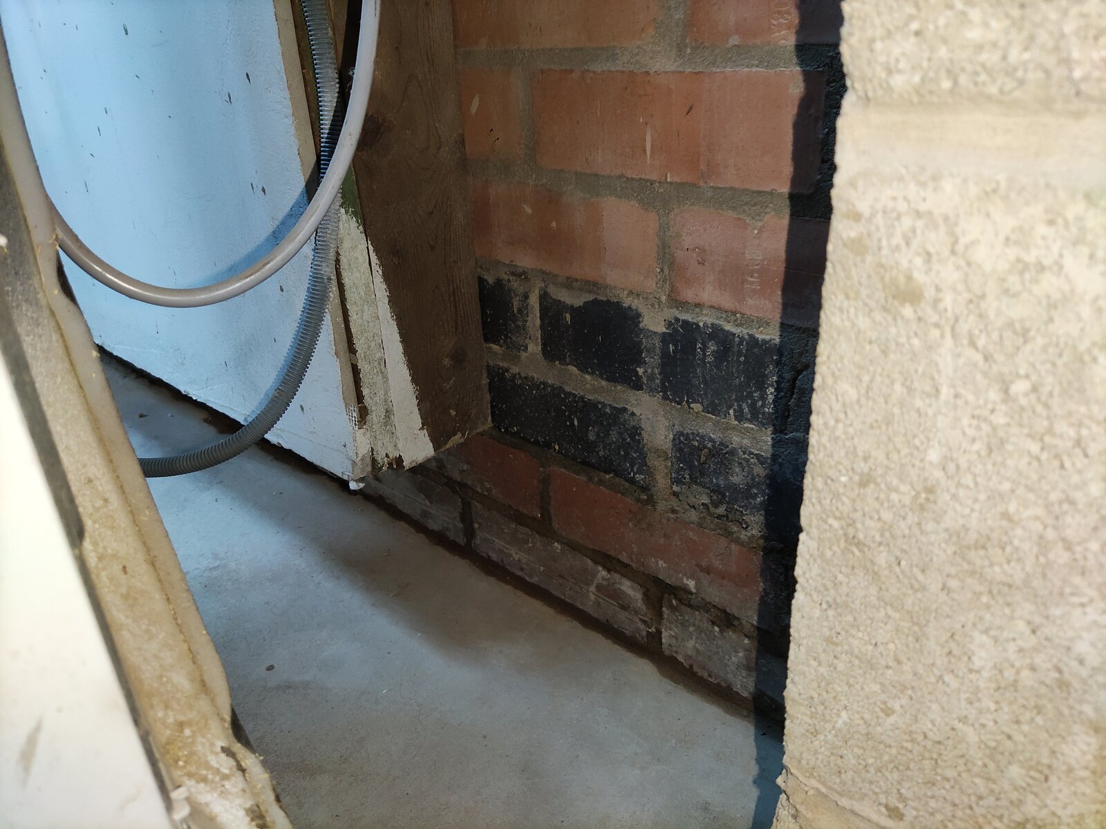

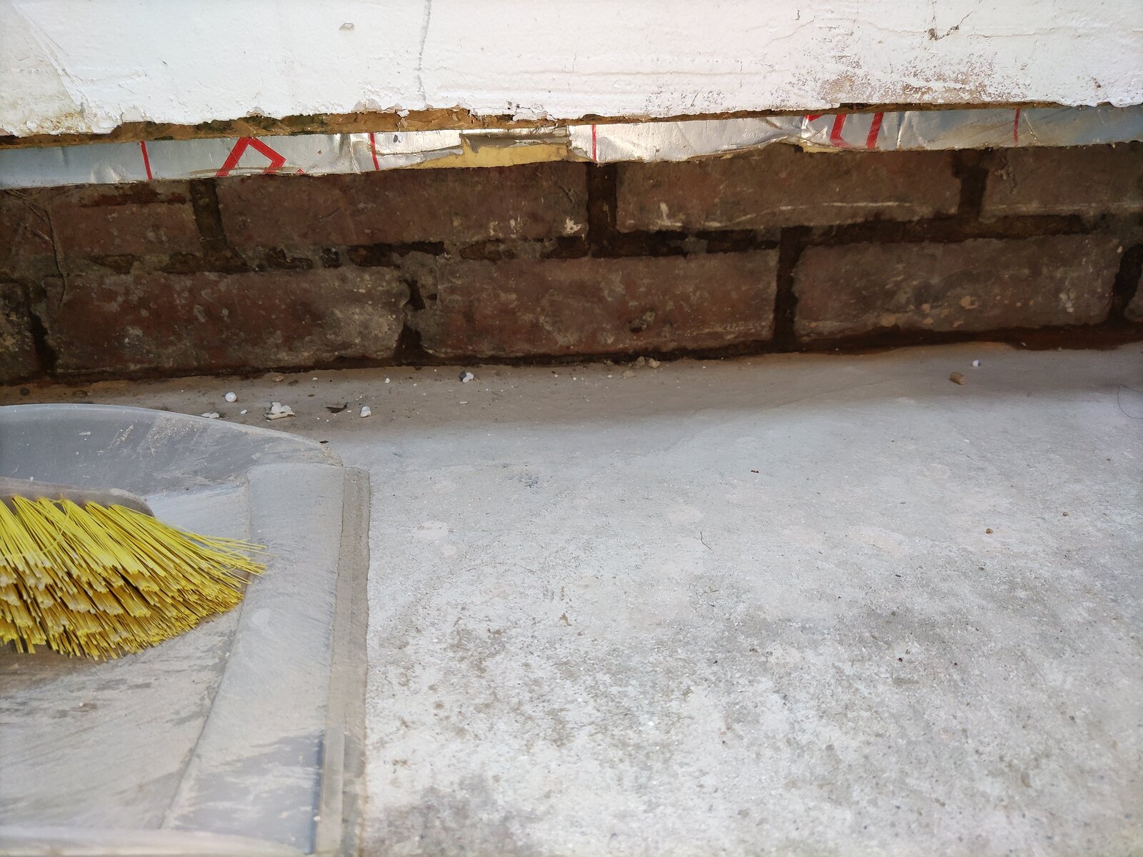

Here's what I'm playing with,
IMG_20210211_101014.jpg IMG_20210211_101024.jpg IMG_20210211_101039.jpg IMG_20210211_101150.jpg
The damp is coming through below the dpc on the wall closest to the neighbors. My plan is to lay engineering bricks 50mm in from the wall to form a perimeter to stop any moisture getting at the new walls. Then line the new area with a Dpm and fit the PIR in tight for the new floor.
There's a 1ft gap between us and the neighbors and their property is 2ft higher than ours. The ground level between is level with our concrete floor.
The boiler wall was lined with PIR board between studs about 7 years ago but there's no DPC between the studs and brickwork. I'd love a workaround for this that doesn't involve taking the boiler off the wall and starting again with a new wall.

Well if you do it like the drawing and DPM around the utility floor, than that should do it.
Presumably the damp coming across that garage wall is not at a higher level than your new utility floor level. Otherwise you'll need to take the DPM upstand further up the wall

I don't specify slip layers as they are unnecessary. Just use DPM as per that image.
The image shows the principle to apply to seal the new room from any dampness. If walls are susceptible to dampness then a DPM will need to be taken up the wall too and lapped and sealed with the floor DPM.

Can I leave the boiler wall as is or am I asking for trouble with the building inspector or damp in the future.

You'll have to get the building inspector's advice on how to treat or adapt the wall behind the boiler. Strictly is should be treated the same as other walls if it's external, but there may be options.
