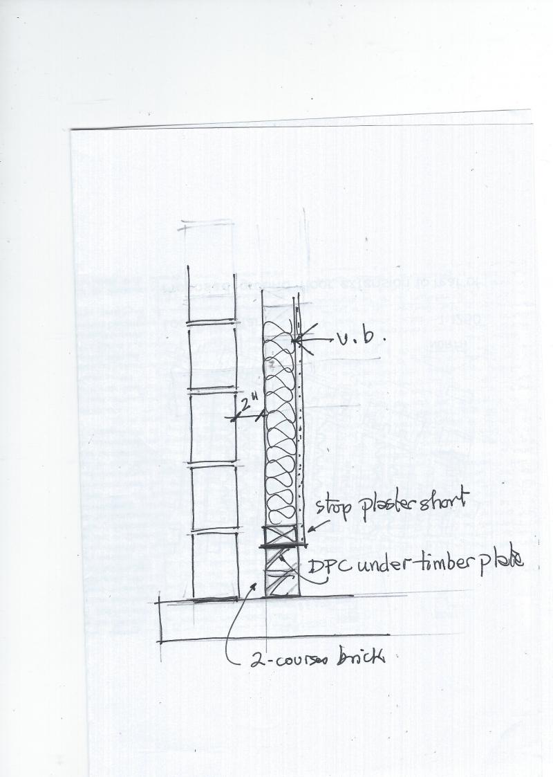

Walty; your problems here are twofold;
1. stopping interstitial condensation in your insulation and studwork and
2. stopping leakage into the cavity from the blockwork.
Number 1 is fairly staightforward, as you just apply a vapour barrier across the studs before fixing the plasterboard. Some argue that the foil on the PIR boards themselves is sufficient as a v.b.
Number 2 is much harder to solve because ideally the studwork is fixed first, and then the blockwork built up. In that way, a proper cavity tray can be incorporated at the bottom of the wall, and any leakage from rain will be directed away from the studwork and discharge through weepholes.
In your case, I don't see an effective way of stopping water ingress from getting at the sole plate. One way of keeping the studwork dry would be to build it on a couple of courses of brick (see sketch). This would preclude any insulated floor, and would perhaps be a bit 'shed-like' rather than home office. I suspect your initial design may be too sophisticated for the structure you already have, what with additional flooring/skirting boards etc.
If you don't want smelly damp/rot problems futher down the road, you may need to compromise and make your structure and finish a little more robust and utilitarian.
Why would putting the bricks in preclude insulating the floor? I could just run DPM over the brick before fixing the sole plate.

If you have a vapour barrier on the warm side of the studwork, under the plasterboard, you won't get condensation in the studwork or the cavity. The vapour barrier could be either plastic sheet, or the foil on the outside of your Kingspan, with joints taped.
If you have any sort of DPM at all under the soleplate, you won't get damp rising into it from the floor.
If the outside of your garage wall is rendered, painted and well maintained, you shouldn't get rain penetration through the blockwork.
In these circumstances I think breather membrane on the inside of the studwork serves no real purpose, especially with tanalised timber.
That's how I did my utility room anyway. It used to be a coal shed. I'd just do it and not over-think.
