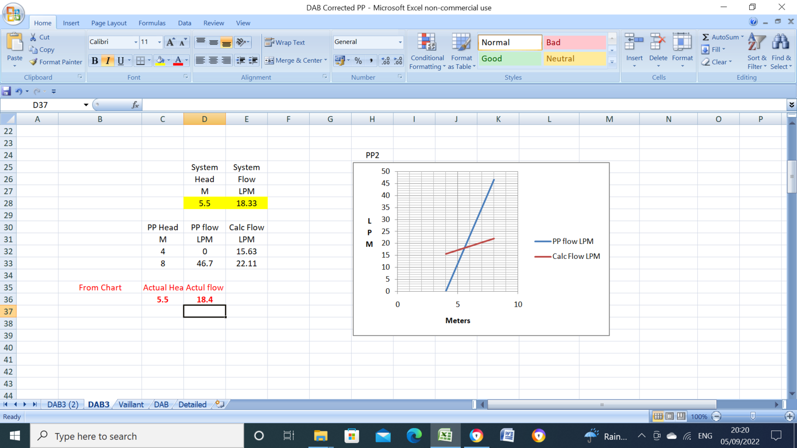

Is this a externally mounted circ pump? and does it display the head in M (you quoted 4M & 3.5M above), if so it might also display the power in watts, W, if so you might post these readings for the CP and PP settings.
On constant curve-
5.5m
Q= 1.1 m3/h
S=3279rpm
P=58w
H=2723 h

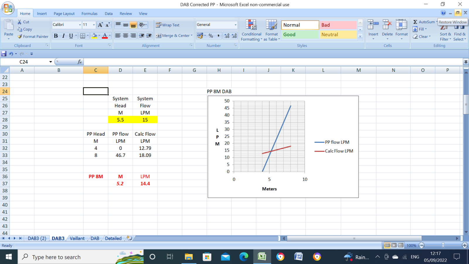

Re the pump settings, I can definitely tell you that based on the values above that the pump on a PP setting of 8M should give almost exactly the same values as the CC 5.5M. If not then there is a problem somewhere in the pump controller.
Can you post the values when running in 8M PP mode.
Proportional seems to also now be working, I think increasing the boiler temperature from 65 -> to 67c+ D0 from 22kw -> 15KW has allowed it to stop cycling as much and push the water out more gradual

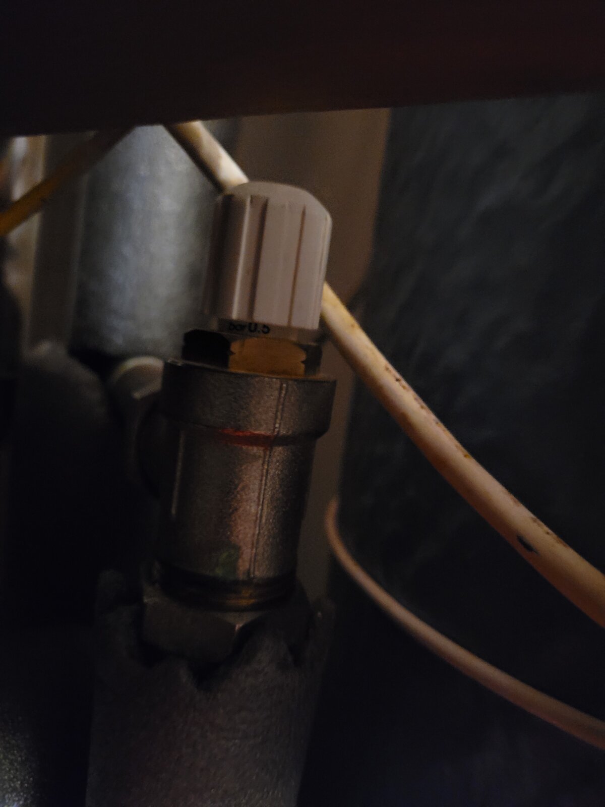

The return doesn't have any gate valves except on the other circuits , that have separate wlmotorised valves on the flow which are shut atm.. and those gates are open anyway.
The only other thing on the return is a prv type thing as per attached.
Wonder if i clock back the boiler kw output further again it will allow it to pump without cycling as it's more gradual.

The minimum output is sometimes shown in the users manual, the 938 manual (can't find a 438 manual) gives a minimum fuel input of 7kw which at say ~ 85% efficiency would be around 6kw minimum output, if the demand is below this then the burner will cut out and boiler cycle when the flow temperature reaches its setpoint or target temperature + 5C. You are limiting/controlling the the maximum output which does nothing really once the demand is below this, it obviously does limit the cylinder heat up time while the coil output is greater than this set limit.
If the flowrate is 1.0M3/hr, then (assuming) a 6kw minimum boiler output will mean that once the boiler dT falls below, (6*860/60/1/16.66), 5.16C, it will cycle.
