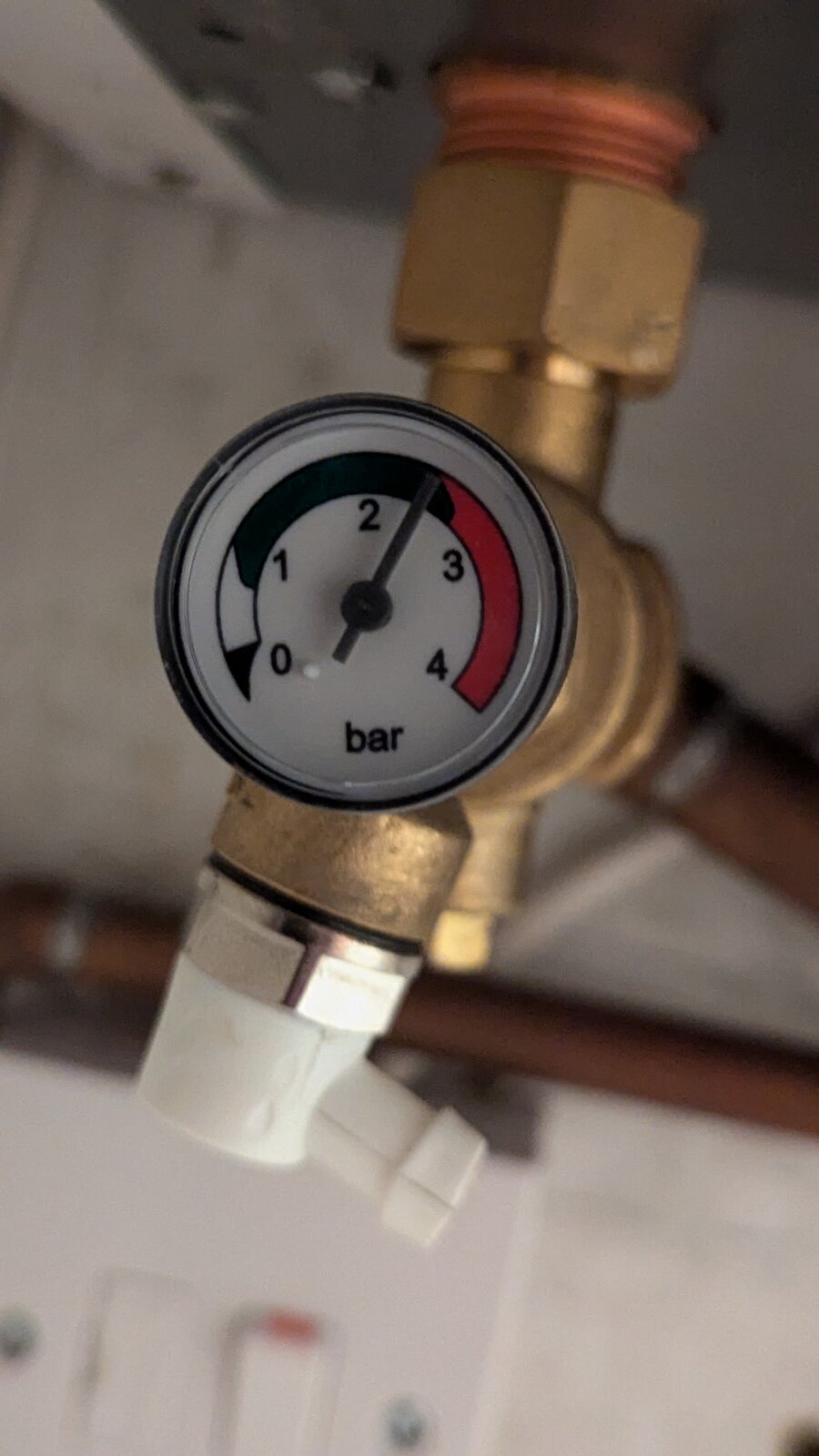

Sorry to OP if I hijack but I've a 14 rad system and the cold pressure is 1.4bar and with the heating on it goes to 2.7 bar max, but usually 2.2bar, depends on how much heat demand I think. It's a 111-w boiler and some old rads, 90's stelrads mostly, and one is 3m long but no idea on total volume, always presumed 100L. It's recently been converted from a open vent. I believe the EV is 10L. Should it have a second EV fitted ?

Yes, would recommend a 2nd EV. A 12L should be fine and get the internal one checked to ensure it's set correctly too.

Thanks. Boiler only been in a month so I'd hope the installer set it correctly, they are viessmann installers. I'll speak to them about a 2nd one next time they're here for other work.
If I leave it, will a radiator burst or what is the risk? Thanks for the help

Radiator shouldn't burst if it's all installed correctly but you are reaching the limit for the PRV to start lifting.
I have no idea what they were thinking about when they thought that the internal EV would have been sufficient, for what sounds to be a reasonably good sized system. You could probably drop the cold pressure to 1 bar, just to keep the high limit down a bit. Just bleed a rad down until the gauge hits 1 bar.
I'd get in touch with them sooner rather than later as having the system running up to that pressure is putting stress on everything, not ideal. Especially if it's only been in a month!!

Thanks again. I've got it on at the moment, is at 2.6bar and the boilers not even working particularly hard. I'll send a photo of the pressure gauge just almost about to tip into the red and see what they say. They've been great so I think they'll be fine adding a new EV, id expect to pay of course.
Will drop the pressure to 1bar in meantime.

I found the ridiculousely thin copper tube to the dial was broken, when I dropped the bottom door I got sprayed with water ha ha.
The tube was traight and got caught on the inside of door, i replaced with new one and kept it slightely coiled, filled to just under 1 bar, seems ok now (cross fingers).
