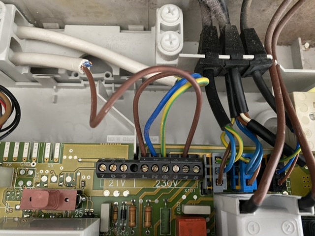

I’ve inherited this old boiler with our new house. It’s a Thermocompact 620e System Boiler with separate hot water tank.
I’m confused about the wiring as there’s only 1 wire to the boilers control connections as shown below.
Upstairs is the cylinder with 2 motorised valves, connection box and Honeywell timer. Thermostat is in the hall downstairs.
Any ideas how I get this connected up? Anyone know how the boiler controls both heating and hot water from one control wire?
Andy
Your nest controls the zone valves and the zone valves control the boiler, google nest with s plan and there are plenty of wiring diagrams available.
