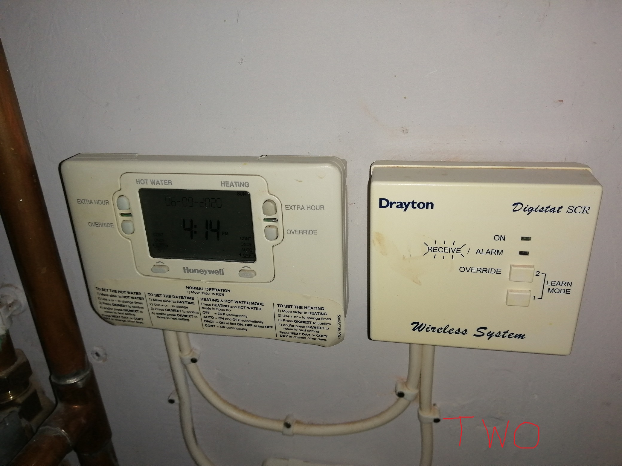

Boiler appears to be working fine. The Honeywell controller (see pic 2) successfully activates the boiler once a day to heat up a tank of hot water (large copper cylinder ‘vented’ fed by storage tank water loft) on automatic. Alternatively activating the hot water ‘ad hoc’ via same controller also works fine. So in my mind there is no actual fault with the boiler operation.
Problem arises when activating the heating. Request heating, the value (see pic 3) opens (audible) and the light on the Honeywell controller remains on for heating operation. However the boiler fails to fire up.

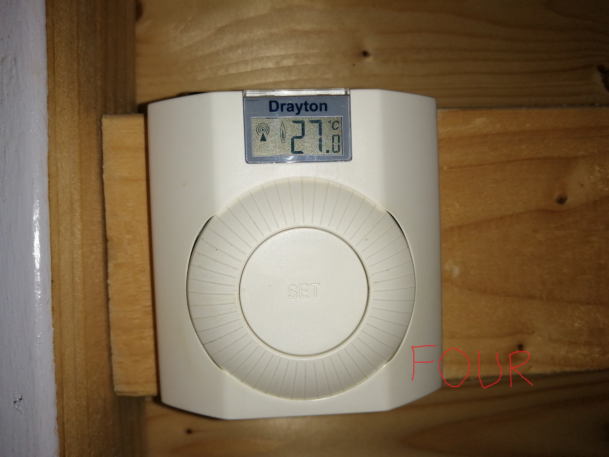

This issue has happened on many previous occasions primarily as the Drayton digistat (see pic 4) is either turned down too low (no flame on display), the batteries are failing (same device) hence the wireless signal fails to reach the Drayton digistat SCR control box (see pic 2) or indeed an error has appeared on aforementioned control box (simple power off/on reset resolves). I’ve addressed all these issues yet the problem persists.

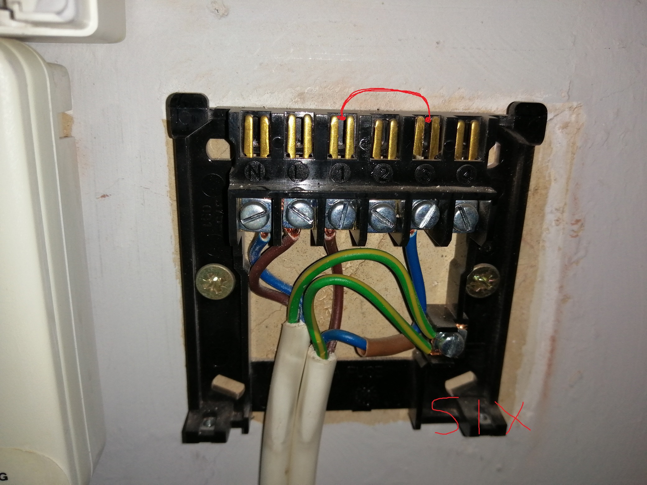

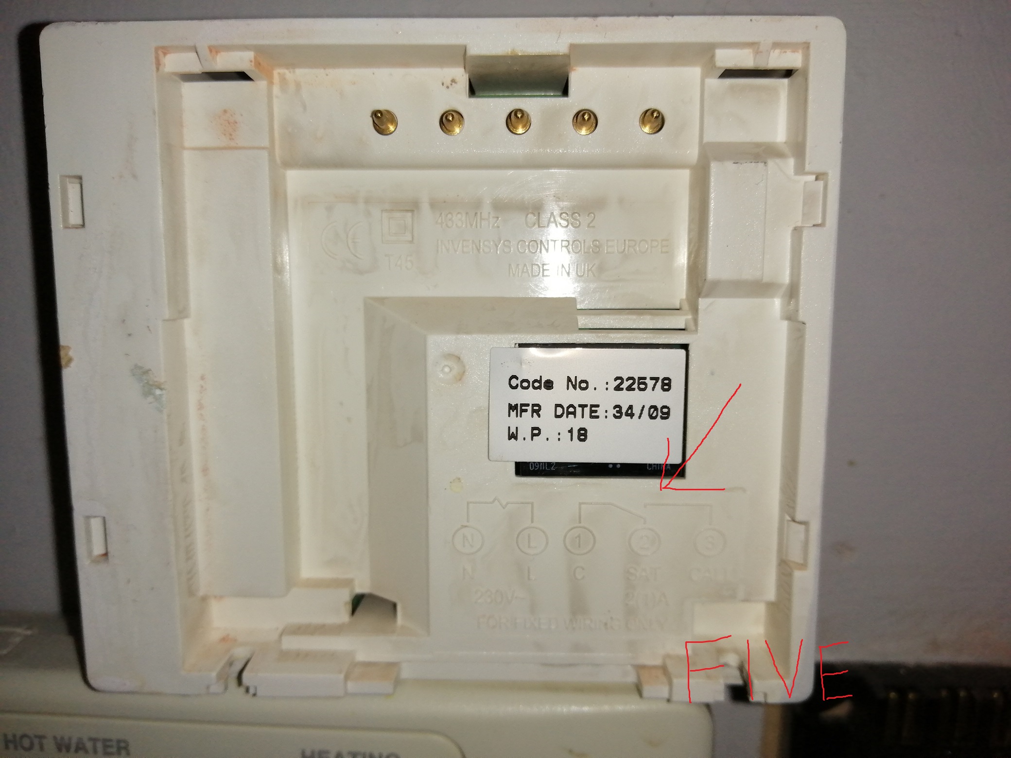

Convinced the boiler is not at fault, assumed it must be the digistat. Removed the front housing of the digistat SCR (see pic 5) and bridged the connection manually (see pic 6 – indicated by red line) with wire then operated the heating via Honeywell controller. Same thing happens, valve (pic 3) opens, Honeywell controller heating operation light remains on but the boiler fails to fire up.

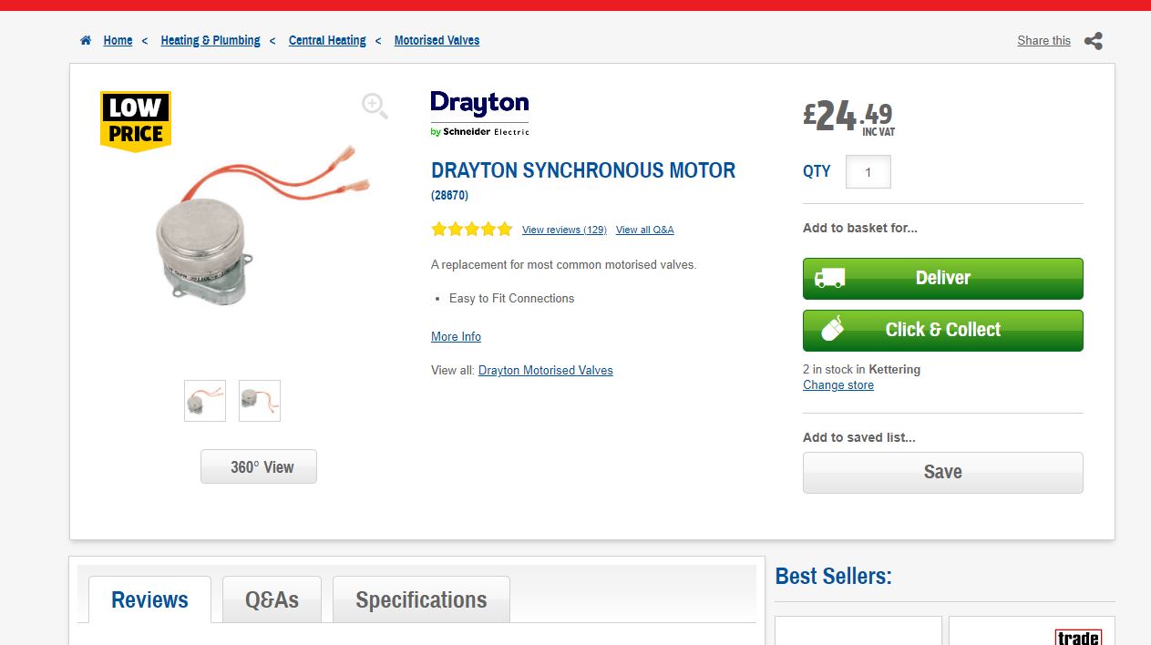

A little further reading it seems for ease (avoid draining the whole system down / replacing the valve assembly which doesn't appear faulty) a straight swap of the sychron motor is the best (cheapest / quickest) fix. Found one on Amazon that's suitable for a tenner. Even better :)
Thanks for the offer but I'm trying to loose some lockdown lard. :)
I suggest you only buy the genuine Hansen synchron motors...eg. the Screwfix/Toolstation Drayton replacement motors in the bag (they fit).
All the knockoff valves are hopeless...I've had them last as short as a year.
That's good to know. Screwfix is only round the corner / got them in stock.

Follow up - Drayton Synch Motor purchased from Screwfix (see above for picture). Fitting took approximately 30 minutes, very easy. Only difficultly was access as it's in a tight space. Working a treat. Thank you so much @Gasguru for correct diagnosis.
