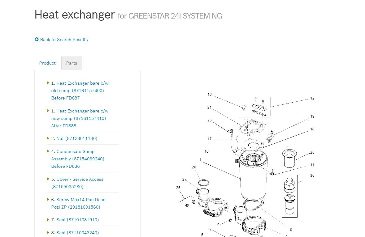

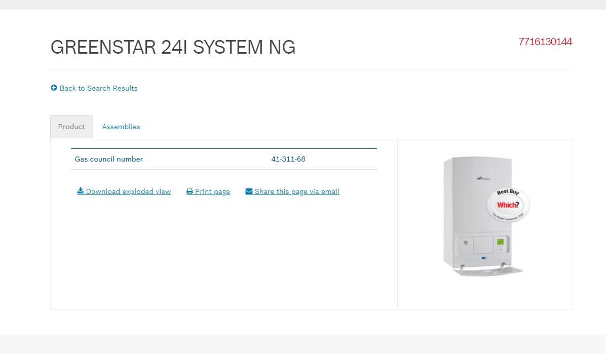

Our boiler (see above picture) which I've identified using the GC Nr needs a new main heat exchanger. Advised by heating engineer, excess heat over time has caused damage to the outer aluminium case.
I'm assembling all the relevant parts he requires for this procedure prior to booking him for another visit. The heat exchanger is proving to be problematic as there are two types (visibly almost identical)
As you can see from the above picture it's either Heat Exchanger Old Sump (Before FD887) or Heat Exchanger New Sump (After FD888). So it seems the only difference is a design change to the clip on black plastic sump assembly.
Heat Exchanger Old Sump (Before FD887) - Part No 87161157400
Heat Exchanger New Sump (After FD888) - Part No 87161157410

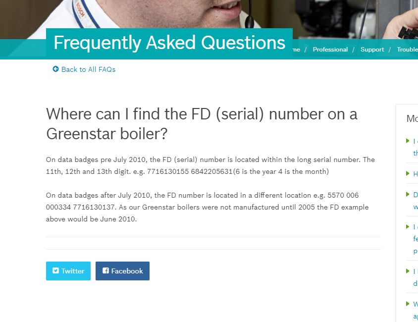

According to Worcester website (see above picture) the data badge pre July 2010 (boiler commissioned Sept 2009) provides the FD number as the 11th, 12th, 13th digits.

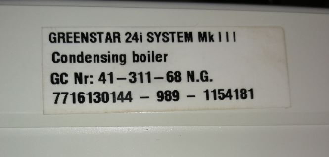

Therefore glancing at the serial number (see above picture) you'd expect this to be 989. Hence Heat Exchanger New Sump (After FD888) would be the correct part to order.
Can someone who is familiar with these boilers just confirm what I've stated is correct. I'd just rather be 100% sure, not order the wrong part and end up having to pay the engineer for a wasted trip.

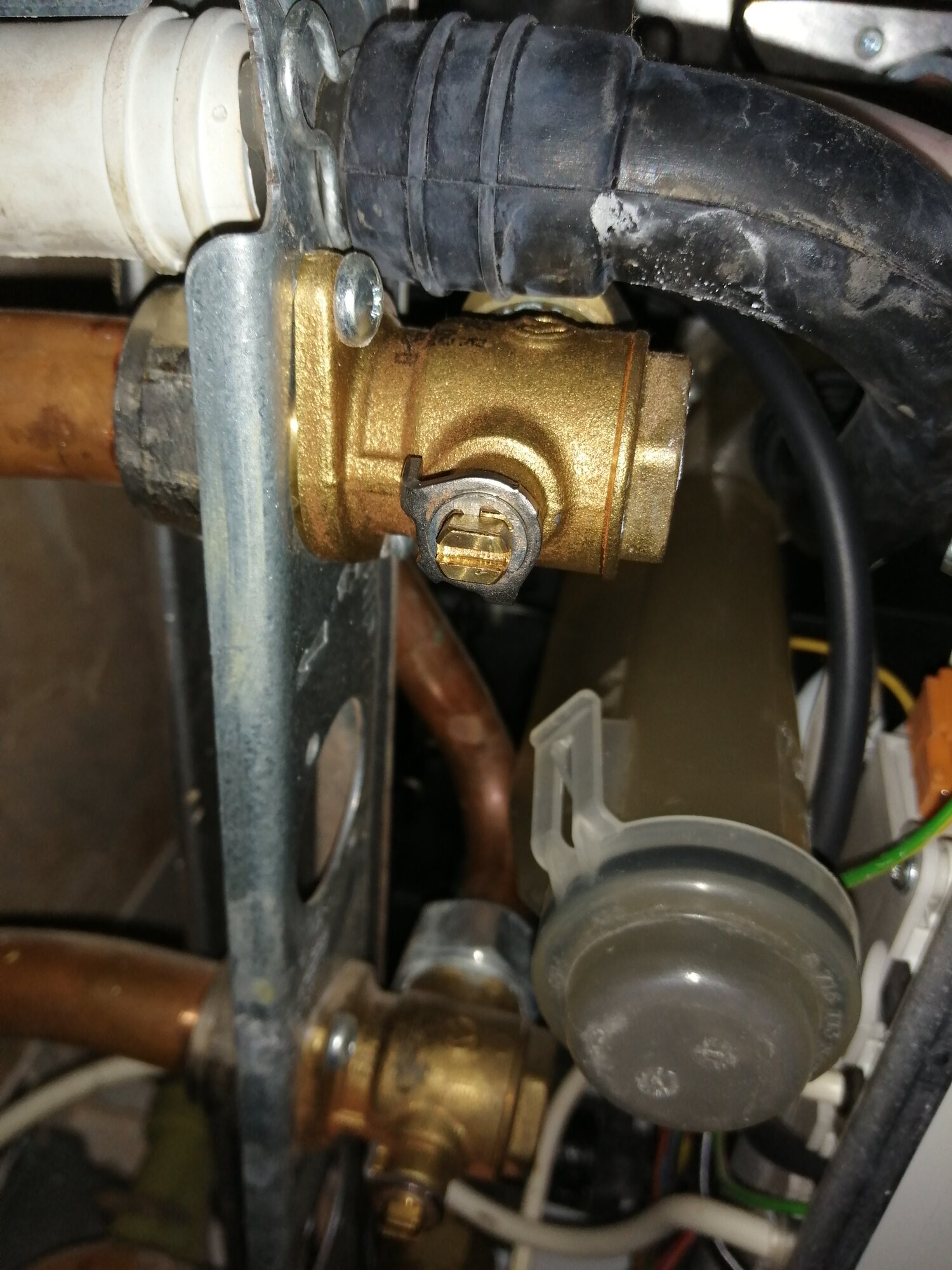

Slide out the plastic tray cover under the boiler (if it's still fitted) and post a picture looking up.
The earlier heat exchanger models have a rectangular condensate trap on the lower LHS, the later models have a "bottle" type trap more towards the centre with a circular cap at the base.
Thank you once again for your response. The picture below shows it seems to be the bottle type trap
hence my initial thoughts regarding the later model of heat exchanger (according to the serial FD number) with the new sump appear to be correct.
Your response was incredibly useful @Gasguru as everything falls into place now.

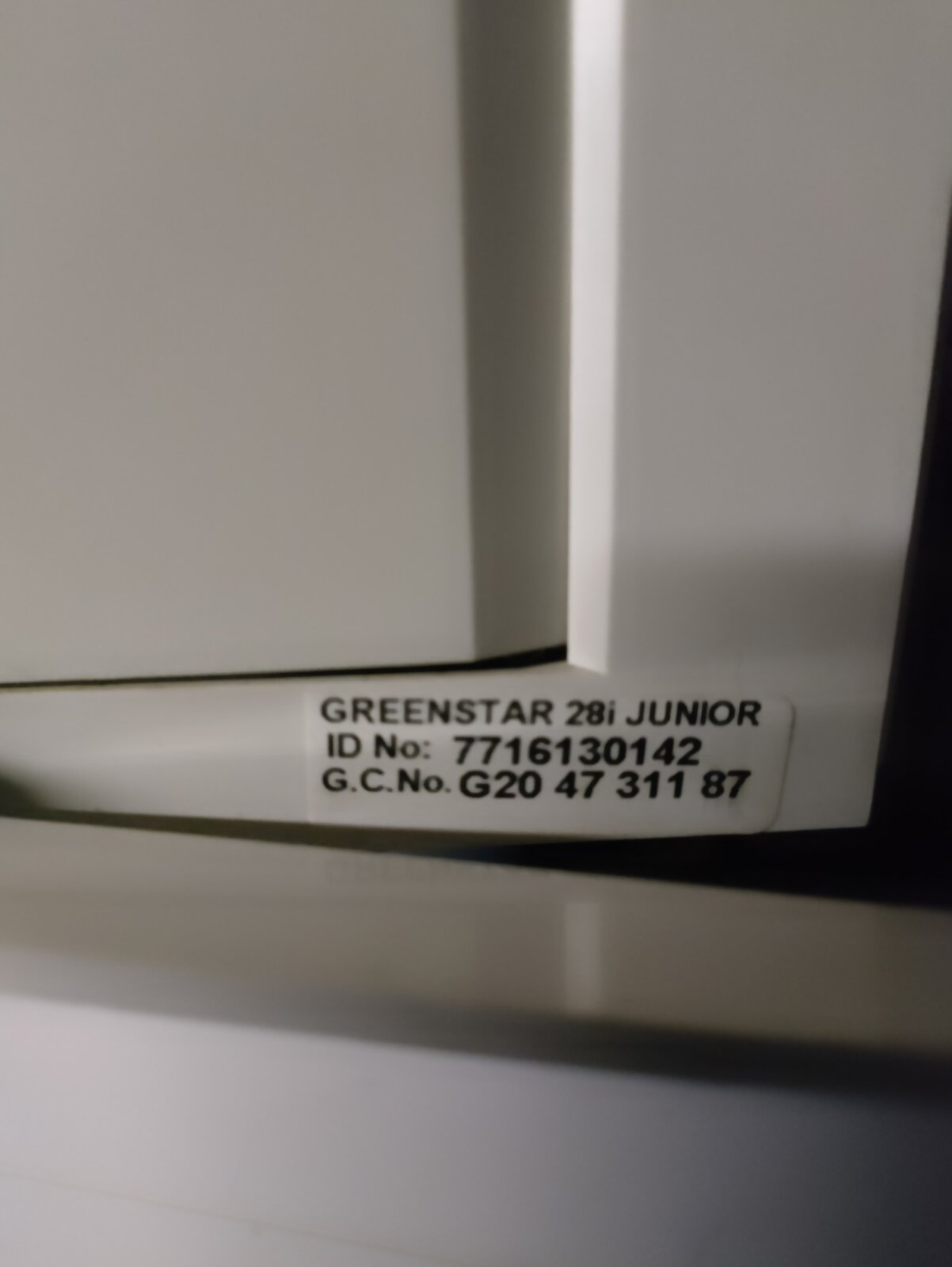

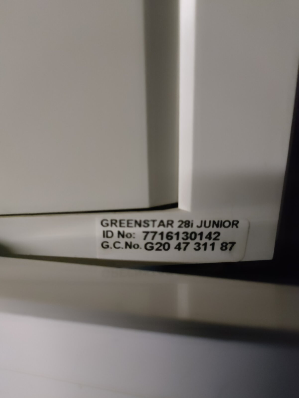

Sorry to resurrect this old thread. I too need to now replace my heat exchanger, I suspect mine is the old sump type. ( GREENSTAR 28i Junior ID no 7716130142 & GC number G20 47 311 87. I can get a far better price on the new Part No 87161157410 and was wondering is there any reason why this could not be fitted - is there any other technical reason it cant be fitted ? I had the condensate trap replaced and the new one is a completely different shape and design but fits perfectly. Also I note the "sump" part of these heat exchangers are also a consumable part. If for any technical reason the Part No 87161157410 could not fit, could my plumber not simply swap over the sump from my existing heat exchanger onto the new unit which has a different design.
