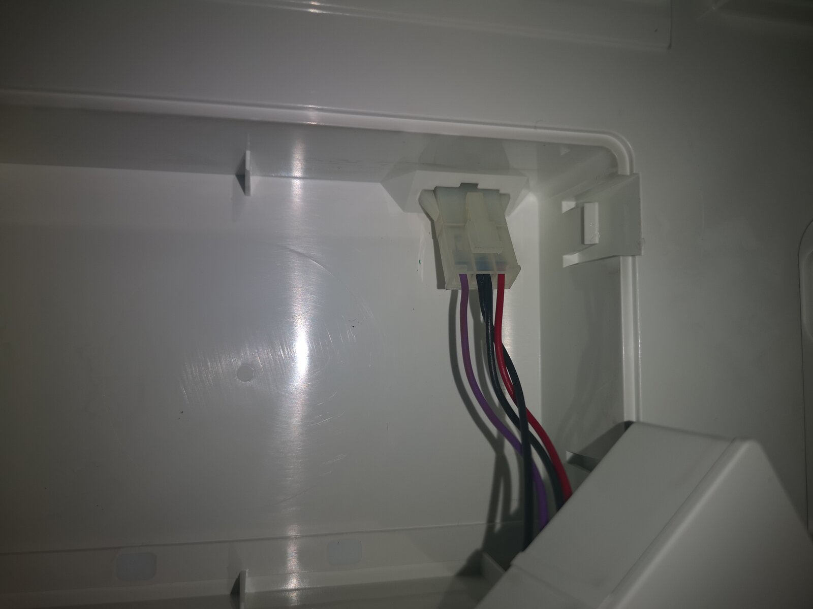

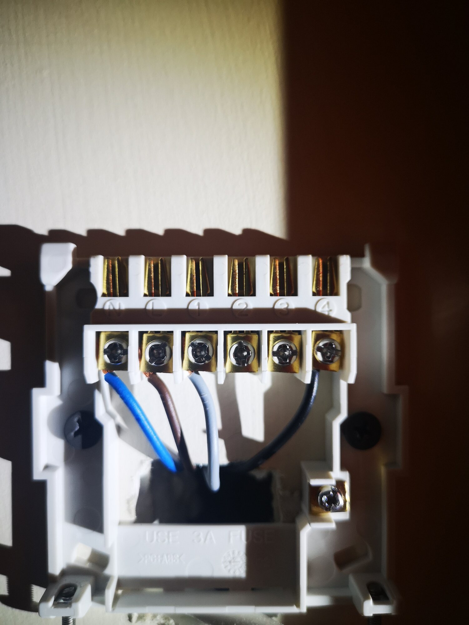

Wondering if you can help with issues relating to a hive install, the system is calling for heat but the boiler fails to fire so suspect the wiring is at fault as this is a new install so images are below of said wiring.
I found a post on here from over a year ago & the wiring does match that install which was stated to work so am a bit lost really.
Any help would be appreciated.
Carlos.
The black in 4 should be in terminal 3.

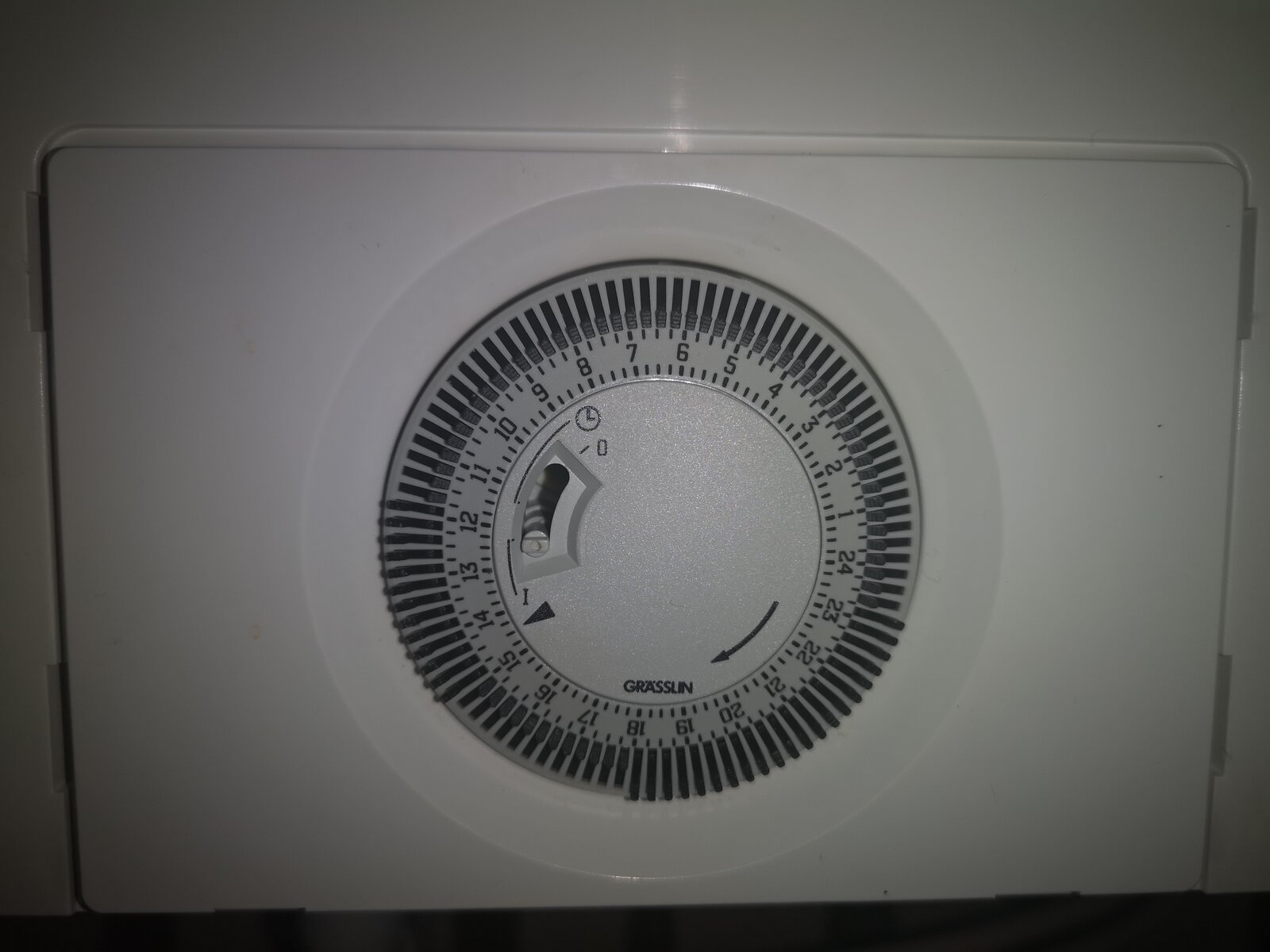

Could it be that the timer is still in the circuit even though it is set to be on constantly?
A shame to be putting a crappy on/off Hive onto an OpenTherm capable boiler. Also, you shouldn't have the front cover off your boiler - it forms the safety room seal and should only be removed and refitted by a Gas Safe Registered engineer, who can then carry out the safety Regulation 26.9 checks on completion.
Ideally you'd take out the old programmer altogether and bypass it. There should be a plug in the boiler for this purpose. That would eliminate the possibility that the existing programmer isn't operating correctly.

The regulations are there for your safety, but hey maybe you're not bothered about that. Can you post a picture of the recess where the old programmer was?
Hi muggles, ianmcd
The timer on the boiler is shown below.
Set to timed and push all pins in, see if it’s then fires up.
Just re read your post and seems you have posted pics of someone elses boiler, dont do that it just gets confusing , post pics of the wires you have connected at both ends, and as already said you shouldnt be removing that cover
pic one thermostat wiring is white and black, pic 2 the same wires are Brown and black so how did this happen ?
Wow...
If its what I think your on about its due to the fact they connect to the pcb at different points so the cable/harness for that give area of the circuit can be whatever you want it to be & what's shown... The original wiring..
If its not that your on about then it's just the fact one image had flash on, the other didn't so maybe the colour appears to you different but I'm struggling to understand what your actually on about here as the colours match
