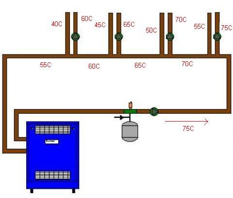

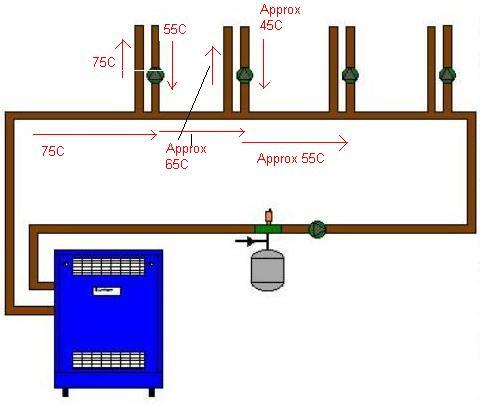

D-hailsham , the parallel set up is simply each pair of secondary CST's are conected across the primary F/R (all zones recieve the same temperature) , the 'diagram' i was refering too was the one you posted from the internet regarding the CST and not the diagram you posted regarding the OP's set up.
the parallel set up is simply each pair of secondary CST's are connected across the primary F/R (all zones receive the same temperature) , the 'diagram' I was referring too was the one you posted from the internet
I assume you are referring to this diagram:
If so, the zones do not all receive the same temperature as this diagram makes clear. What each zone receives will depend on the relative proportion of the flow and temperature drop in the earlier zones.
Yes , which is a series set-up
Yes I know , the parallel set up WILL allow a constant temperature across the zones , you have posted a SERIES configuration much like a 1 pipe set-up.
If we were to connect EACH pair of CST's ACROSS the primary F/R then all zones would recieve the same temperature (ladder system using CST's).
If we were to connect EACH pair of CST's ACROSS the primary F/R then all zones would receive the same temperature (ladder system using CST's).
I see what you mean. But what happens when only one zone is open? The excess flow has nowhere to go.
Of course it does (back to boiler).
First zone is far right of that drawing , your temp drop suggests otherwise.
Go for it , 20 kw load per zone @ 20dt temp drop.
If that's a 20C dT per zone you get:
Zone 1: Flow = 75; Return = 55
Zone 2: Flow = 70; Return = 50
Zone 3: Flow = 65; Return = 45
Zone 4: Flow = 60; Return = 40
If it's a 20C deltaT at the boiler then it's a different game. I'm still working on that one.
I hadn't noticed the pump and automatically thought the flow was clockwise.
I've just realized there's no difference! Although the return water from zone 4 is 40C, the return to the boiler will be at 55C. giving a 20C delta T at the boiler.
