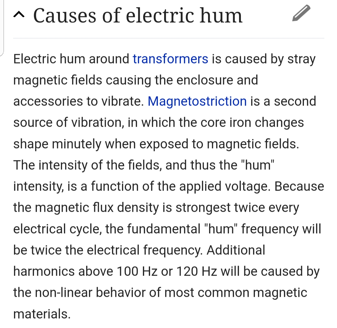

Whatever, but no way is it 100 hertz. 1 full hertz has a positive and negative trace, so 50 hertz can never be 100 hertz.
  • Thanks
Reactions: DP

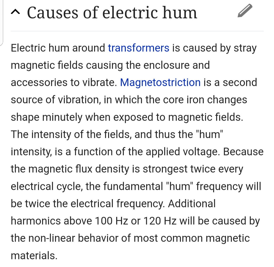

Aptsys, Thank you for the screenshot
100 changes a second is not the point of the argument, what is in disagreement is the term Hz to define the hum
The 50 herts ac will be a sine wave, 100 changes per second will not be a sine wave as there will be other 'noise' components within the hum frequency spectrum
I would love to copy the trace of this off a scope but do not have the drive nor the test components to produce the trace of the hum, nor to argue the toss with certain person who posts and cannot back up with solid information
Once more thank you for taking the time to do the research and posting the results
When you are listening to a sound produced by a magnetic field you get two pulses per cycle when it is the effect of the strength and not the polarity of the field.
Feeding 50 Hz AC into an electromagnet will vibrate a bit of metal close to the electro magnet at 100 vibrations per second. The metal moves towards the electromagnet irrespective of the polarity of the magnet fields pulses.
If the bit of metal is one end of a magnet then it will be vibrated at 50 vibrations a second as it will move towards the electromagnet on one polarity of the magnetic field and move away from the electromagnet on the opposite polarity. ( like poles repel, opposites attract )
Feeding raw DC ( full wave rectified AC without smoothing ) to the electromagnet will create100 magnetic pulse per second and these will all be the same polarity so vibrations will be 100 per second
