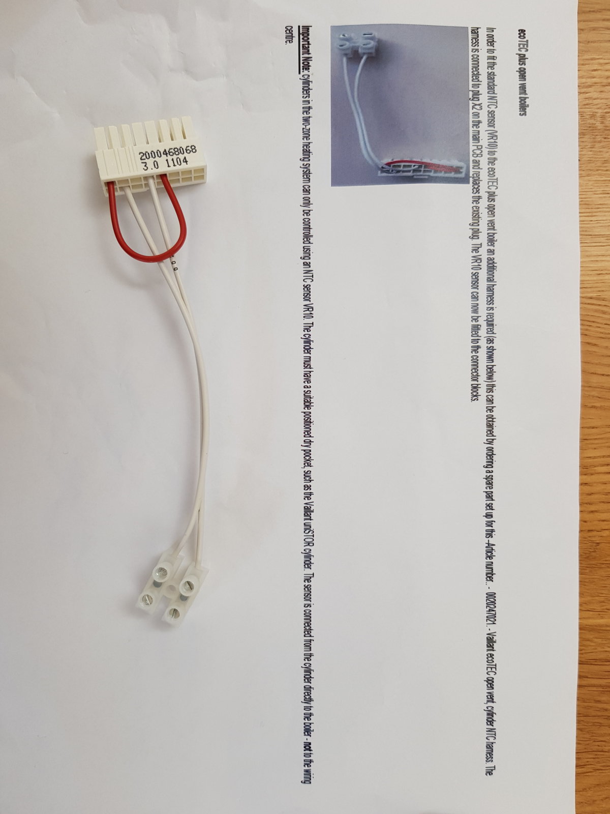

I'm trying to hook up a fairly standard two zone weather compensated Vaillant control system, with ecoTec Plus 438 / VR 430f / VR 61 / VR 81 - just two on/off zones (upstairs and downstairs) with two port valves and a conventional cylinder with a two port valve. Exactly as in VR 61 hydraulic drawing 4.
My problem is there seems to be a disconnect in the Vaillant documentation - not a surprise to members of this forum, I suspect. Where do I connect the tank sensor (SP 1)?
The VR 61 installation instructions say that it connects to the "wiring harness of the heating equipment," which I assume means the boiler. "(see documents which also apply, installation instructions heating equipment)" which I assume is a rather poor translation of "see the boiler installation instructions." They, however, make no mention of where to connect the thing.
I guess I could ask Vaillant, but reports here aren't terribly encouraging and I already have one unanswered email.
Then when I've got that hooked up I can try to work out why the vrDialog won't connect.
Any help gratefully received.
