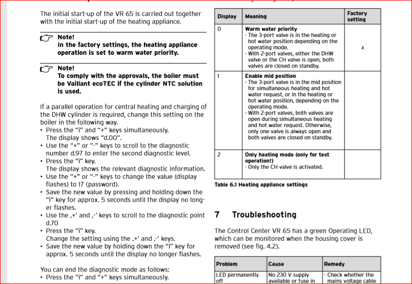

I have a Vaillant 418 on a Y plan. I'll try to explain problem briefly -- I can't get it to do both water and rads at the same time. With the 3 port valve in mid position (d70=1), the boiler only uses the D77 setting of 7KW and so it doesn't have a high enough KW output to do both rads and water. . D77 has to be set to 7kw to limit the heat output for when it is only doing water otherwise it goes to anti cycling mode (S28) all the time.
Why doesn't the boiler use the D0 setting of 18kw when the 3 port valve is in the mid position?.
I have the Vaillant VR65 , with Tado extension kit, and use the eBUS connection from the VR65 to boiler for control signals. The boiler recognizes when it is receiving signals for water and\or heating OK as the radiator\tap symbols come on as the boiler panel as appropriate. I just can't get it to use the heating KW D0 setting of 18kw max when the 3port valve is in the mid position
The only way I can run the system successfully is in water priority mode (D70=0), it's not ideal because you can't have the rads on until the water is heated up.

I've tried both the cyl stat and the VR10 (not both connected at the same time!) . using the cyl stat the valve goes to the mid postion but with the VR10 it never seems to go to the mid position even though D35 on the boiler does change to "40" (centre position) when both heat and water are on.
Can't make sense of it :) .
Yes, I've done all that and set D70 to "1" , but when using the VR10 the valve doesn't go to the mid position, even though the boiler D35 settings shows it as 40 which should be mid position. When using the cyl stat it does go to the mid position. Problem then is the boiler doesn't ramp up the KW and uses the D77 water limiting KW setting of 6KW (or whatever it's set at) and hasn;t enough power to heat both water and rads. If D77 is changed to allow to go to18kw it then can;t heat just the water without going into anti cycling mode. (which is where I started in my first post) .
