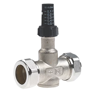

If the boiler has a automatic bypass valve (ABV) check its setting and increase its index setting to 0.5 if not set there.
As a temporary measure you could reduce d.00 to say 15kw to see if the boiler can at least get away without reaching 30C, you can allways gradually increase it depending on the dT.
How do I check and adjust the ABV?
Would lowering the d.00 cause it to run continuously / modulate rather than cut off and go through a full a cycle again and again as it does?
It will look something like this and should be located fairly near the pump outlet . If you locate it just check the reading and post back before you adjust it.

There should really be a ABV on the system which would help.
