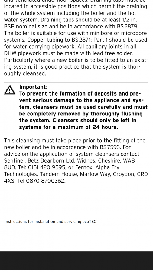

When I checked the manual it says to leave cleaners in the system for maximum of 24 hours. I ran the CH for hours and also ran the DHW for at least an hour. To be fair the system wasn't that dirty and the radiators didn't have cold spots. When I drained it only a few black bits of crap came out. The water actually looked pretty clear.

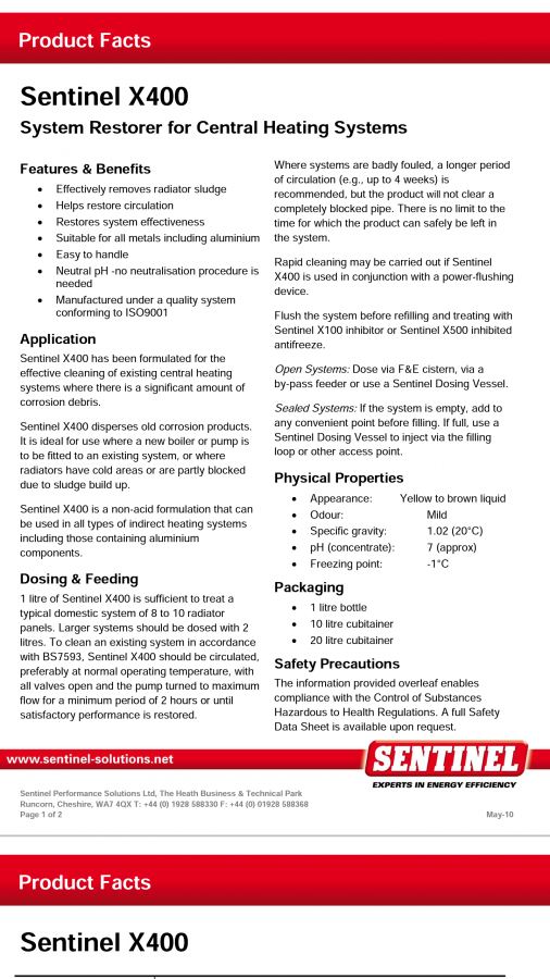

X400 should be left in a system for 4 -6 weeks!
I suspect your X400 has had little effect!
Some cleansers like X800 can be used for a few hours, primarily for power flushing.

So would you advise that I ignore the boiler manufacturers recommendation? If you read the literature for X400 it actually says to circulate it for a minimum of 2 hours or until satisfactory performance is restored. I didn't really have any performance issues.
