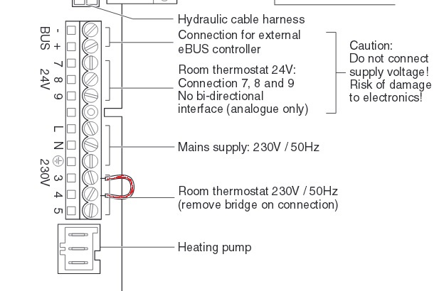

It might be worth asking the next "technician" if the link shown here in red as been removed.
Terminal 4 is an input that controls the boiler's firing up or not when basic hardwired external controls ( thermostats , timers etc ) are used.
Terminal 3 is an output from the control module on the PCB that responds to inputs via the E-bus thermostat and other inputs.
If the E-bus s not being used ( no connection on terminals 7 8 9 ) then the state of output Terminal 3 could be random and therefore should not be connected to Terminal 4
Well that is certainly alternate thinking, Bernard.
Alternate thinking even to Vaillant, who made the bl**dy thing.
