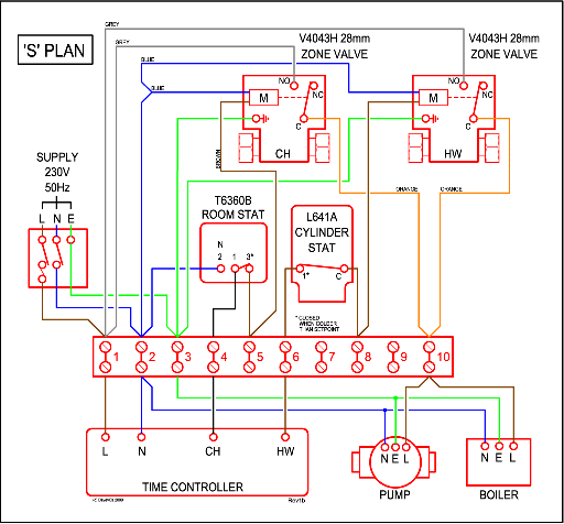

Hi, my heating which uses a Vaillant ecotec plus 418 boiler installed on an open vented central heating system using S plan has stopped working. The problem is the boiler is not firing up. The boiler status shows S30, which means there is no external demand for heat.
I checked the SL to the boiler on Terminal No 4 is live when I call for hot water, or heating via the programmer, and the cylinder and room thermostats are not satisfied. The heating and hot water two port valves open if there is a demand for hot water or heating, and then the pump starts up and terminal 4 of the boiler (SL) becomes live indicating the 2 port valves are working correctly. However the boiler does not start, and always indicates S30, no demand for heat. I have reset the boiler and powered the system off and on but with no effect. I checked the pump is powered and motor is spinning when there is a demand for heat/hot water.
I'm baffled, any ideas anyone ?

I think terminals 3&4 are linked out and should read 230V to N with switched live
The link should have been removed on installation when a remote switched live connection was provided.
3 is just a mains connection to enable a room stat to be connected between 3 and 4 if very simple controls are being used. Or just linked if no external connections are to be used. But that is not very sensible as it prevents the boiler from providing a pump over run or frost protection.
3 is just a mains connection to enable a room stat to be connected between 3 and 4 if very simple controls are being. Or just linked if no external connections are to be used. But that is not very sensible as it prevents the boiler from providing a pump over run or frost protection.
Link 3-4 is not fitted. As your reply installation instructions say it is removed when using external controls.
As you noted, the pump is not connected to the provided pump connector on the boiler, but is connected to the same circuit as boiler SL. I'm not sure why that was done by whoever installed it. I suspect it was left over from the previous boiler installation.

Well you really should get the pump connected back to the boiler.
And the boiler needs to be connected to a permanent live.
Your system have no pump over run at all and that will cause thermal shock to the heat exchanger immediately the boiler turns off. And it will prevent the frost protection from operating and also the daily one minute pump exercise run.
And it probably would invalidate the warranty if any warranty repair engineer noticed it. Manufacturers often try to find reasons not to do warranty repairs when there is a serious installation error.
