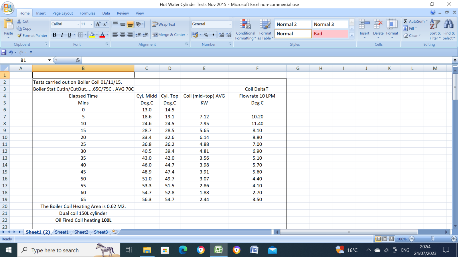

A Ecotec 418 IMO would be doing very well not to cycle with a standard coil based on my tests carried out on a new 150L twin coil cylinder with the oil fired coil heating the upper 100L.
Tests carried out with a stone cold cylinder and 20kw Firebird oil fired boiler with a average flow temp of 70C.
Don't know what the min output of a 418 is but assuming say 4kw then based on my tests it could (with this cylinder) and with the same circ flowrate of 10LPM, start cycling with a cylinder temperature as low as ~ 48C.
