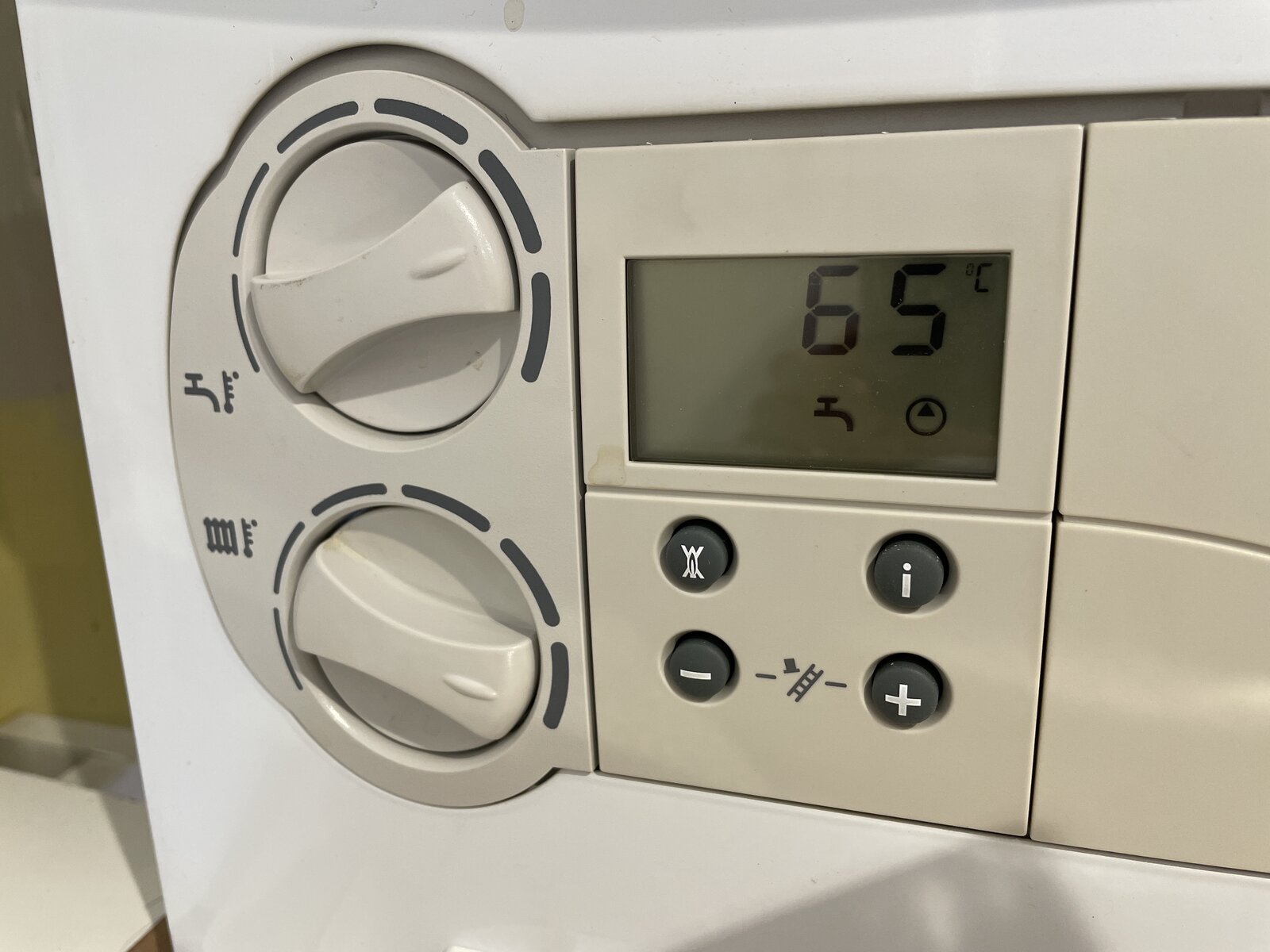

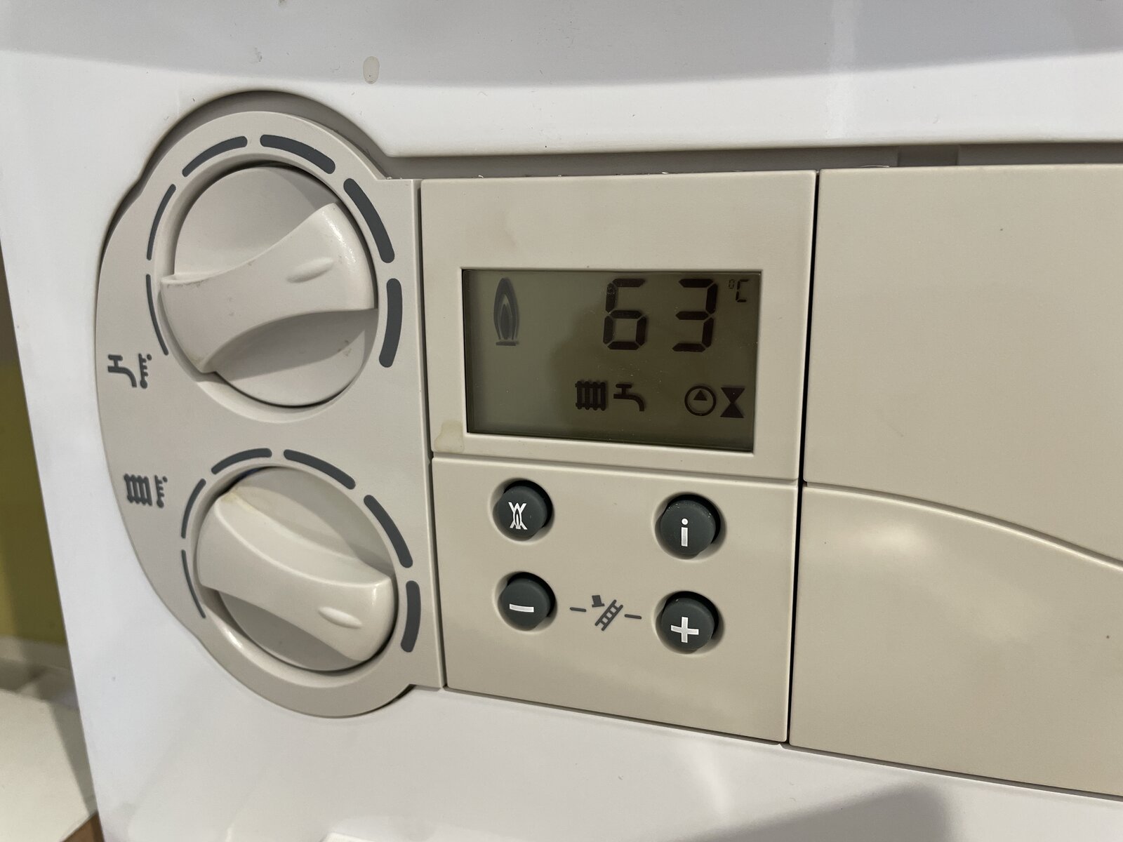

Hi All,
Looking for some advice please! Not sure if this could be a DIY Home fix or if I need to call an engineer.
I have a Vaillant Ecotec Plus 418, which appears fine on the hot water side and is able to maintain temperature however when I call for heating, initially it seems to go for a while and then cuts out. The rads are warm at best, an the heating symbol is flashing. It will fire for a minute if that, and then cycle again. This appears to be constant at the moment and its bloody freezing!
Any advice on what to do would be great..
Photos to follow.
Cheers! :)
Photos:
1 - normal operation
2 - flame cut out and flashing radiator

the pump is certainly quite noisy and has been for a while, though it has been working okay
