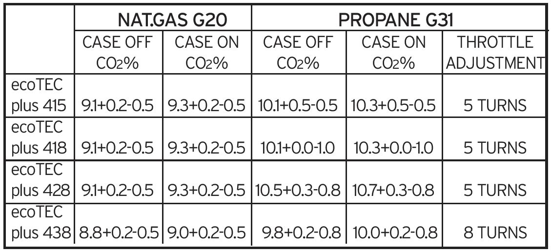

Also if you look at the boiler manual the CO2% figures are all quoted for maximum burner. There are no figures for when on min burner, which is my issue. Even the RGI who came out last year had to phone Vaillant to ask them who just told him to set it to 8% on minimum. For the maximum setting he just set it between the values for both a 428 and a 438 because either way it was within the tolerance levels for both. But he did this only because he didn't know if he should treat a 438 boiler set at 28Kw as still a 438 or a 428.

8% CO2 would be fuel lean which is the reason the burner is baffling.
Both P.1 and P.2 should be set to around 9% CO2 (9.5% with front case fitted).

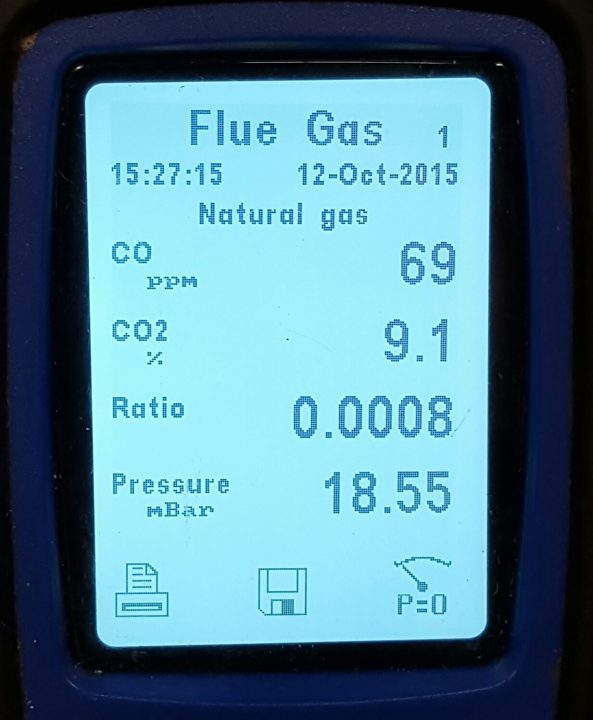

When Vaillant did the last service they left with the following readings, which was done using the P1 programme. No service prior to the one done in 2016 was ever done using the P2 programme.
But even with this the droning noise didn't go away.
Last year 2016, the guy who did the service was on speaker phone the entire time to Vaillant, so I heard everything and they told him to adjust the boiler to 8% on the P2 programme.
He adjusted both throttle and offset and brought the figures to 8% on P2 and 8.8% on P1. That stopped the droning noise and the boiler worked fine from Apr last year to Feb 2017. This Feb the droning noise has returned. Now obviously the boiler is due it's next service soon.
CO2% measured over the years 2013 - 8.8%, 2014 - 8.6%, 2015 - 9.1%.
The first time any adjustments to the throttle and offset were made was 2016 and the readings were as mentioned 8.8% - P1 and 8% - P2.
The chart from the actual manual is shown below, which is why I am after a second opinion.
