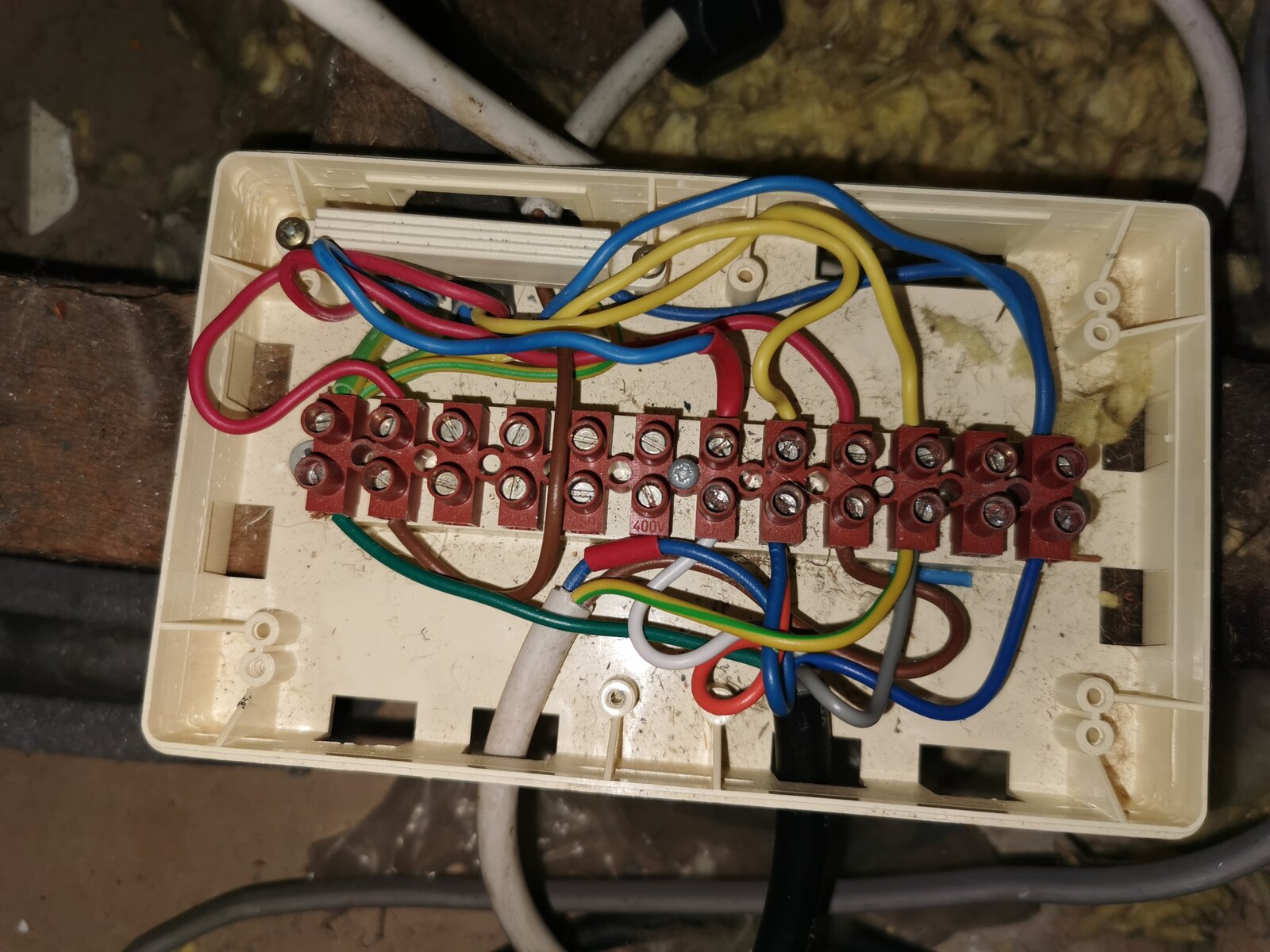

Show us pics of wiring at the wiring centres terminals.
At the grey and orange wire terminals at the valve (for the cylinder stat) was getting 170v rather than 240v. This was when the water was off.
The green cable from the valve to the white cable was getting 240v when heating was on.
Heating was set to permanent on.
Siemens RWB9 programmer and salus rt310 stat.

With programmer set for central heating only to be on ( domestic hot water off),and the central heating thermostat set to maximum ( calling for heat) ,measure the voltage between the terminal that contains the orange wire ,and the earth terminal( far left hand terminal) You should get 230/240 volts. Do you ?
Do you mean the earth and the red wire (above the brown)? The brown is for pump.
I did get 240v at the brown and one of the neutrals.
It has started working again with the new head installed. I may have put one of the wires inside a terminal too much and the sheeting got screwed in rather than the copper.

The orange wire from the motorised valve ( in the 5th terminal, from the right hand side) Is what sends voltage to the boiler via that terminal. So ,when only c/ heating is called for That orange wire should have 230/240 volts ,measuring between it and earth.
