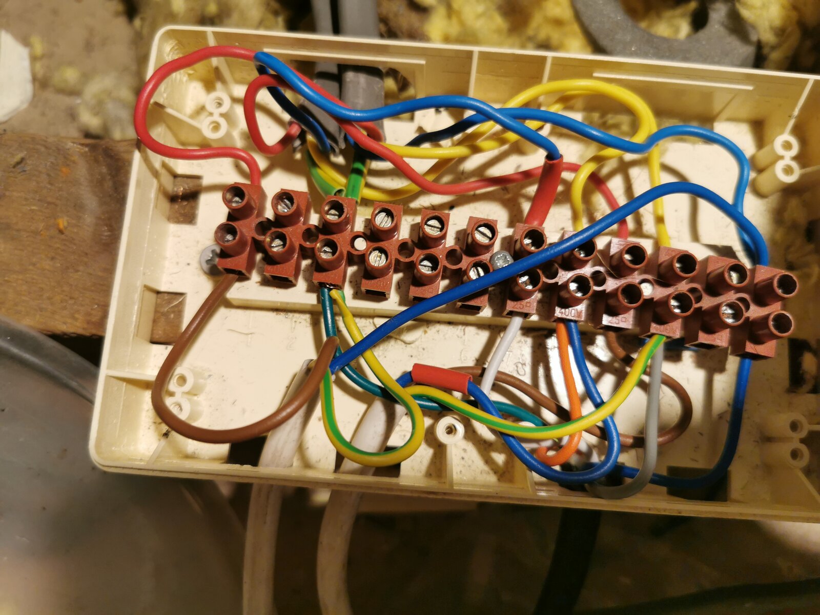

Then wait until your heating fails, and go down each of the terminals of the box, writing down what voltages you see. Post that here, with a good photo of the box and connections, so the experts here can interpret what the issue is.
Problem with the block connectors is you can't test an individual wire you do it by the screws and there's multiple wires sometimes in one connection.
You don't need to disturb any of those connections, just touch the tip of the probe, against the screws, and report what you find, as above.

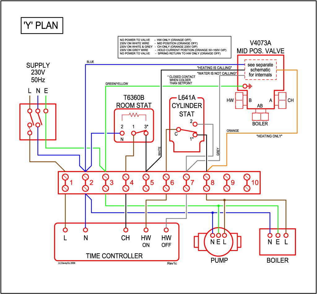

Basic Y plan, below, as suggested,some simple tests can then be carried out.
Guys, there is a delay in the pump and boiler starting. Turned the hot water on and pump and boiler kicked in 30 mins later despite the cylinder stat calling for heat.
This delay has been happening this week whenever heating or hot water is turned on. Sometimes it works straight away.
When heating is turned on there is 240v at the green wire when tested with the orange wire.
The grey wire always has 240v even when nothing is turned on at the programmer.
The valve clicks as it should when heating or hot water is turned on.

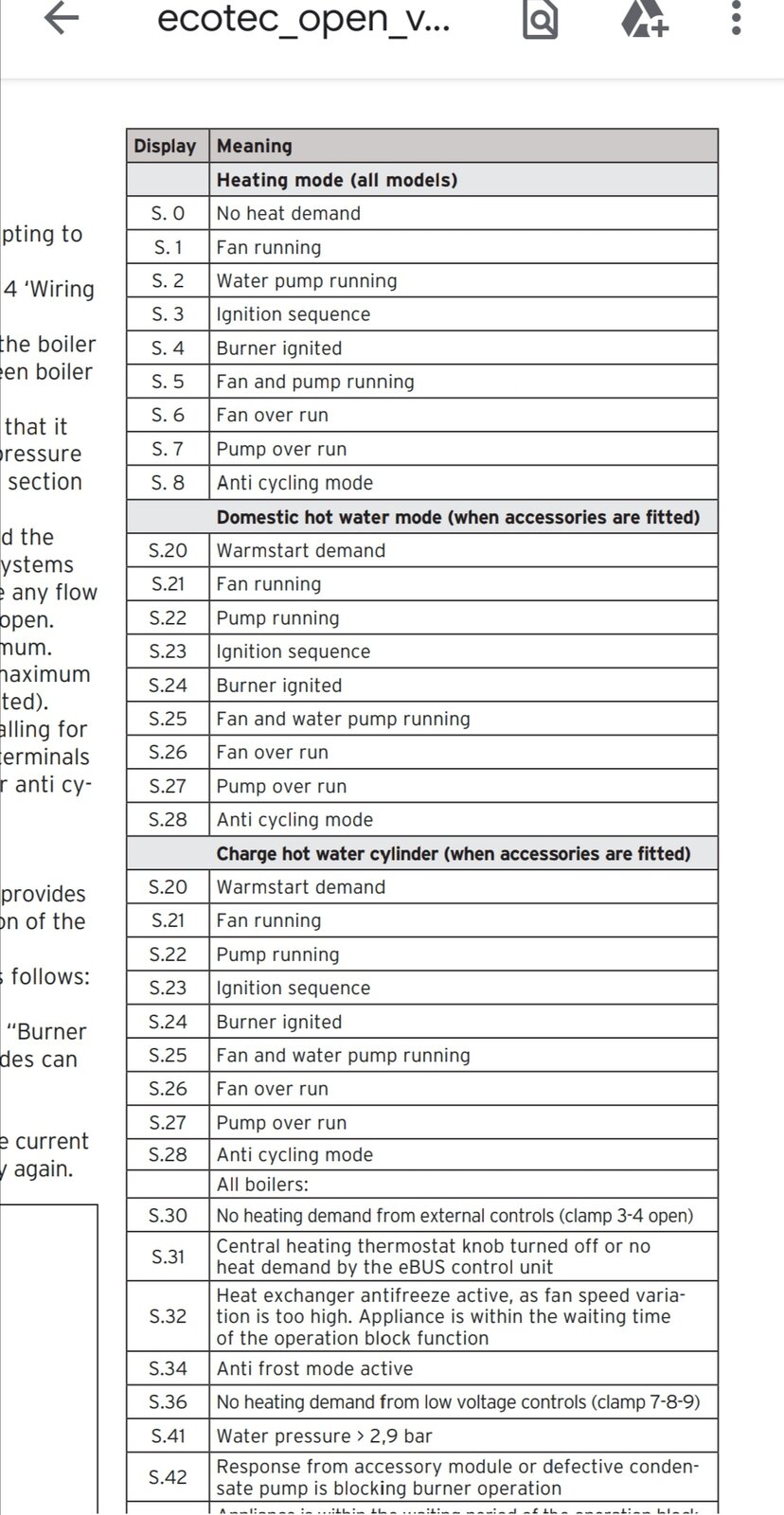

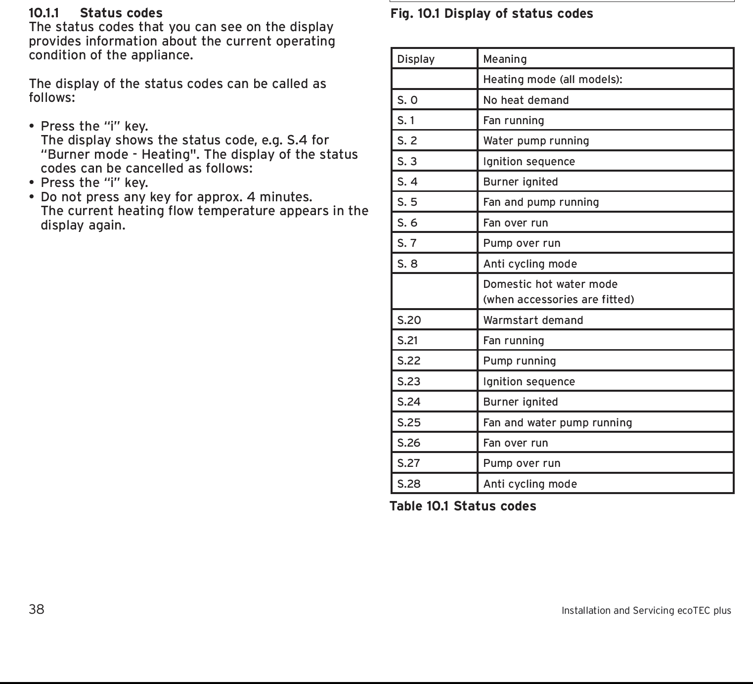

The next time you get that delay, check the s parameters, if S.0 is displayed then there is "no heat demand" and we can take it from there.

Hi I only got a s.30 code. This code is present for heating or hot water
The boiler will (should) have a permanent Live, a switched live, a neutral, and probably a earth.
When you switch the boiler power on then even with neither HW or CH requested at the programmer you should get power at the boiler and 230V between the PL (permanent live) and N (neutral), check this first at the boiler.
The SL (switched live) gets its signal (to start the boiler) either directly from the programmer or from the orange wire from the 3 port valve if CH only is required, the boiler PCB also controls the circulation pump.
Request HW only on, ensure cylinderstat calling for heat and test between SL and N, if no 230V...
Request CH only ON, ensure roomstat calling for heat and again test between SL and N.

All of the wiring, goes to your strip of terminals in that box, in your airing cupboard, which is why you were asked to check them there..
