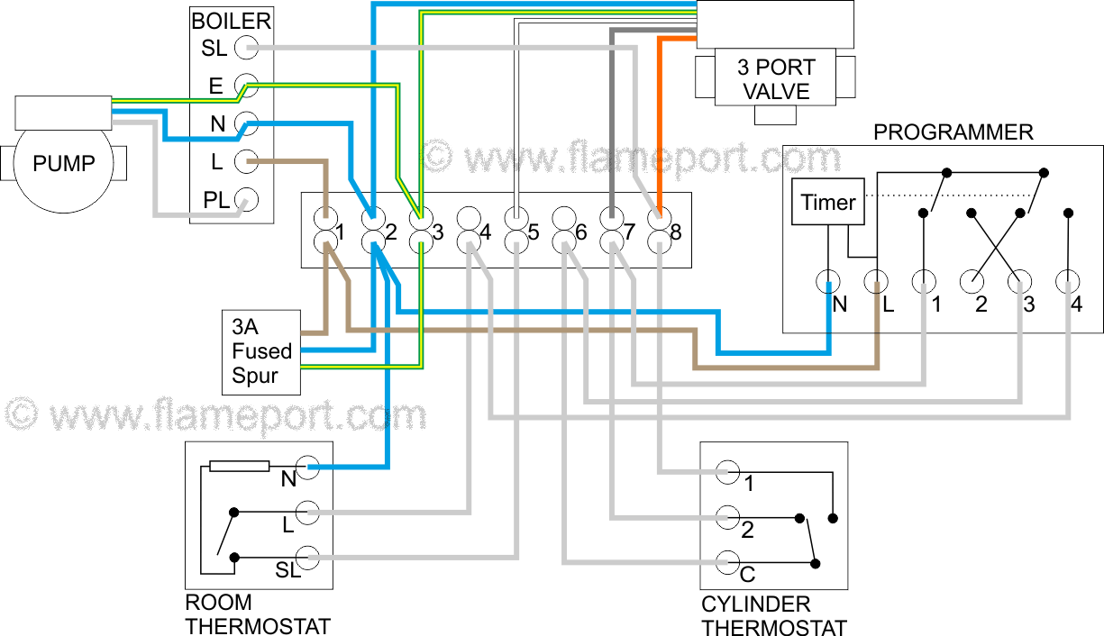

I have been advised it's due to condensation in the loft. And today the loft had 55-60% relative humidity but had not heating or hw. The garage had 60-70% where the boiler is located.
I've bagged up the wiring in the loft and put a plastic tub over it too to prevent any moisture entering the wiring few months ago but that hasn't sorted it. Had no issues in the summer it's only from Oct to April this issue happens.
Got 2 extractors that are vented in the loft void and will be having these vented through roof tiles soon and will have soffit vents put in. I've put in lap vents in the roof membrane for now but that's not helped much I guess. I did redirect the two extractor fans towards the soffit where there is a 6 inch hole from an old soil pipe that used to go through the roof.

Those humidity levels, if accurate measurements, are quite normal. Your heating, working or not, should not normally affect the humidity level in the loft, unless you have heating in the loft. Likewise, the garage.
The way to diagnose your problem, is as true now, as it was at the beginning of this thread....
By checking the voltages at the wiring centre, and reporting back - but you need to first check your wiring centre has been setup to the default termination layout, numbered 1 to 8, left to right, like the below diagram.

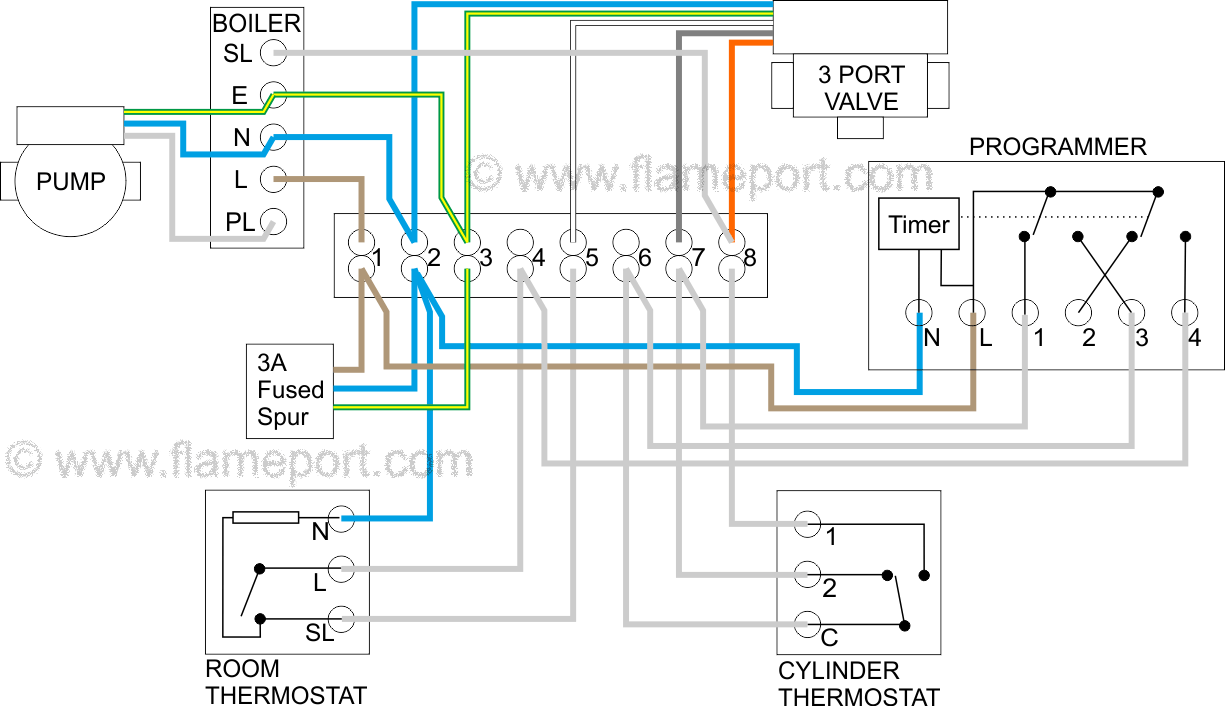

Wiring is all fine. As stated the issue is in the colder months not the warmer months. Both hw and ch work fine from April to end of sept. Come on straight away etc. As stated much earlier one of the live wires in the loft became oxidised due to condensation but the wiring is covered up now. The only wiring that is old and hasn't been changed is the cylinder stat one or the cylinder stat becomes condensed easily?
What does 'becomes condensed easily' mean?
As a;ready pointed out, the way to diagnose it, is by checking the voltages at the wiring centre, when the system is faulty. The voltages at the wiring centre, give all the information needed, to indicate where the issue is. Measure between the N terminal 2, and all the other terminals, make a note of them, and report back the measurement of each.
I've already done that.
As stated the issue happens in colder months. There isn't a fault with the system, pump, valve or boiler.
What I meant the loft gets condensation in the colder months and one of the wires becomes oxidised due to the condensation.

OK, then posting the result of your checks, when the problem is apparent, would make it easy to diagnose. Why not do that?
What connections, or parts of your heating system do you have in the loft, which might be affected by condensation, or oxidation? Normally, the only part of a heating system, which is in the loft, are the tanks, in the case of an open vented system, or they sometimes fit the boiler up there, in the case of a combi boiler.
The problem only appearing during the colder months, rather suggests, it is a problem with the central heating part of the circuit..

Potentially, yes, but it would usually be evident year round, when ever there was central heating demand. Just to repeat - all becomes much clearer, if you simply post the results of tests, at the wiring centre terminals, when the issue is happening. Until that is done, the members of the forum, and you, will simply go round in circles.
Oxidation of wires, terminals, and contacts, in my experience, is usually the results of them being run at too high a current, rather than due to moisture, and/or contacts simply breaking up, due to mechanical wear and tear.
