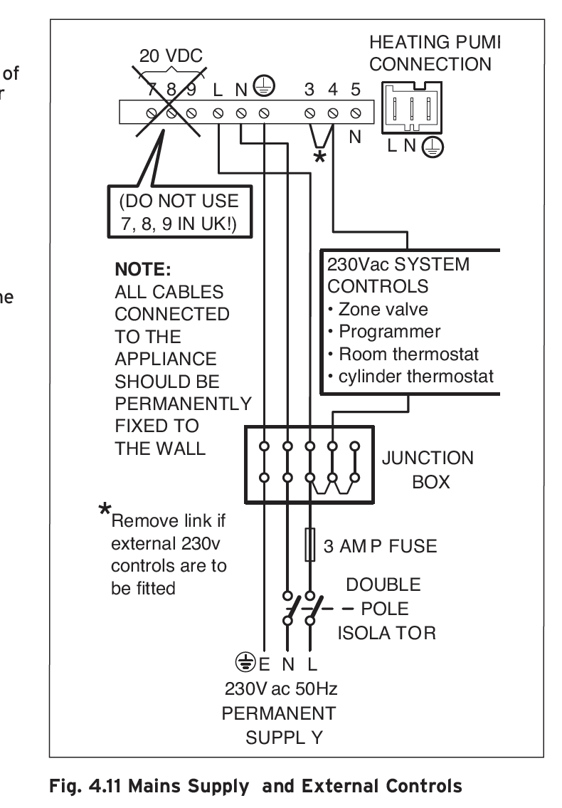

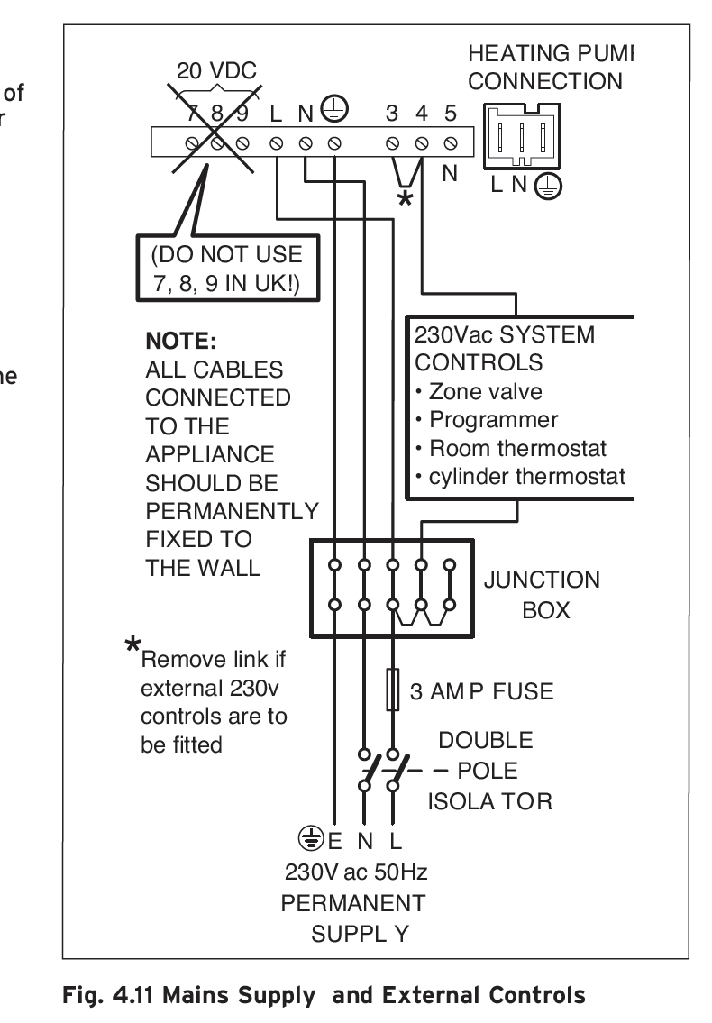

I know it may be causing no problems and (if) doesn't seem to be required but can you just disconnect the brown wire at terminal 3 on the PCB.
I can't see any reason for it based on this schematic, the * is just saying no link.

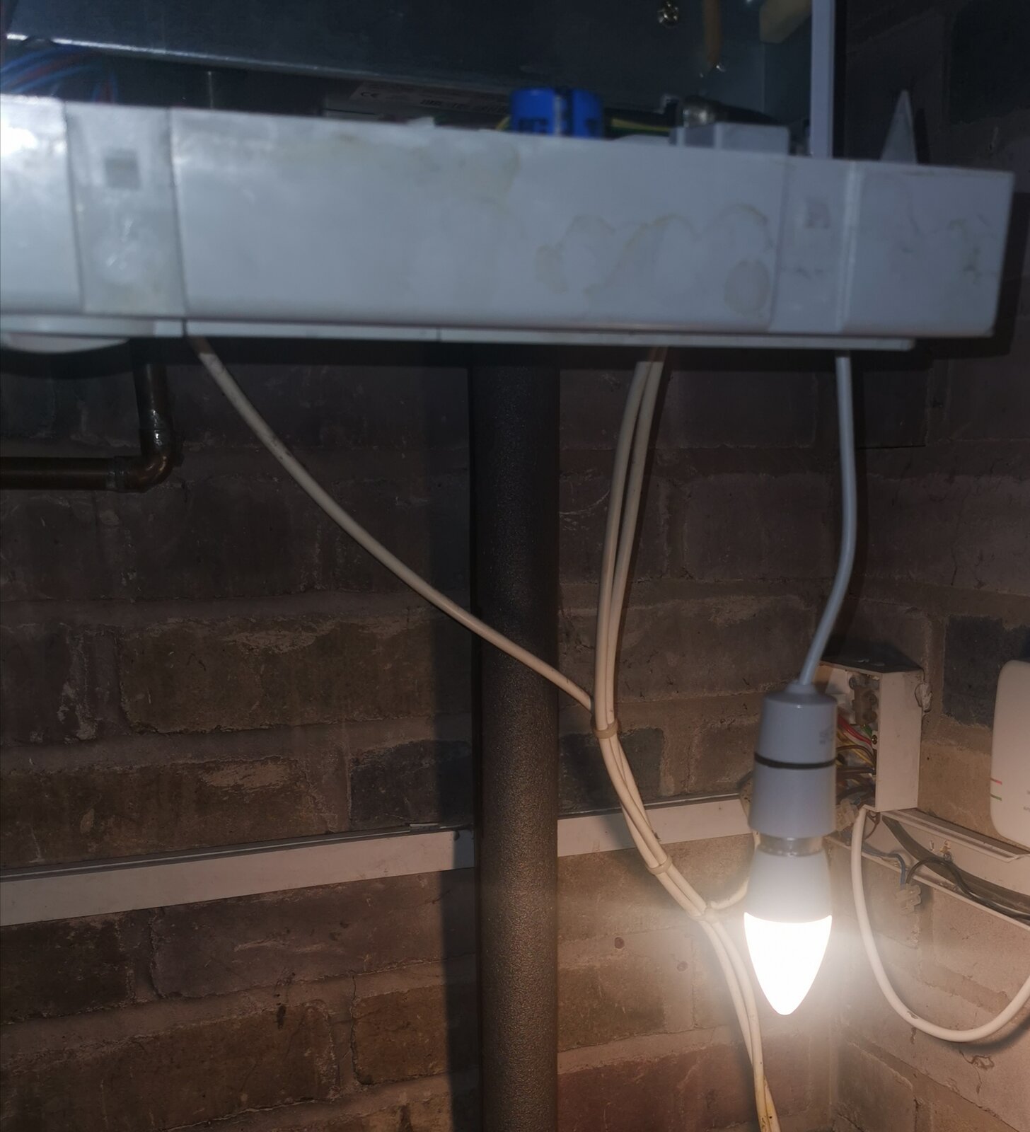

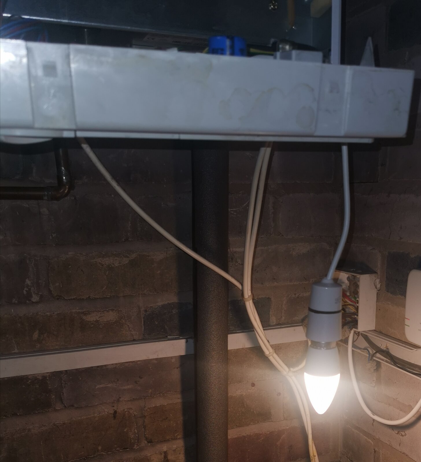

The bulb is lit, the switch live isn't coming on in the boiler, the one on the green terminal.
John I removed brown wire from terminal 3 and then the stat and programmer had no power. It's there to provide power to them. I appreciate the schematics say otherwise, but it has been like this for 15 years.
Are you now (still) getting 230V even with the lamp "on". This (CH only) is the only time that the SL (ter 4) is supplied via the 3 port valve so just wondering if the voltage is too low.
So for hot water it isn't supplied? And sl would be 0v?
I was getting it before with CH only it was off, then it came on as did the boiler
No, there must all ways be 230V to the SL when the boiler is required to fire.
On HW only the valve is doing nothing, its spring loaded to the HW position only, port B, and the 230V comes from (we now know) a PL, ter.3 to the programmer and back to ter.4 the SL, via the cylinderstat, if the stat is satisfied then 0V to the SL and the valve stays where it is. When CH only is requested the valve moves fully the other way, via the cylinder stat ter.2, if not calling and a grey? wire or with HW OFF if the HW is timed off until port A only is opened, it is only in this position that the 3 port valve then supplies the 230V via the orange wire. So, if it only appears that the boiler is tripping regularly only while calling for CH only, to check this, that you atually have 230V even with a lit lamp. If the voltage is 230V then looks like a boiler fault even though strange if its only happening in the CH only mode.
The fault happens in both HW and CH, together or independently
