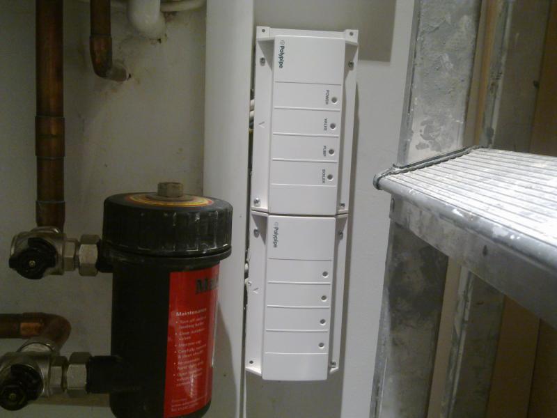

Geof, is a manual adjustment available to fit where the electric actuators can be fitted?

- Do i still need to get the 2 missing actuator heads for the manifold? or look into a manual adjustment as agile has suggested?
- Do do I still need a lockshield valve to reduce the flow to the UFH circuit?
- I will check my magnaclean isn't blocked up in anycase.

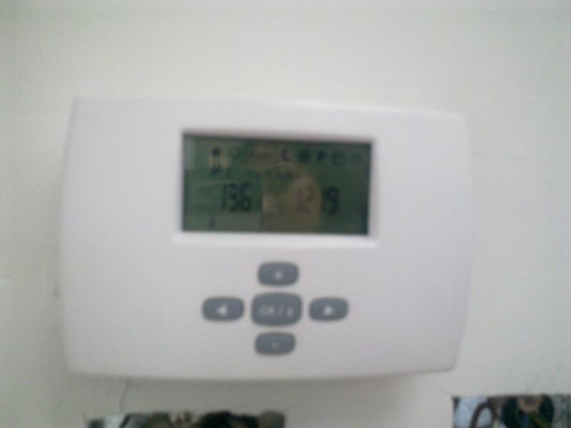

i wouldn't have thought a balancing valve is necessary, I'm curious to know what the thermostat you mentioned is controlling.
the actuators should be fitted, but they need to be connected to a relevant thermostat for whichever room they control.
I think there are 2 circuits coming off the manifold, but its 1 'zone', so i have 1 control unit that controls all - 1 setting for all - basically, ufh is in my newly built extension.
