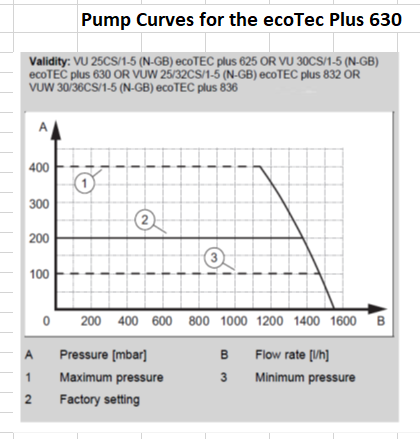

Can someone explain or throw some light on the above, this boiler's hydraulic settings can be set to several modes, constant speed, dp constant pressure (between 100mbar & 400mbar) and dT Temperature Spread (between 10C & 20C). This boiler is having problems in running in either dP or dT modes so is running in constant speed mode until problems resolved.

THe EcoTec 630 does not give this very useful info, nor do they give the boiler's installed pump head, it does give a "Pump Curve" (see attached) which shows flow rates of 25.8LPM @ 100mbar head, 23.0LPM @ 200mbar and 19.0LPM @ 400mbar which makes no sense to me as the flowrate is apparently decreasing with increased pump head, hence the query. The boiler comes in a default dP mode set to 200mbar.
The D parameters show flowrates of 11.65LPM @ 50% pump speed, 20.6LPM @ 80% and 25.47LPM @ 100%.

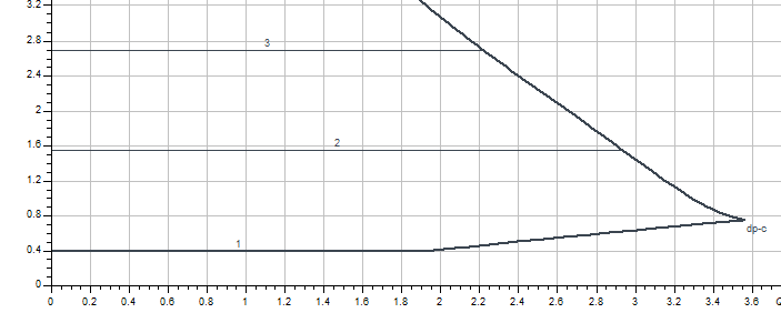

How is that any different to constant pressure mode on the Wilo shown in the first chart below? I think it just means that the maximum flow the Vaillant boiler can produce at a constant 400mbar is 19.0LPM, and the maximum it can produce at a constant 100mbar is 25.8LPM.

The Wilo will flow 19.0LPM at 4M (400mbar) and will flow ~ 55LPM at 1M (100mbar), the HEX has a head loss of 2.6M @ 21.5LPM, if you tried to force 55LPM through it then the head loss is ~ 17M, if the Vaillant pump curve is just that (a pump curve) and assuming its ~ a 6M pump like the Wilo then, while it does show 19.0LPM @ 4M it should show ~ 50LPM @ 1M??.
Also when tested on a 100mbar dP setting it showed something like 12.5LPM at 49% pump speed, close enough to the 11.66LPM @ 50% showing in fixed speed, this, again assuming a 6M pump means its running at a head of ~ 4.2M with HEX dP of ~ 0.76M which still leaves around 3.4M residual head.

I think the Vaillant graph actually is a residual head graph. But for some reason they haven't called it that. It shows how much pump head the boiler can produce after it has forced the water through the heat exchanger.

Yes indeed, with probably a ~ 6.5/7M pump and assuming the 630 Hex head loss is the same as the 430 but what's completely misleading is stating that 200mbar is the factory setting on dP mode which I interpret that the pump runs with a fixed constant pressure of 2.0M, you won't circulate a lot of water at that head.

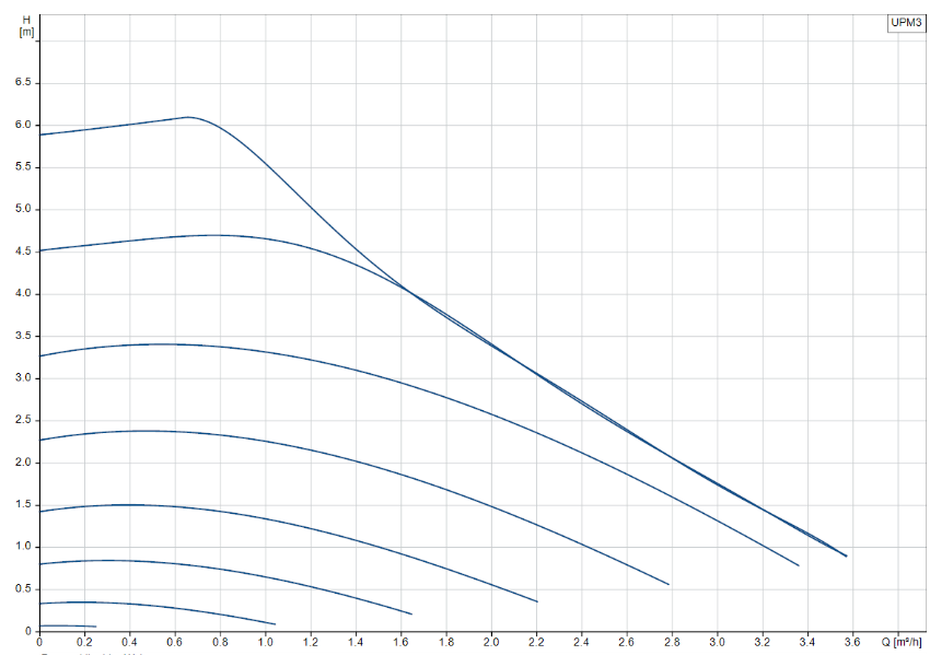

The pump is probably something like this. Most system and combi boilers use UPM3, I believe. If you subtract the heat exchanger loss from the top curve, then you might get something close to the curve published in the manual.
We are too posh, Remaining Head would have thrown up more, see attached where they provided the proper charts in 2021. However it seems that 250mbar, 2.5M is the remaining/residual head used throughout the range.
Anyone reading this who is thinking of installing a heat only boiler like the Vaillant 430 or any heat only Boiler, should, IMO, give good consideration to installing a Grundfos UPS3 as it is really a giant of a "6M" (6.4M) pump and will circulate even more than most or quite a lot of 8M pumps which cost probably twice as much, it is a 60W pump vs 45W for most 6M pumps and has unusual CC curves which are in fact constant head CP curves, see attachment.
It will give a residual head of 3.4M at 21.5LPM (30kw boiler rated flow @ 20C dT) vs 1.95M for the Wilo, 3.4M should be sufficient for most heatig systems whereas 1.95M almost certainly will not, so no need really for a LLH. (sometimes referred to as Dead Loss Header)
