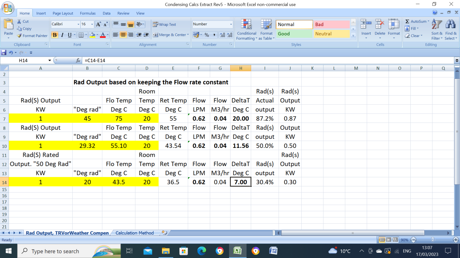

Here's what you can achieve just by reducing the boiler flowtemperature, the dT decreases but the return temperature reduces to give very high boiler efficiencies, remember condensing only begins at a return temp of 55C.

These calculations are based on a dT of 20C and a assu.ption that you require a high rad output on occasions, ,(87% of max), and based on that the rads will perform or should exactly as I've show by reducing the flowtemp, having the bypass closed gives the best results but it should open or a external ABV should open on pump overrun.
As shown above the dT reduces "automatically" due to the nature of hear transfer in the rad.
If you want to give me your actual flow/return temps then I can re do the above calcs if you wish

If you have set up the system to give a dT of 20C, then for any given change in flowtemperature, ie OT compensation, then the flowrate MUST change to achieve that 20C dT, your TRVs certainly won't do that, they control based on the room temperature only and some like yours will try and maintain a minmum flow through the rad based on the dP across the TRV, auto speed control will also help to achieve a set dT but except the boiler logic can control the flowrate by using the dT to do so then its a pretty tall order to achive this.
Example again based on the radiator heat "laws"
If the rad has been set up as following, flowtemp 75C flowrate 0.62LPM/kw then the returntemp will be 55C, dT 20C. output (87.2% of a T50 rad)
If the flowrate remains the same and if the OT curve determines that the flowtemp required is 43.5C then he return temp will be 36.5C, dT 7C. output (30.4% of a T50 rad). If a dT of 20C is required to give the same output (30.4%) then a flowtemp of 50C will give this (returntemp 30C) BUT the flowrate must be reduced to 0.22LPM, so not a easy task and if the minimum allowable flowrate is set too high on your TRVs then the dT will just keep decreasing with decreasing rad heat demand.
