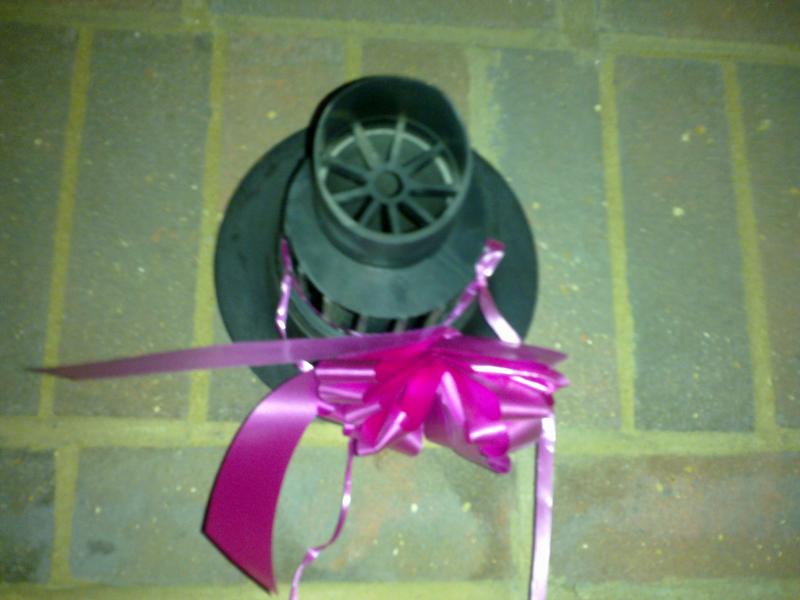

If you have correctly mortared the flue to the wall then I dont see why you then fit the rubber gasket. When I see that it makes me thing that its a cowboy installation that has not been mortared!
I always use the rubber shroud when supplied by manu , does this mean my making good is crap? , i would imagine you say these things to deliberately get up members noses ............. the shroud makes for a neat job.............i notice you NEVER post back on a thread when you're questioned or made to look a fool (often) ..............irritating person you are,,,,,,,,,,,,,
I am sorry that you think that way!
If the flue has been correctly sealed with mortar, as it should be, then the rubber gasket has no use!
My view is that its simpler and neater and less obtrusive to leave it like that.
As you apparently think its better to fit it when it serves no purpose then why do you think it looks better?
Perhaps a nice pink ribbon bow would look even better?
I suggest you 'find out' the reason why these are supplied & fitted.........& when you educate yourself on the reason why these are used my guess is you won't reply back. :P
u sound like guy who is smart and clever an knows much about rubber gaskets driling srewing analysing what an interesting person you are.
making comments on a fellow engineers job saying sounds like a cowboy install thats not nice is it,I am glad most of the comments from other guys has been helpful and made in good spirit.
what a shame
If the Vaillant instructions stated that a pink bow is required, we would fit one.
As it is, the instructions ask for the rubber finisher and for the flue sections to be self tapped together. So that is how we do it.
I am glad the OP has got his ecoTEC quieter, I am pleased I was on the right track :D
Manufactures would'nt supply these weather collars if it was'nt necessary............some manufactures are happy for the flue terminal not to be made good (external) so supply these to enable the installer to push horizontal flue pipe through the wall & pull back against the collar , the other reason for supplying these is to stop any water (rain) running back onto wall surface due to the fact these condensing flues are installed with a slight gradient , not a big deal but if it's supplied why not fit it?
I fit Baxi solo's, they come with a nice brown metal ring, if the hole is neat I use brown mastic to seal the pipe to the brickwork, then fit the ring and mastic that in place as well, gives a nice looking secure finish and weather proof, if flue comes with a rubber seal I cement in place and fit rubber seal to give neat finish, some cowboys cant be arsed and throw them away. :roll:
