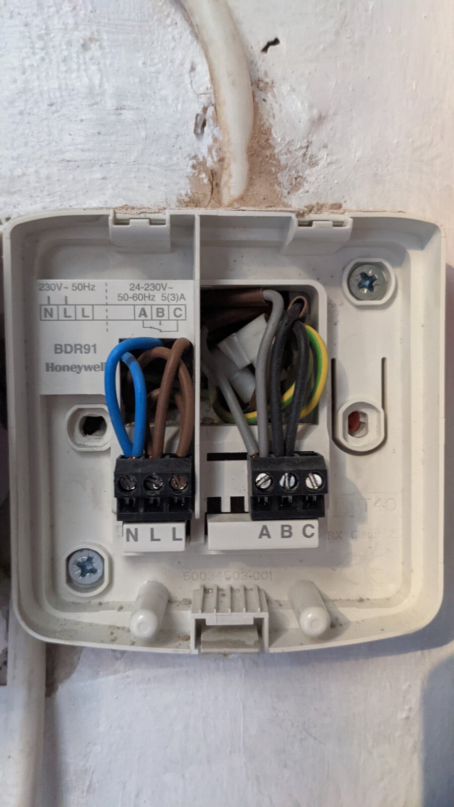

I'm trying to figure out whether I need to call a professional to install a Nest Thermostat E:
I currently have a Vaillant Ecotec Plus, with a BDR91 relay that talks to a (wireless) Honeywell CM921.
The Honeywell is starting to fail (the down button is randomly triggering which means I can't turn on the heating :eek:). I could just replace it but would like to try and get something a bit smarter.
Looking at the Nest Thermostat E installation instructions, they seem to imply installation is very simple. My main worry is this won't be the case when I get to the wiring inside the relay.
I managed to get the cover off the BDR91 and take a picture (see attachment). Does anyone know if this wiring arrangement would be compatible with a Nest E?
Thanks in advance :D
It will take a Nest E, but thermostat would need to go in place of BDR91, and depending on how it’s fed, may need to alter the Live and Neutral. You could get a different wireless thermostat brand, a Nest learning thermostat (but the thermostat itself would need to be used via the usb lead), Hive would also work.
