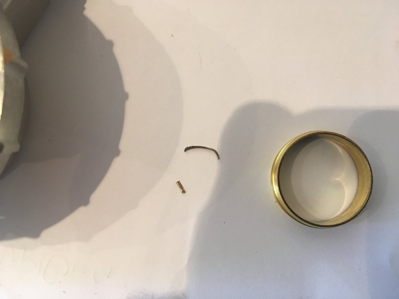

Well, I fitted one today. Nice looking solid lump of metal. Looks very good but...........and this is typical of my luck, I had a little look inside before fitting it and I found what I considered to be a bloody big bit of swarf on the outlet. Might have caused me a problem if it had got to the pump. Anyway, I removed that, fitted it in less than 15 minutes (next to boiler in loft so not much water to drain out) and I'm running the heating now just to see if it picks up anything immediately. Sweating me nuts off with the heating on and all rads on max on a day like today!

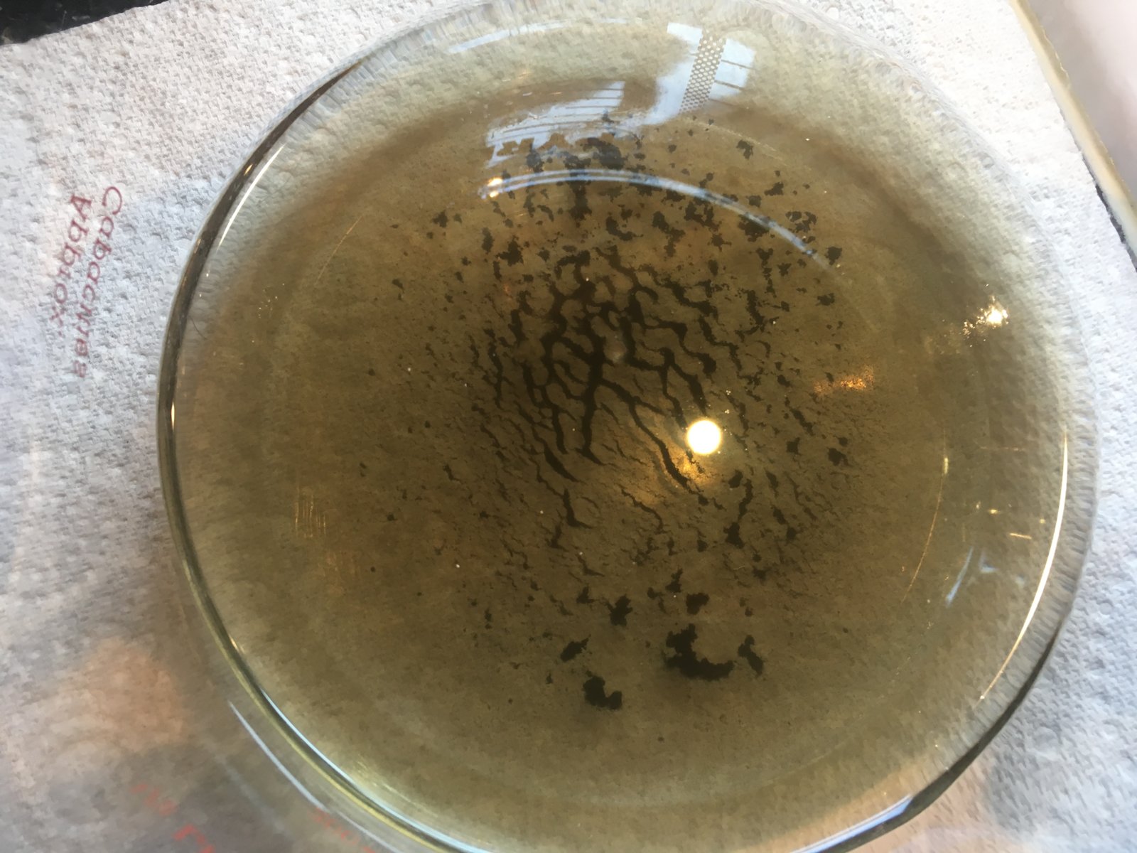

Not too terrible I suppose for 15 mins running.
Wow, collects way better than my Spirotech Spirotrap MB3 because MB3's magnet is on the outside of the filter brass body.

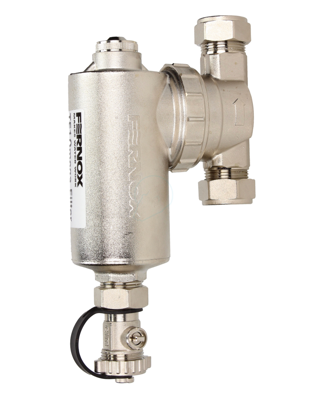

The only criticism I heard on this website about the Fernox Omega TF1 brass filters are the valves that come with it are not full bore. So the flow rate becomes restricted through the filter so it takes longer to heat the radiators and makes the system inefficient. Is that criticism total rubbish? And even if the valves are a problem, couldn't we just replace them with full bore ones anyway? And how good is it removing non-magnetic debris as it doesn't have a mesh gauze - and does that matter when I suppose non-magnetic debris is not that important compared to the more abundant magnetite anyway?
I bought the kit without the valves and just fitted it to the 22mm return pipe next to the boiler so there’s no restriction on flow as far as I can see. Maybe I’m missing something but wouldn’t you only want valves either side of it if you were removing the whole filter and didn’t want to drain down the system every time?
