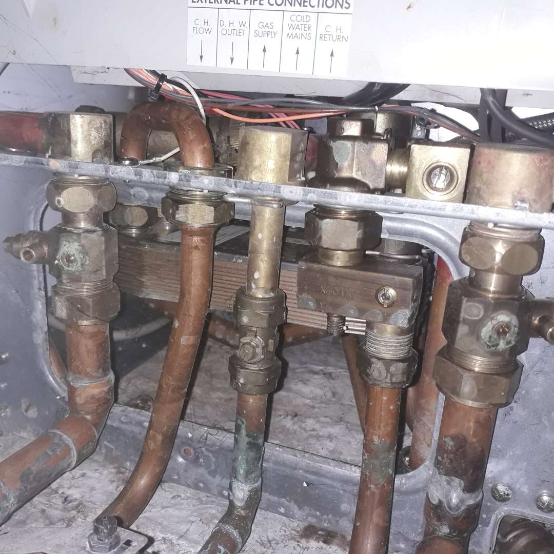

Post a pic of the pipes below the boiler and we will tell you how to top it up and then when at the correct pressure we can see just how much expansion you are having
Am I right in thinking it's the one that looks like a screwdriver would turn?

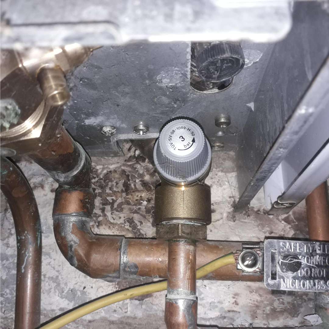

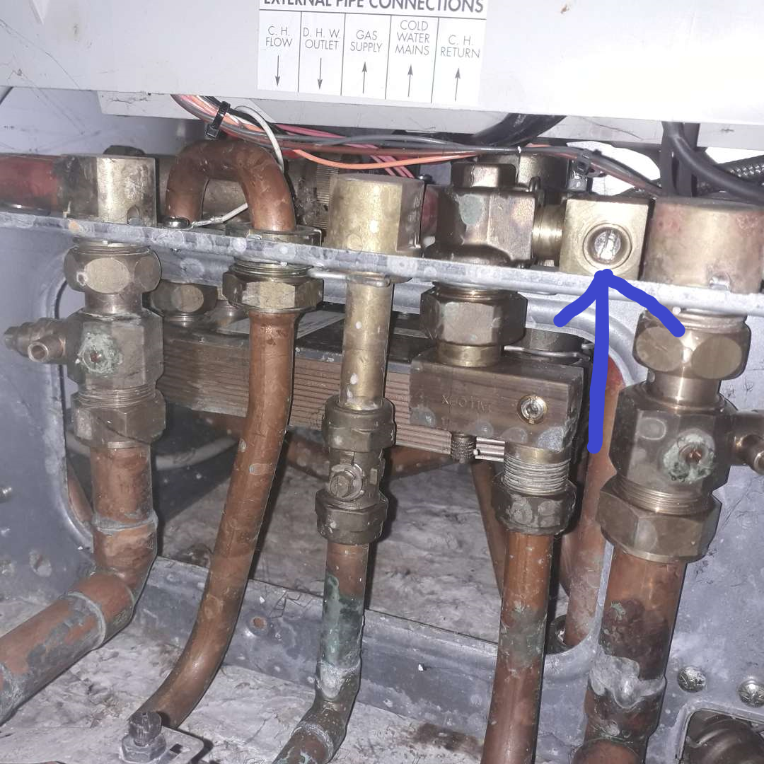

This one turn 1/4 turn till pressure is between 1 and 1.5 Bar then 1/4 turn back to close, do not touch the other valve in your 2nd pic
Thanks. I've done that (filled it to just above 1bar) and am switching the heating on. Will edit this post with what the pressure gets up to.
Pressure seems to have stopped at 1.7bar.
It's started heating up again, and now the pressure is above 2bar, which is just out of the green range (into white). Only 3bar is marked as red.
It's now 2.4bar, and it's stopped heating up again.

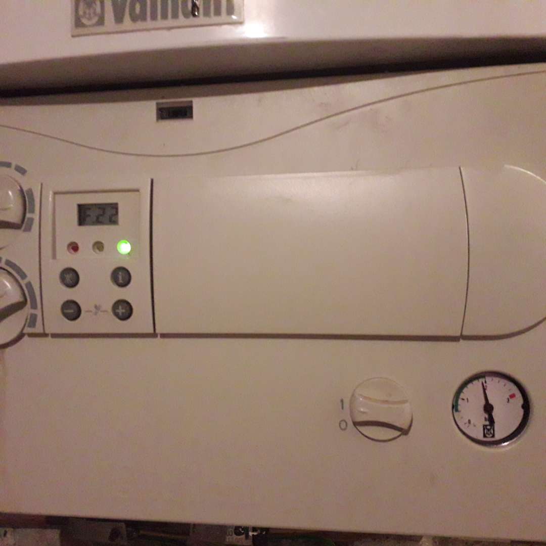

Okay, so I thought I'd try to do dishes again since the heating was on and pressure was good. Like usual (but not always), the water started to heat up then got very cold. F.22 code, but the pressure is still showing as about 2bar.
F22 on a Turbomax based boiler (an Aquaplus is a Turbomax with a HW store) has nothing to do with water pressure. The fault is either circulation or gas related so not suitable for DIY.
