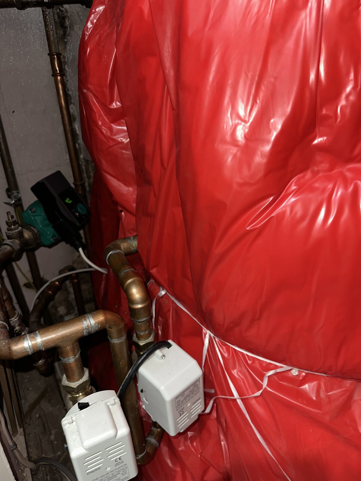

Over that week problems seemed to get worse. Radiators upstairs didn’t get that hot either (especially the furthest one) and pump didn’t really go above 0.1 bar. Then a new error code on the boiler started displaying, F.22, lots of knocking in the boiler, and we lost heating completely. I went out for an hour, and when I got back everything was working again - all radiators hot, hot water in the tank, pump reading 0.7/0.8 bar, and everything has been working since then. Only issue is that it looks as though the boiler is also heating hot water when heating is on (the pipes going from the motorised valve to the tank are hot) even though the hot water is off.
Any idea what could be happening and what was restricting the flow of water in the first place? I’m reluctant to power flush if it’s not needed, and given all radiators are now red hot all over. I’m thinking a faulty motorised valve restricting flow, but if it’s the hot water one that’s faulty, I don’t know how that’d restrict heating flow.

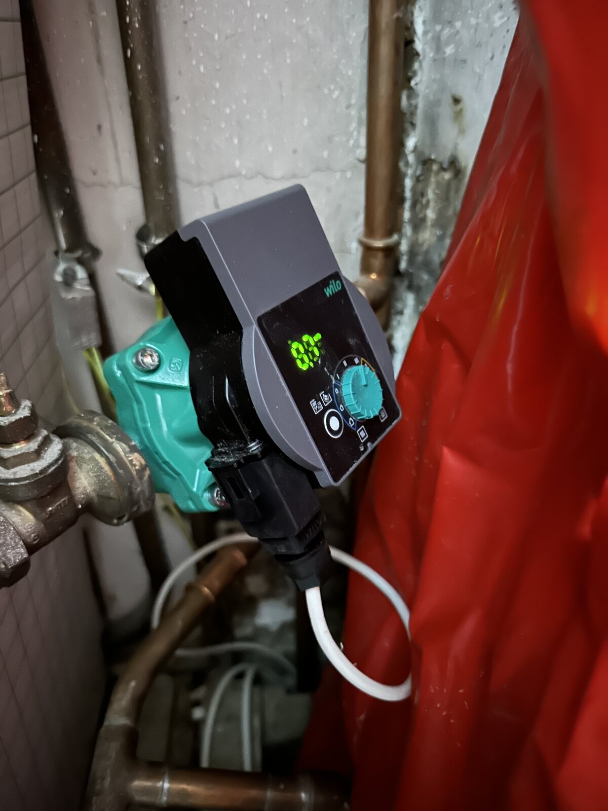

Apologies, not sure if it’s pressure or the speed the pump is working at, but it currently is measuring 0.7 on the pump’s screen.

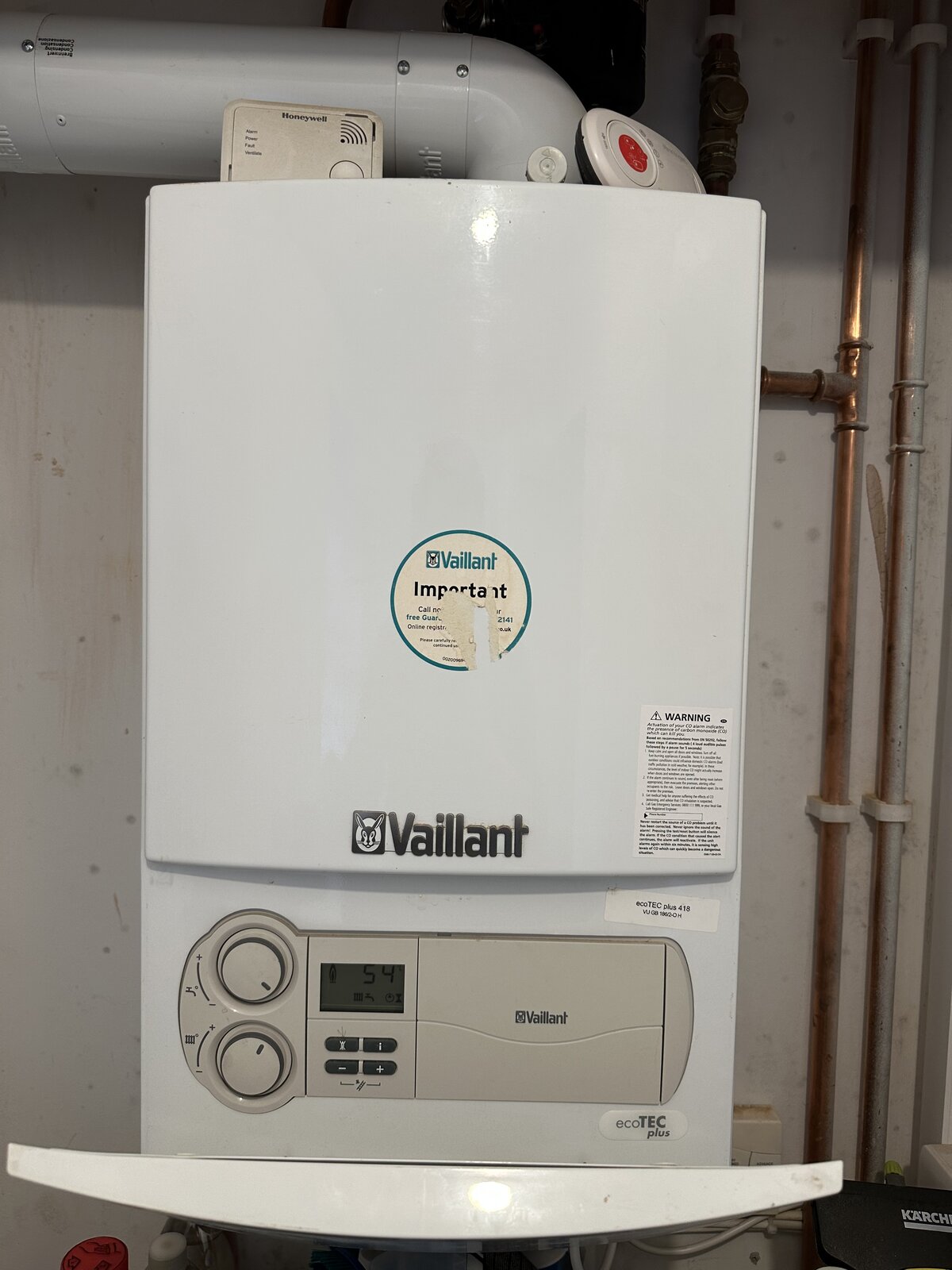

It’s an Ecotech 418 about 9 years old. It’s not sealed, there’s a tank in the loft that tops up the central heating.
If it’s showing 0.7 sounds like it’s showing the output in watts, but to be certain, can you post a photo of the pump? Also, according to the manual there’s no f22 fault, which I’ve always known as low system water pressure. Can you also post a photo of the boiler?

I’ve added some pictures of the boiler, the new pump, and the tank/pipes.

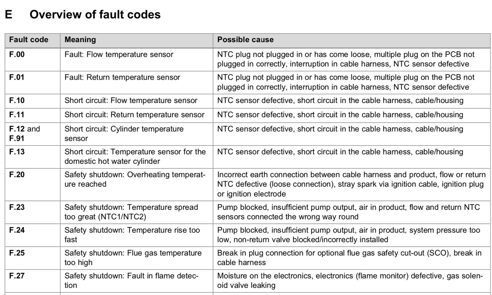

Ah, so I think it’s older than 8/9 years, but that’s ok. Yep, F22 on that particular model relates to dry fire (similar to a lack of water pressure in a pressurised system), I would check the cistern water level and make sure it’s able to fill back up in the loft, check the operation of the motorised valves, check any bypass fitted to the system and the pump valves are fully open. Have you expressed these concerns to the company? If you don’t want to use them again, I’d be seeking a refund as they haven’t done their job properly.
Thanks so much. I’ll check all of that. Would this be connected to the original f.23 error with no heating downstairs and low pump operation? Just want to try and avoid it happening again.
Cheers
Rob
Certainly could be related, as F23 is a temperature difference, so if not the pump a circulation issue, such as a blocked cold feed.
