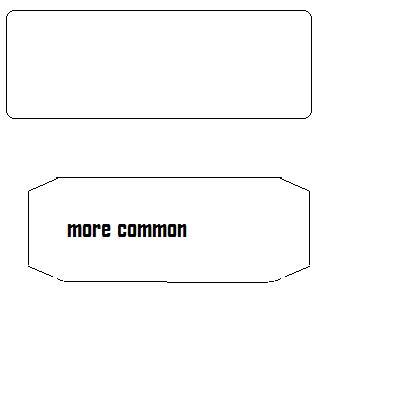

If you are gonna change it yourself make sure you get the right one. There's 2 types for that boiler, they are easy to tell apart if you know what your looking for. You can try putting some chemical into the system, It might work it might not! Something like X800 would be your best bet, but you'd have to make sure it got a couple of hours circulating through the plate he. Might aswell flush the rads while your at it, seeing as thats where the problem started.

you can try X400, personally I don't find it that great. X800 is much more effective. You could always drain a radiator,remove the vent plug and funnel it into the rad. The part number you qouted is by far the most common one and likely the one you need, but I know people who have been caught out...
where abouts are you btw?
here I've done you a nice picture
:D
