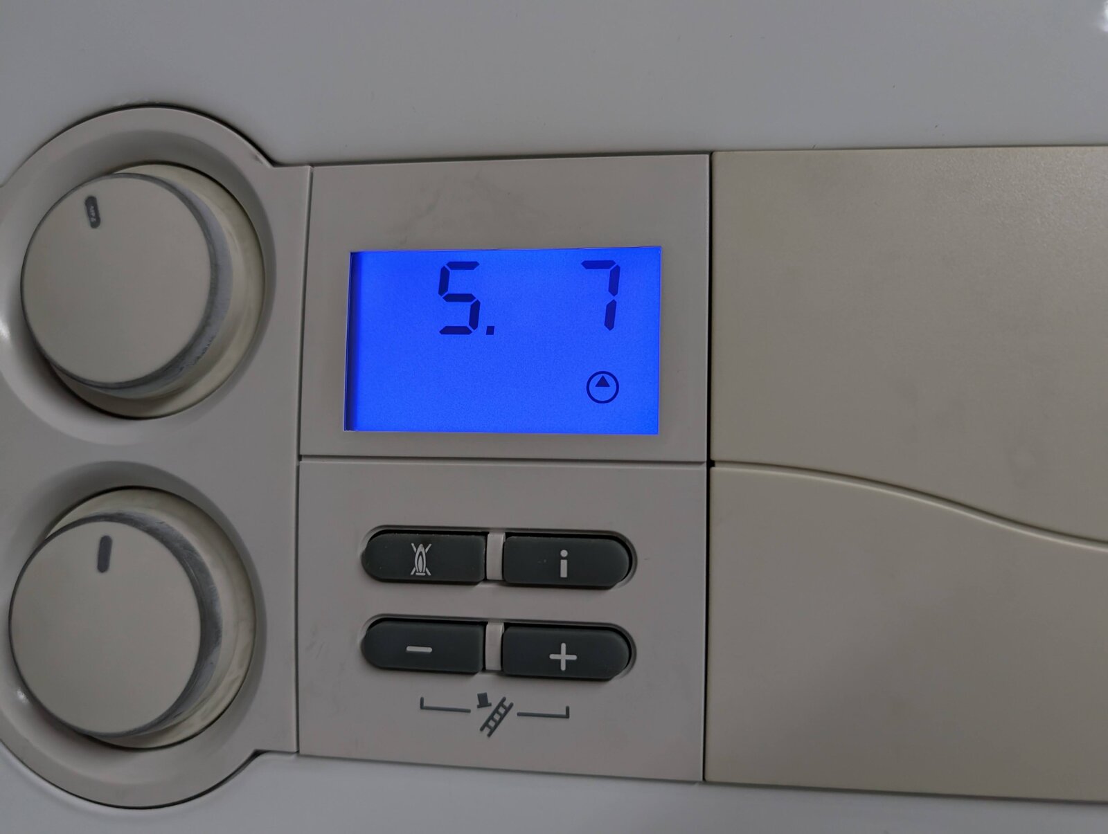

The hot water system works perfectly, but the heating system is not working at all (it used to work before leaving).
Signals:
The boiler shows status code S.30 (thermostat blocking heating).
If I press the button on the thermostat receiver, the heating SEEMS to try to start, it turns on the icon of the heating pump (altough not the burner), and remains in S.7 (water pump inertia). It never starts the burner, and heating doesn't work. No error code is shown at any time.

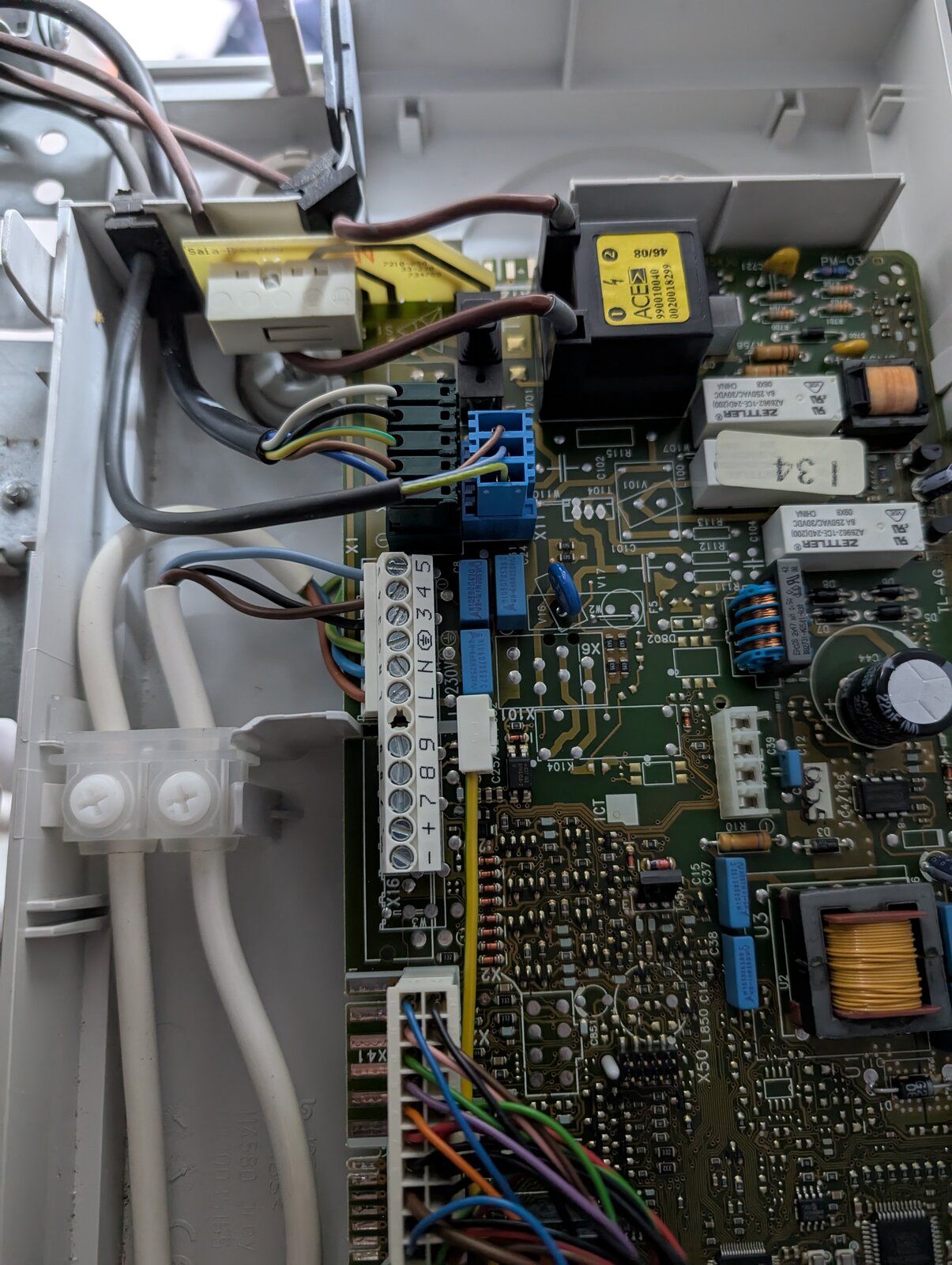

The thermostat isn't calling for heat. You can bridge 3 and 4 to get the heating to work but some vaillant's have a drop down door that allows access to the wiring connections without opening up the combustion chamber. I don't think yours is one of them.
Remove the thermostat and send the wiring behind it.

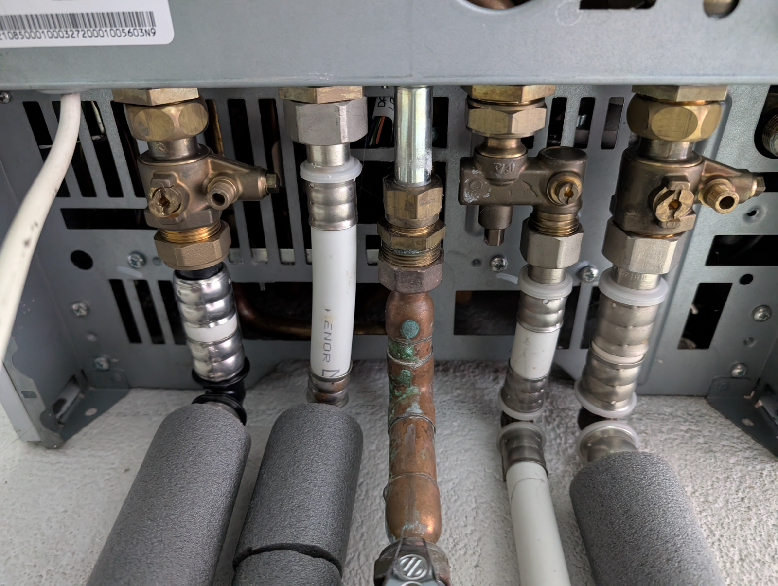

The only valves I'm aware of are those of input/output of the heating system water (those at the two sides of the picture).
These were not touched before/after the problem
Remove the thermostat and send a picture of the wiring at the back.
This is the wiring.

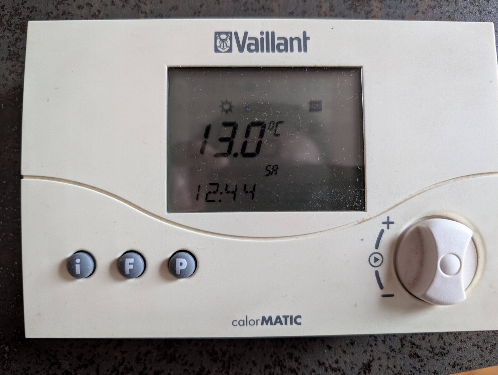

3,4,5 are coming from the receiver of the thermostat VRT240f
Yes! It worked!!
Before your messages I didn't have the courage to open the electric board of the boiler

At the moment my best guess is that the receiver is not working properly (bc I tried operating it manually with the remote off, and it didn't work).
So when I did the bridge between 3-4, I disconnected the receiver, because it was generating the malfunction of the system.
Now heating works but I can't turn it off. So I'm planning to buy a new thermostat+receiver.
Ok, so to close the thread, I want to thank @Jurassicspark (huge kudos to you!) and @cross thread for your contributions.
I concluded the thermostat receiver is not working properly. After doing the bridge, and willing to add a manual control to it, I remembered I had a never used wifi switch bought in AliExpress ~4yr ago. I connected it to the bridge in the same way the receiver was connected, and magically I got the heating system to work with the "smart life app".
