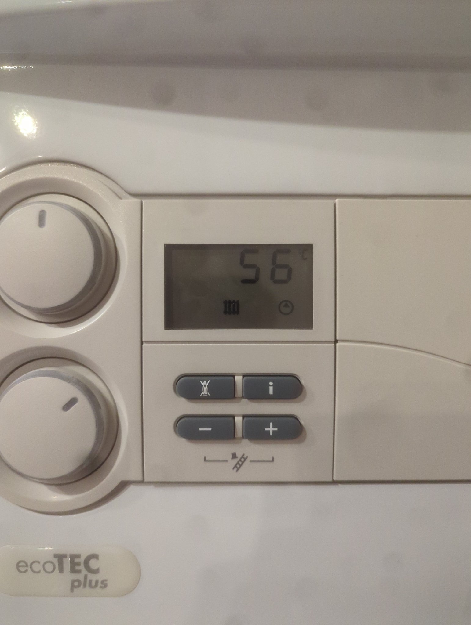

Signals:
The boiler shows status code 5.0 not sure what this means.
If I press the button on the thermostat receiver, the heating SEEMS to try to start, it turns on the icon of the heating pump (although not the burner), and remains in 5.0. There is an arrow symbol. It never starts the burner, and heating doesn't work. No error code is shown at any time.

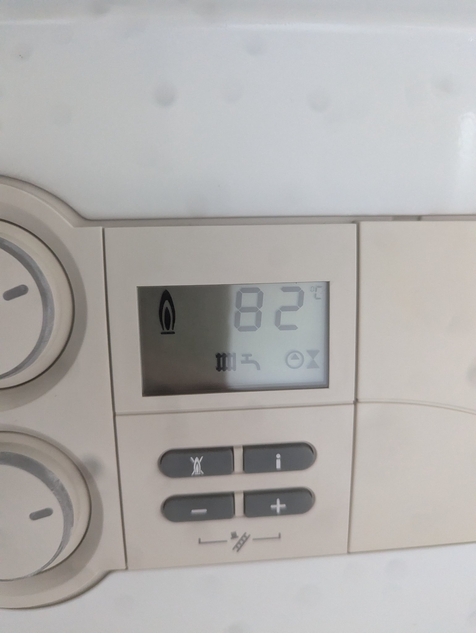

Engineer replaced diverter valve, I managed to get genuine part. But instead of no heating, now I have heating but no hot water.

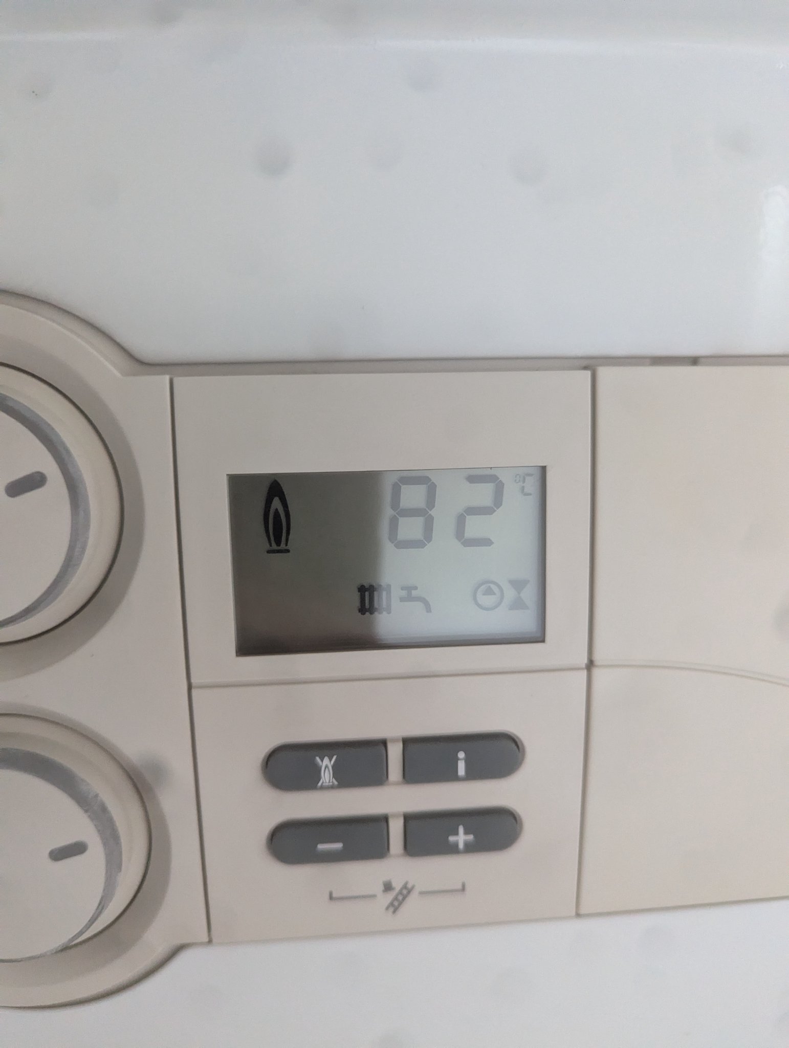

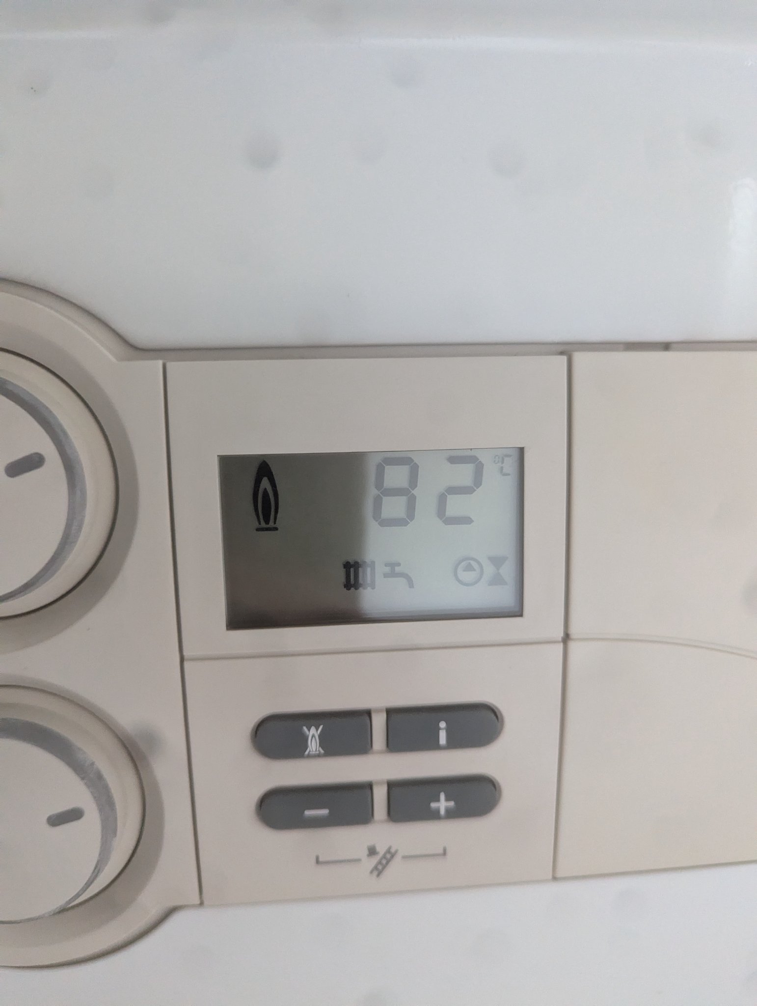

Problem:
However, following replacement now there is no hot water but heating is working. Engineer advised all tests have been done and could confirm hot steaming water was present.
Signals: see pic attached
No error codes.
When hot tap is on temp rising from 60deg to 87.
Tap symbol is on
Flame symbol on
Egg timer symbol
Also now the radiator symbol now flashes sometimes. Don't recall this happening.

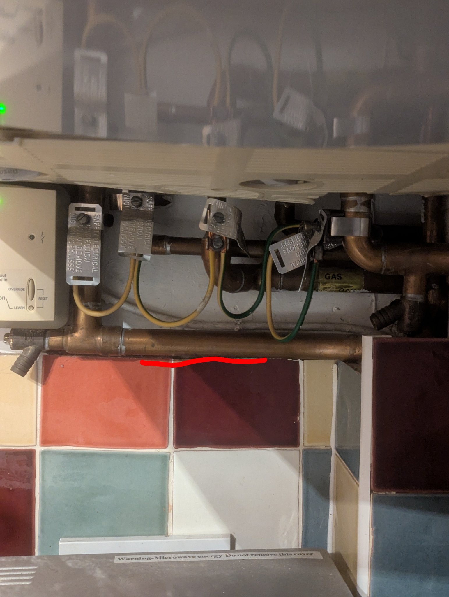

What I've checked:
The left side tap is now super hot to touch, you can barely touch it with heating and hot water on.
Turning hot tap calls for hot water
Should i ensure diverter motor is now checked ?
Any other suggestions would be greatly appreciated.

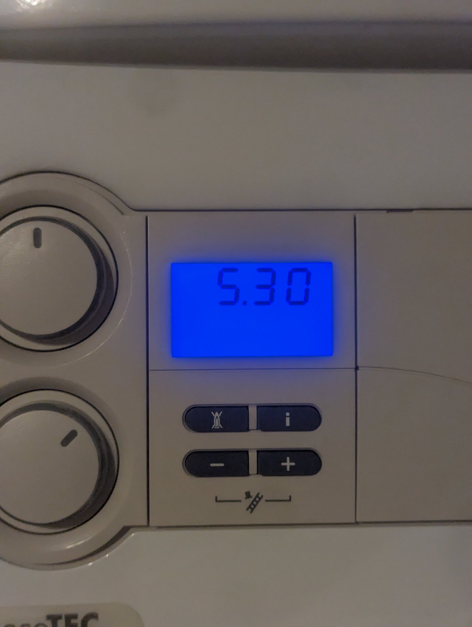

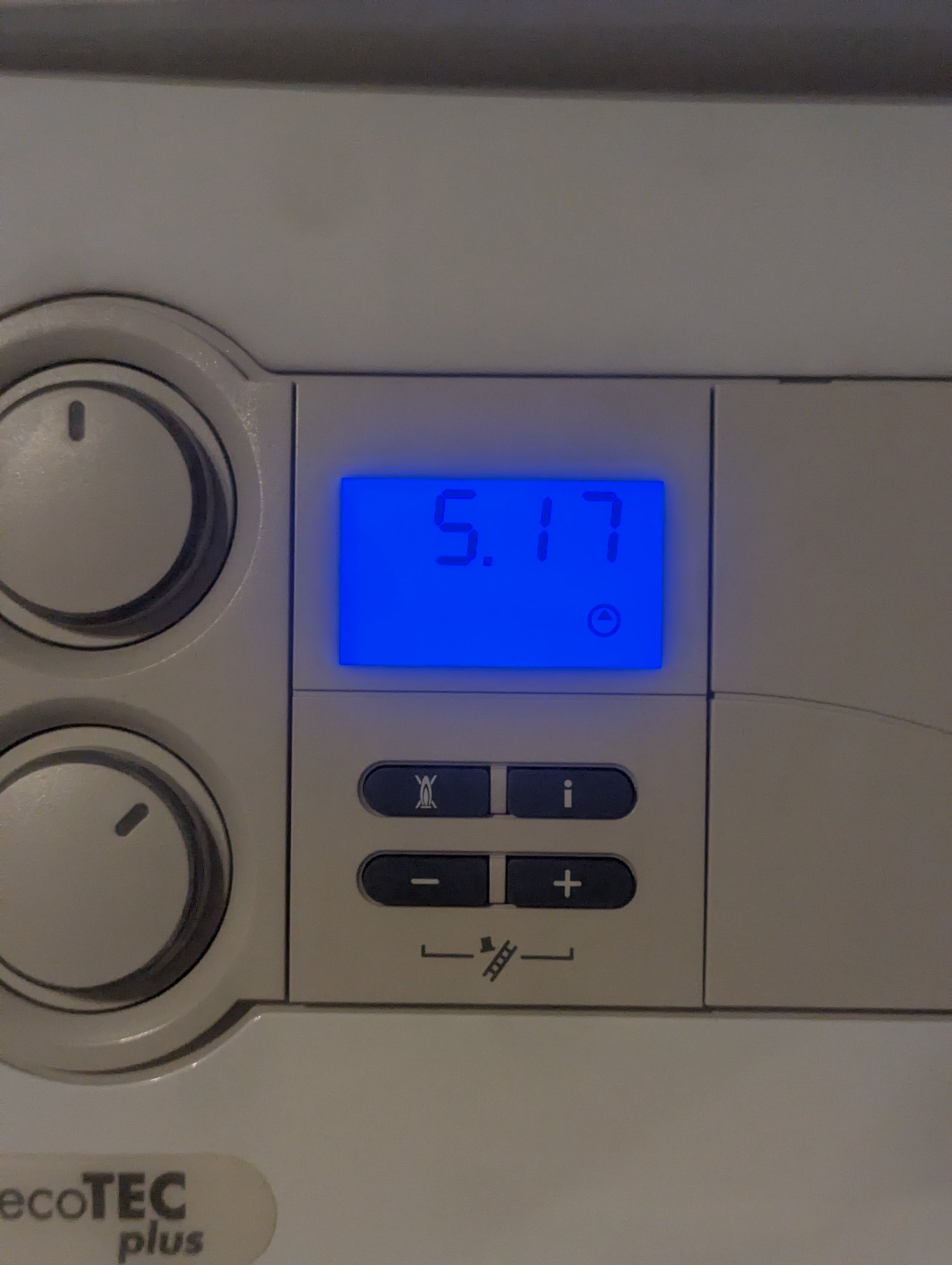

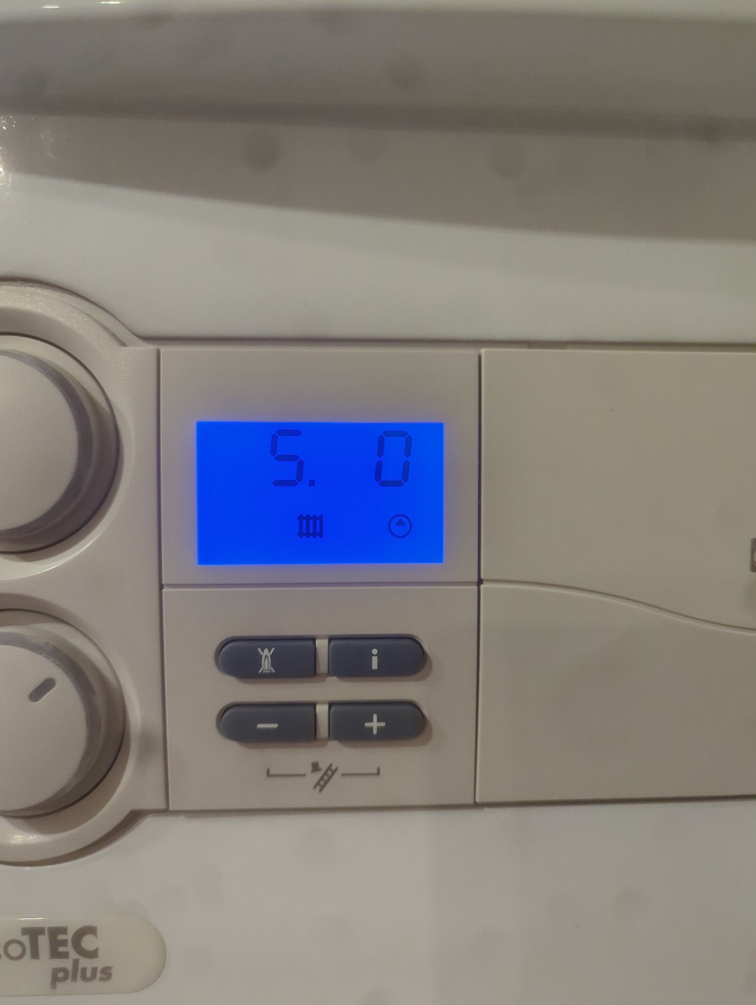

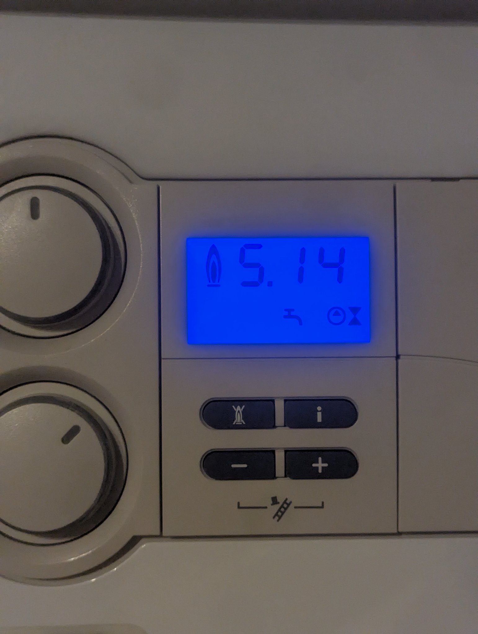

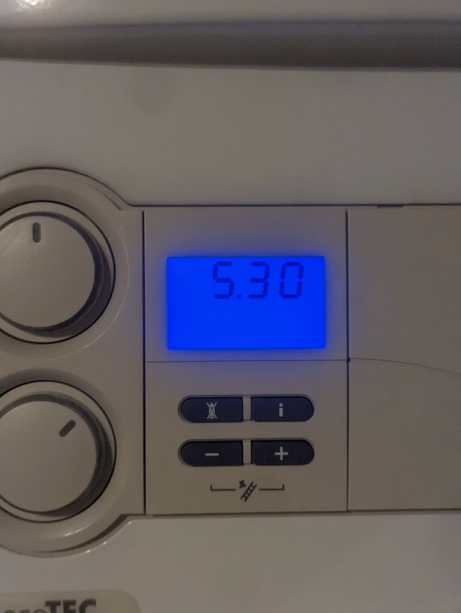

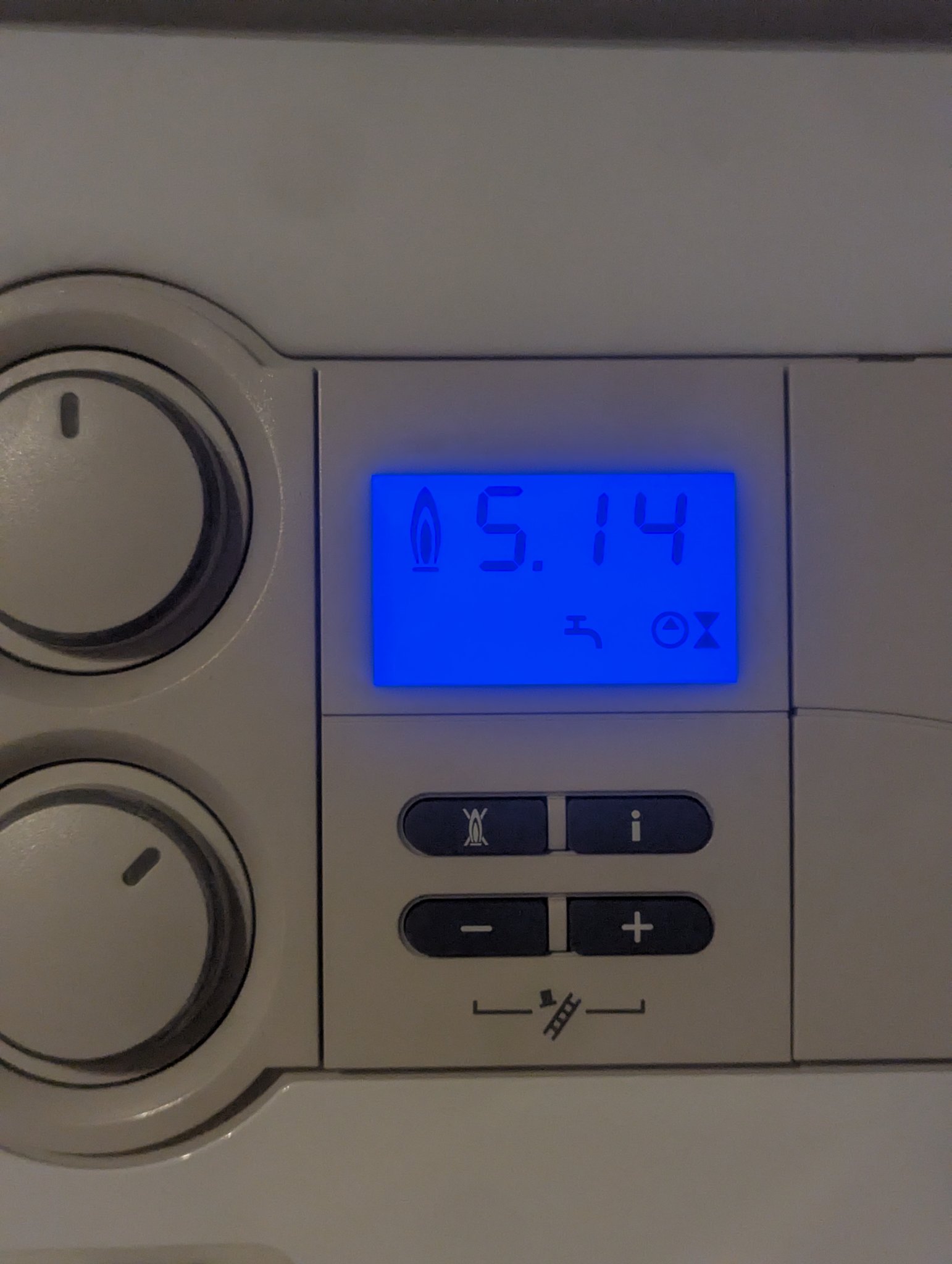

Was the whole diverter changed? Possibly a trapped wire on the diverter harness. Press the I button when running hot water, what does it display? S.14 is running hot water. If you do it from cold, then feel the flow pipe, if this begins to heat up then it’s going down the heating circuit.

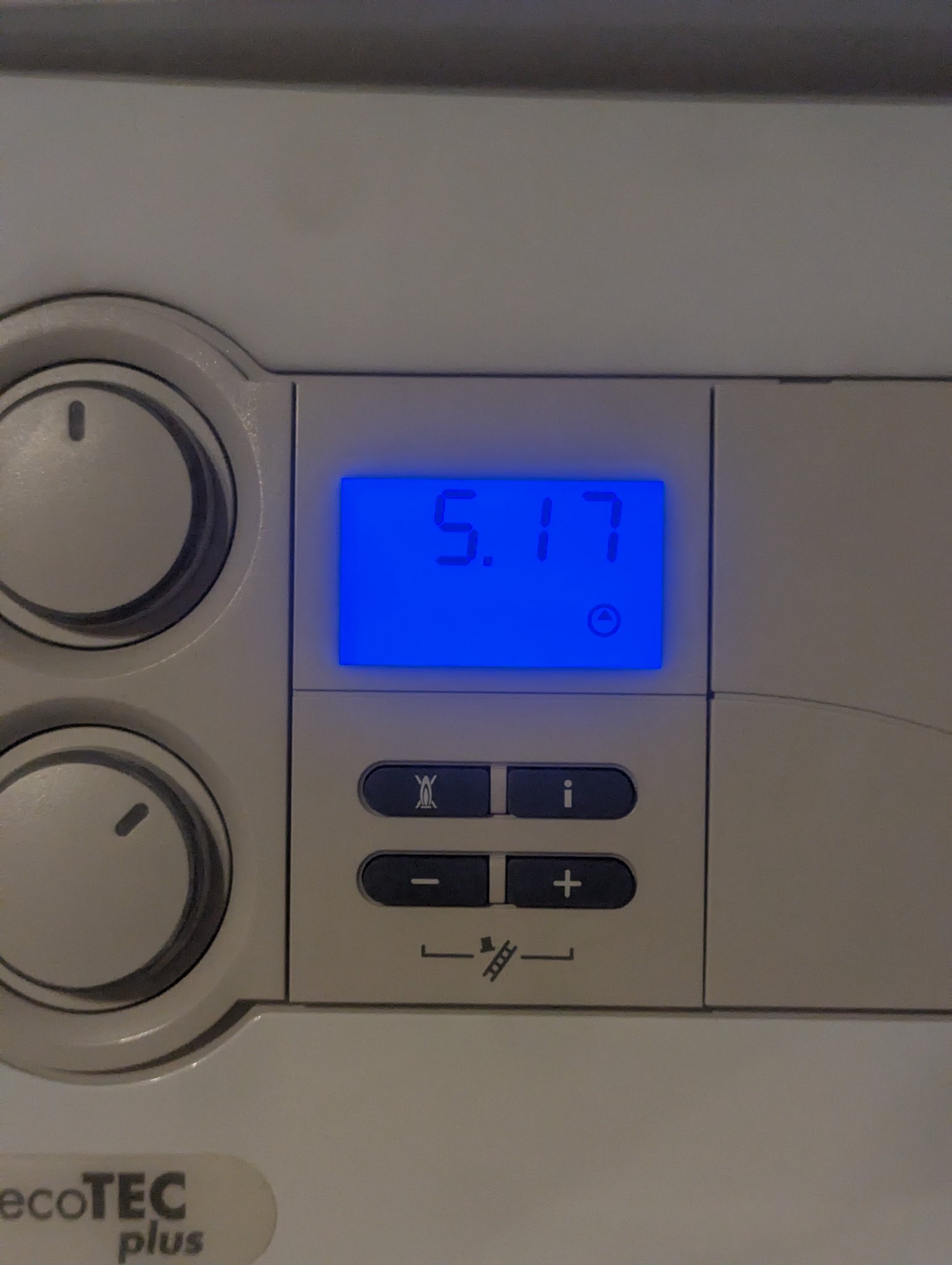

Yep happening exactly as described. S.14 and the left pipe is getting hot. Also noticed radiators are hot even though heating has been off since afternoon.
When tap is turned off getting S.17
When boiler stops completely getting S.30

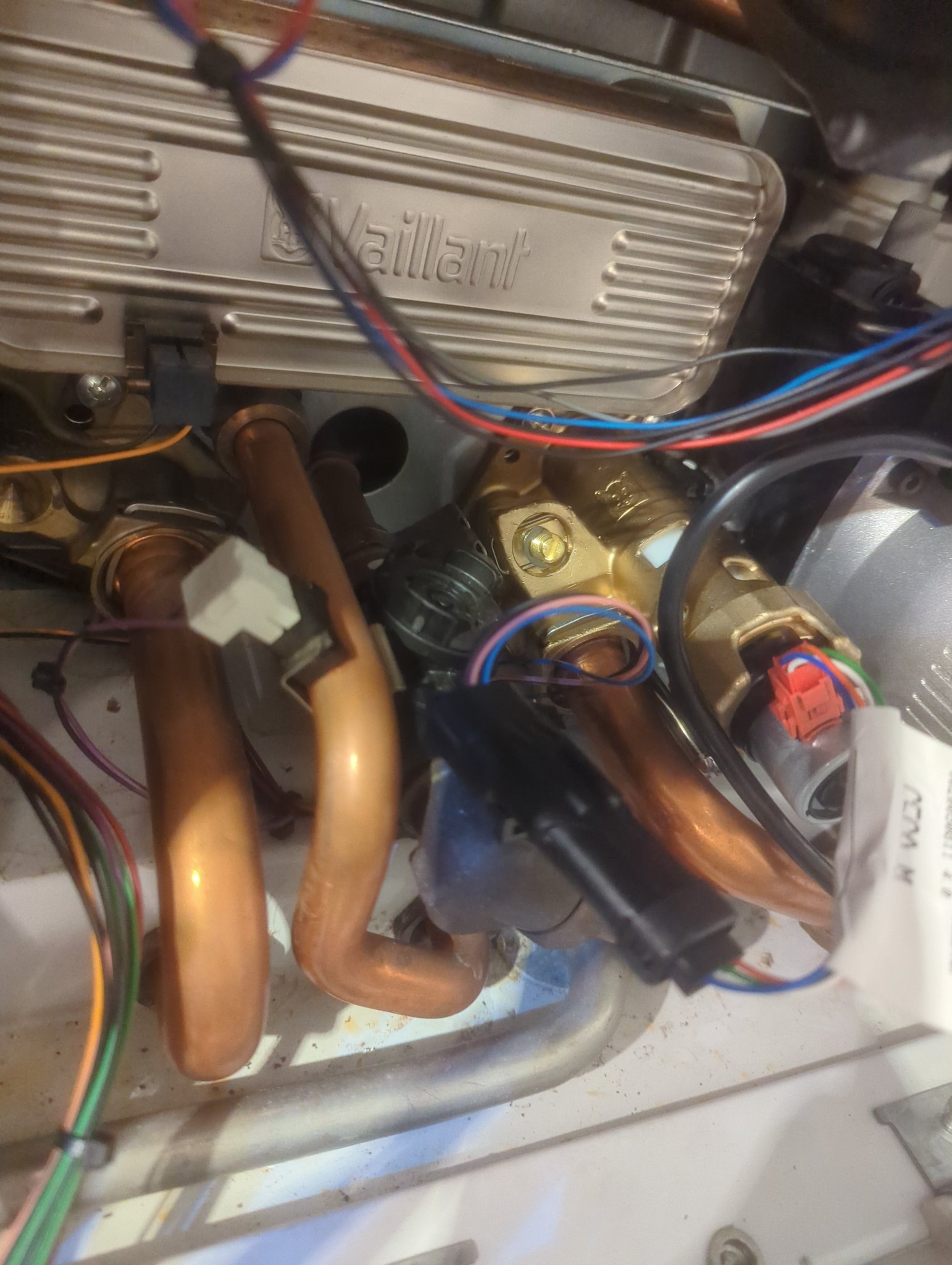

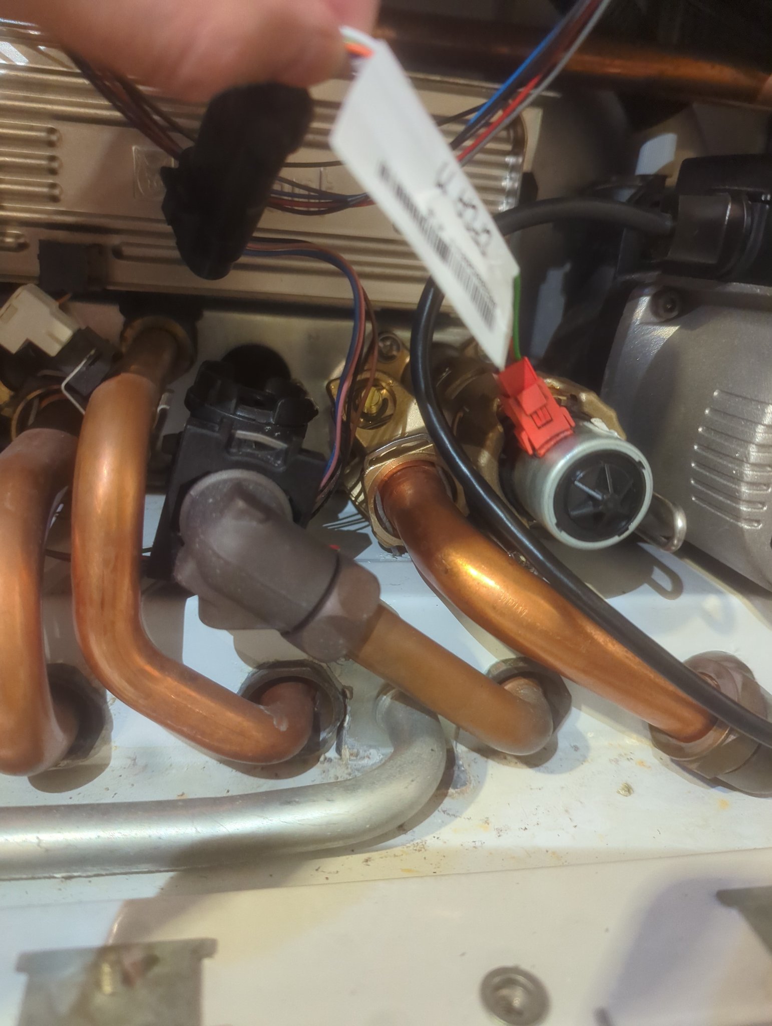

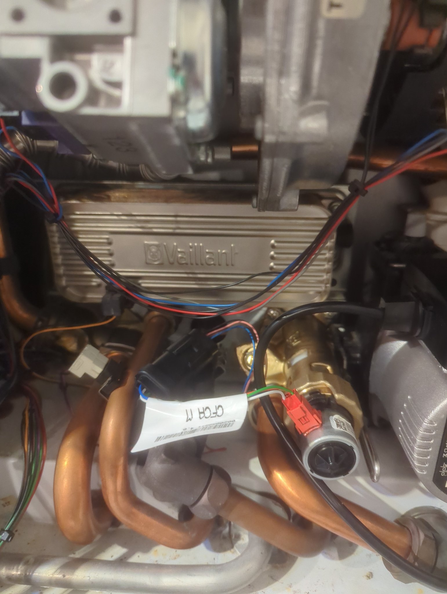

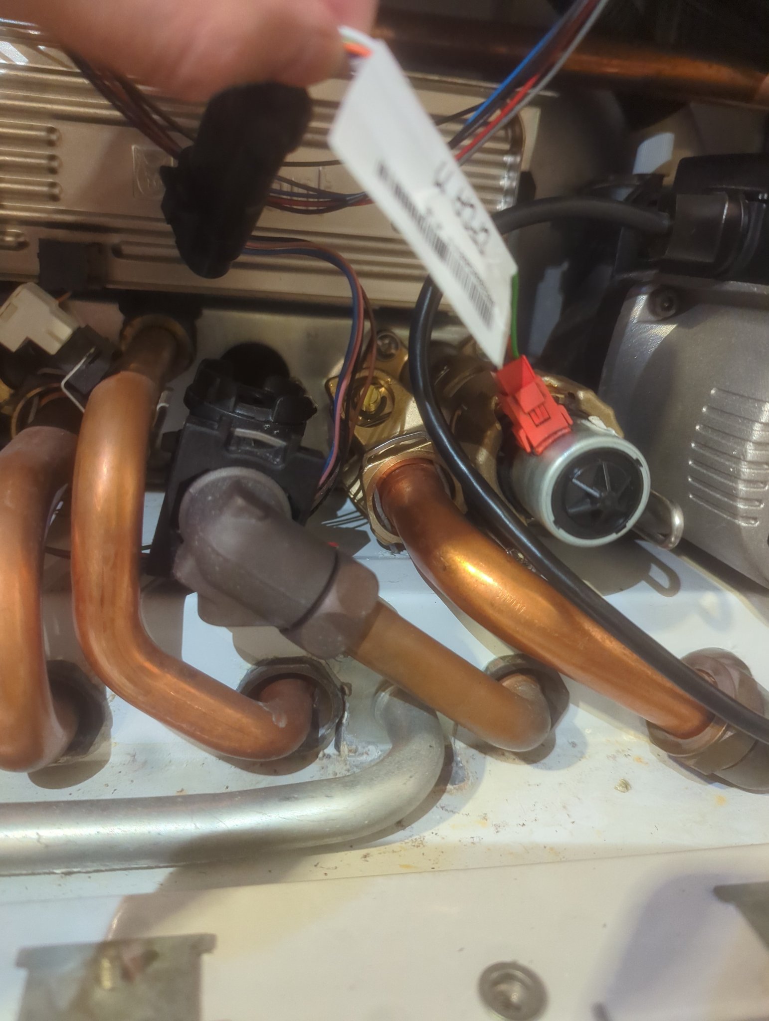

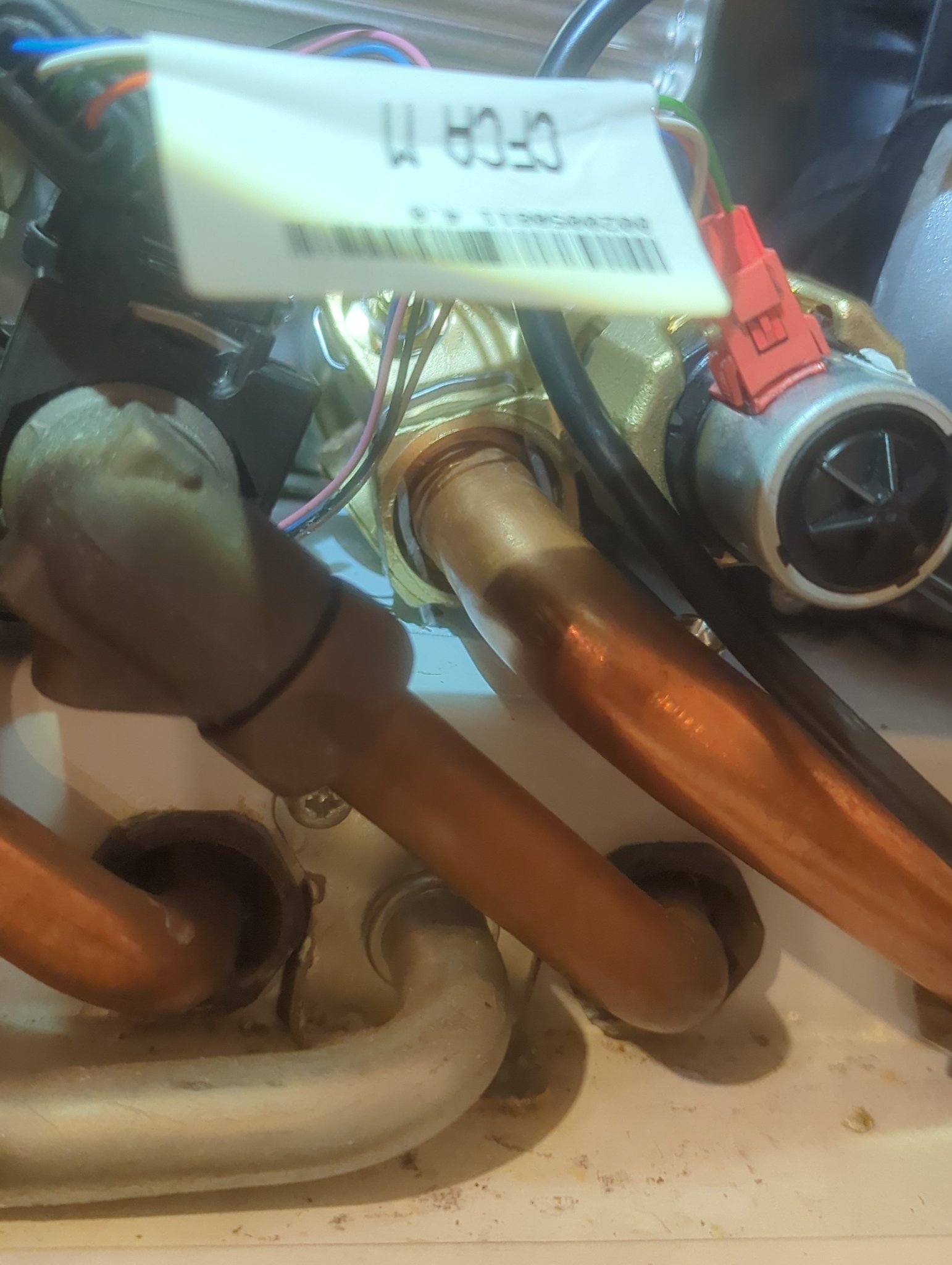

Ok, s.17 is pump overrun for the hot water circuit, S30 is no heating demand/blocked by room thermostat. If the left pipe is getting hot, and the radiators are heating up then it’s circulating into the heating circuit, as I said, could be a trapped wire not causing the motor to move over or coincidentally crap in the system is stopping the motor moving.

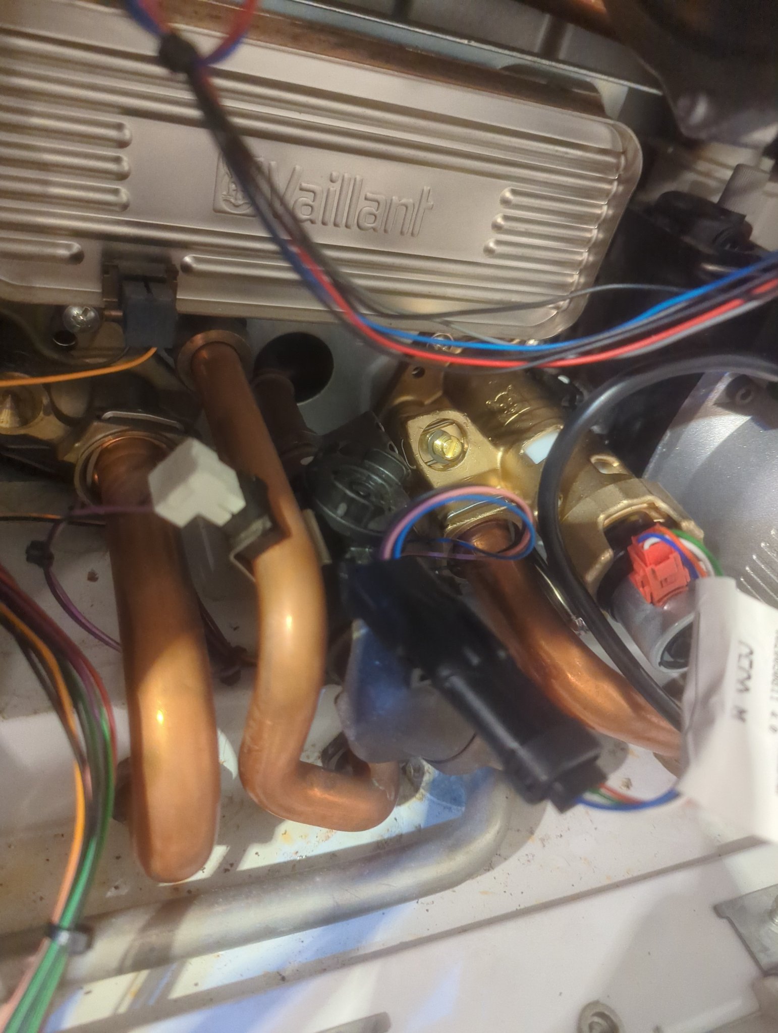

If you’re able to, remove the cover and take a photo of the diverter valve/motor and wiring tie the black or brass coloured one that connects to the pump.
Not sure if I've taken correct pics. Let me know if you want anymore.

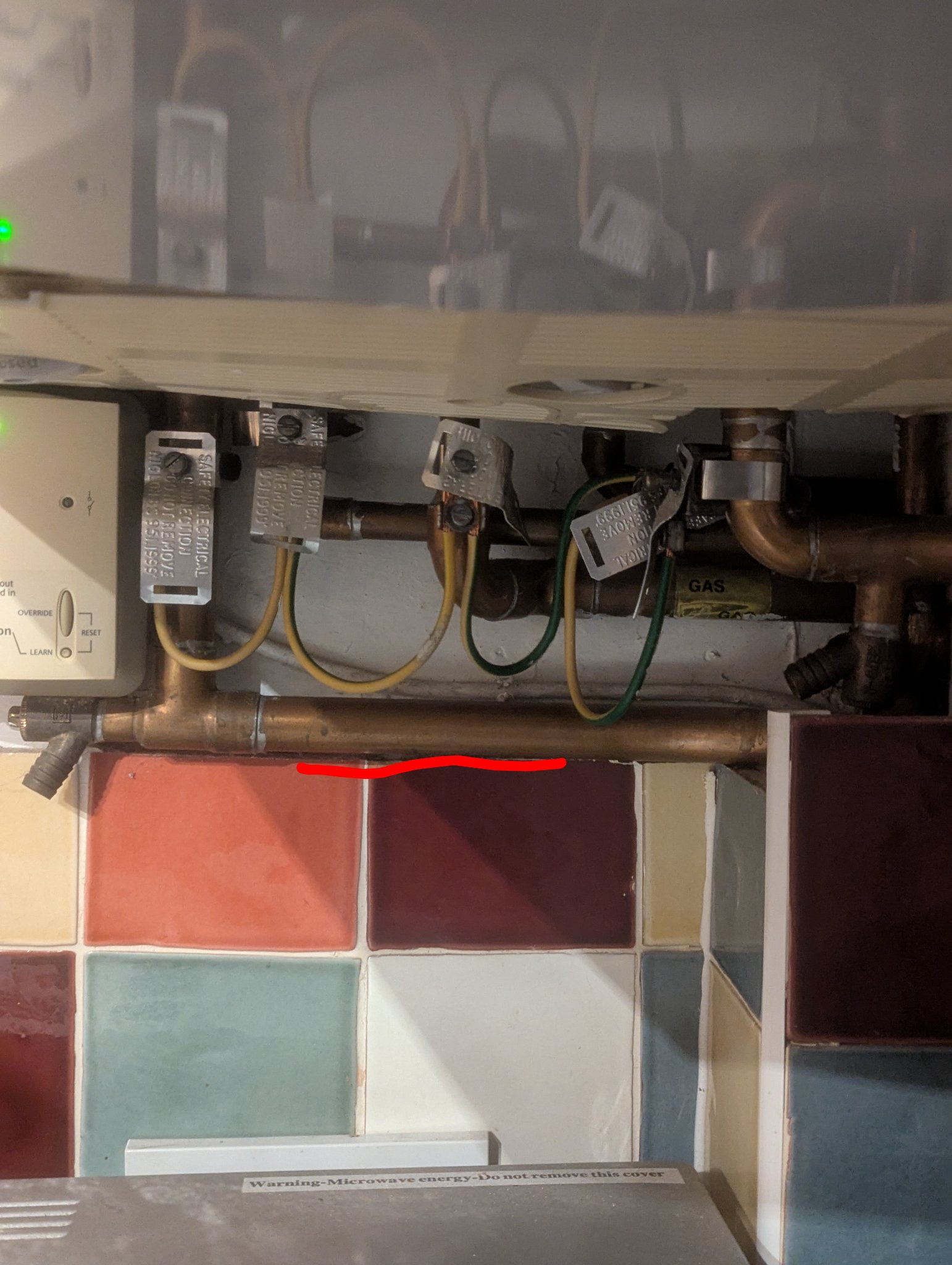

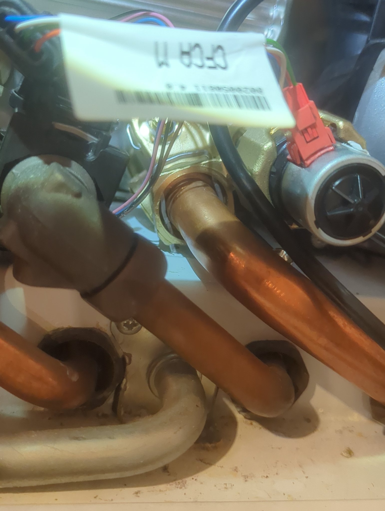

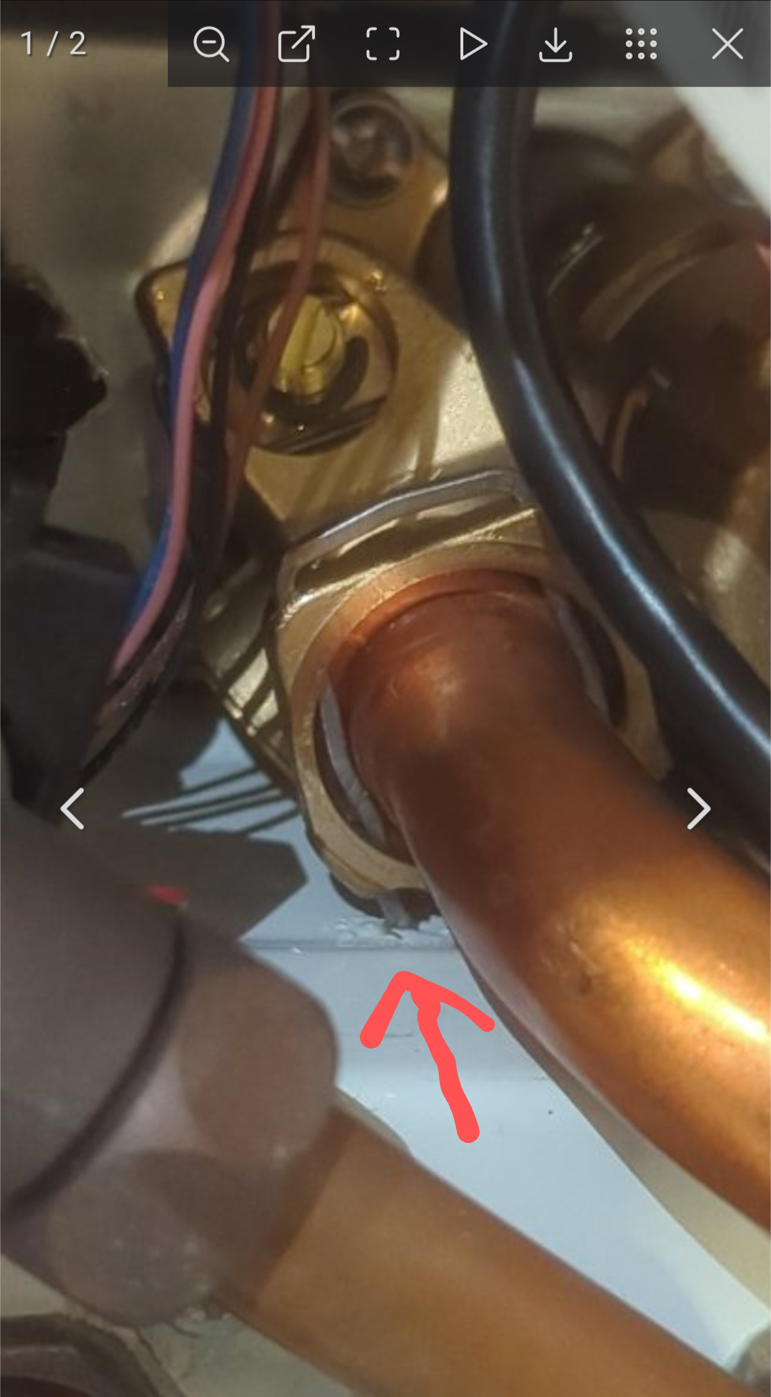

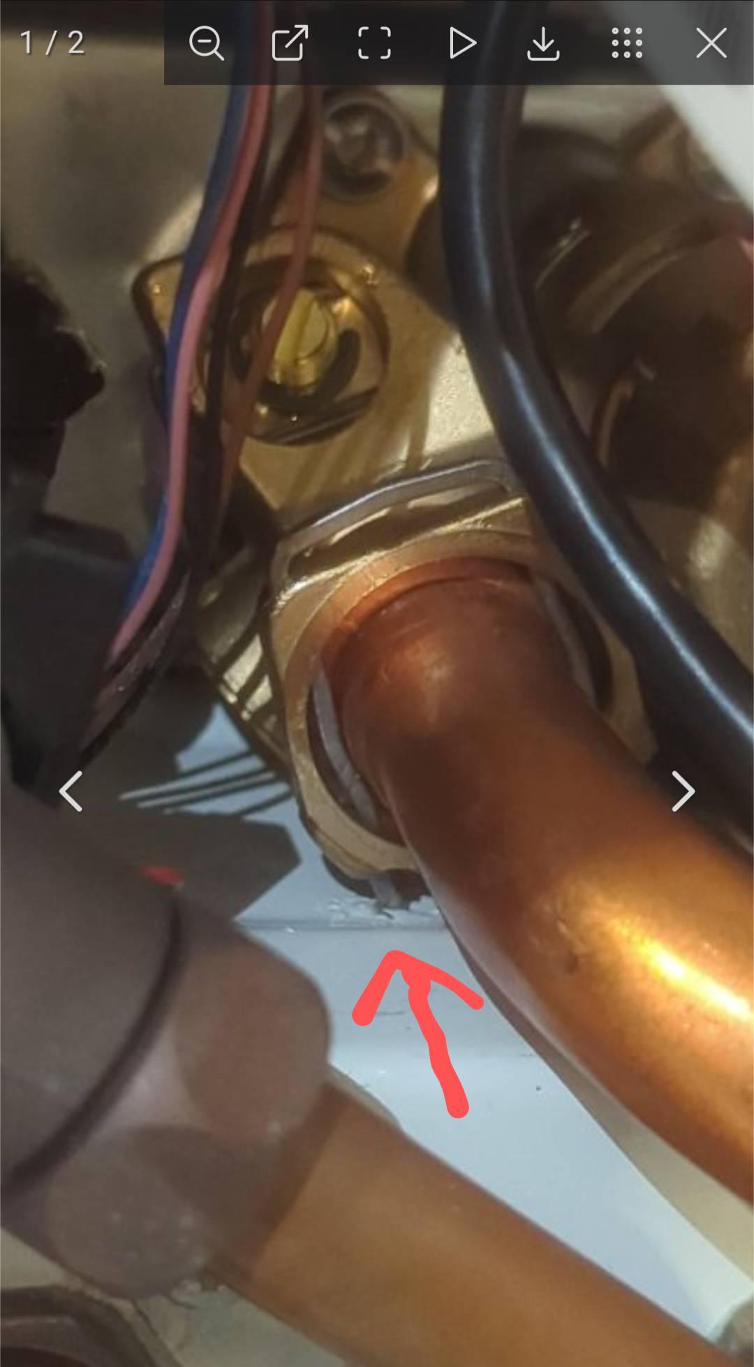

Does that look right to you where the valve is digging into the bottom housing ?
Not sure what you mean, but it looks ok to me. The red plug in connector looks a bit suspect though. If you unplug the part where it connects onto the motor, check the pins are all straight.
