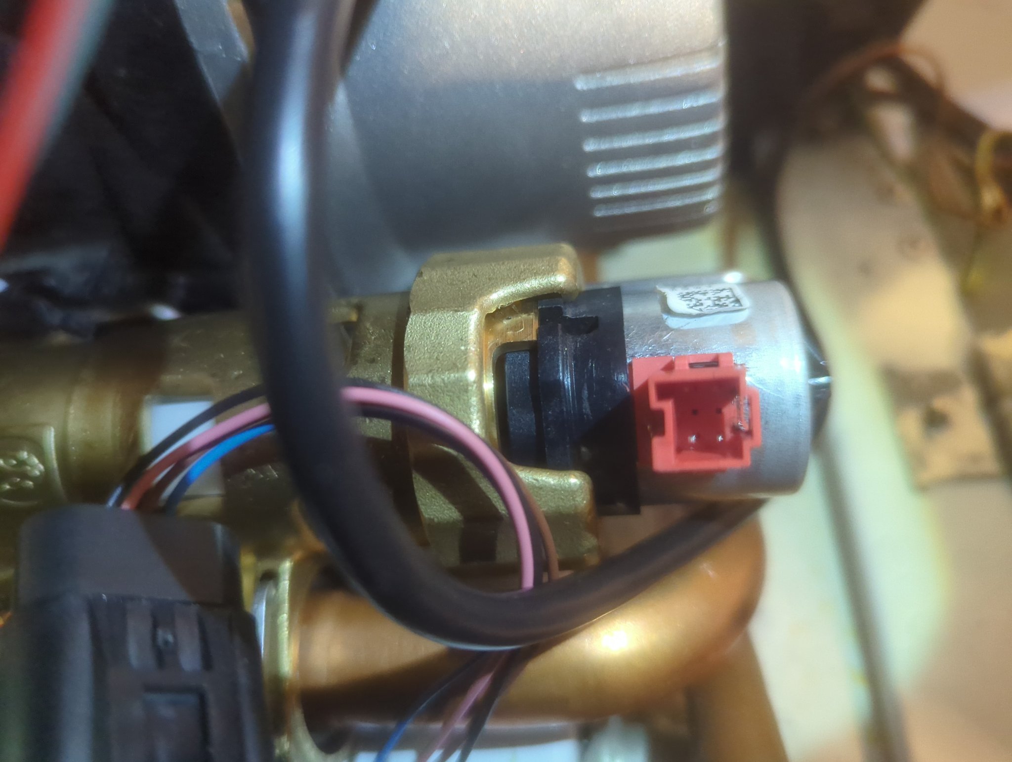

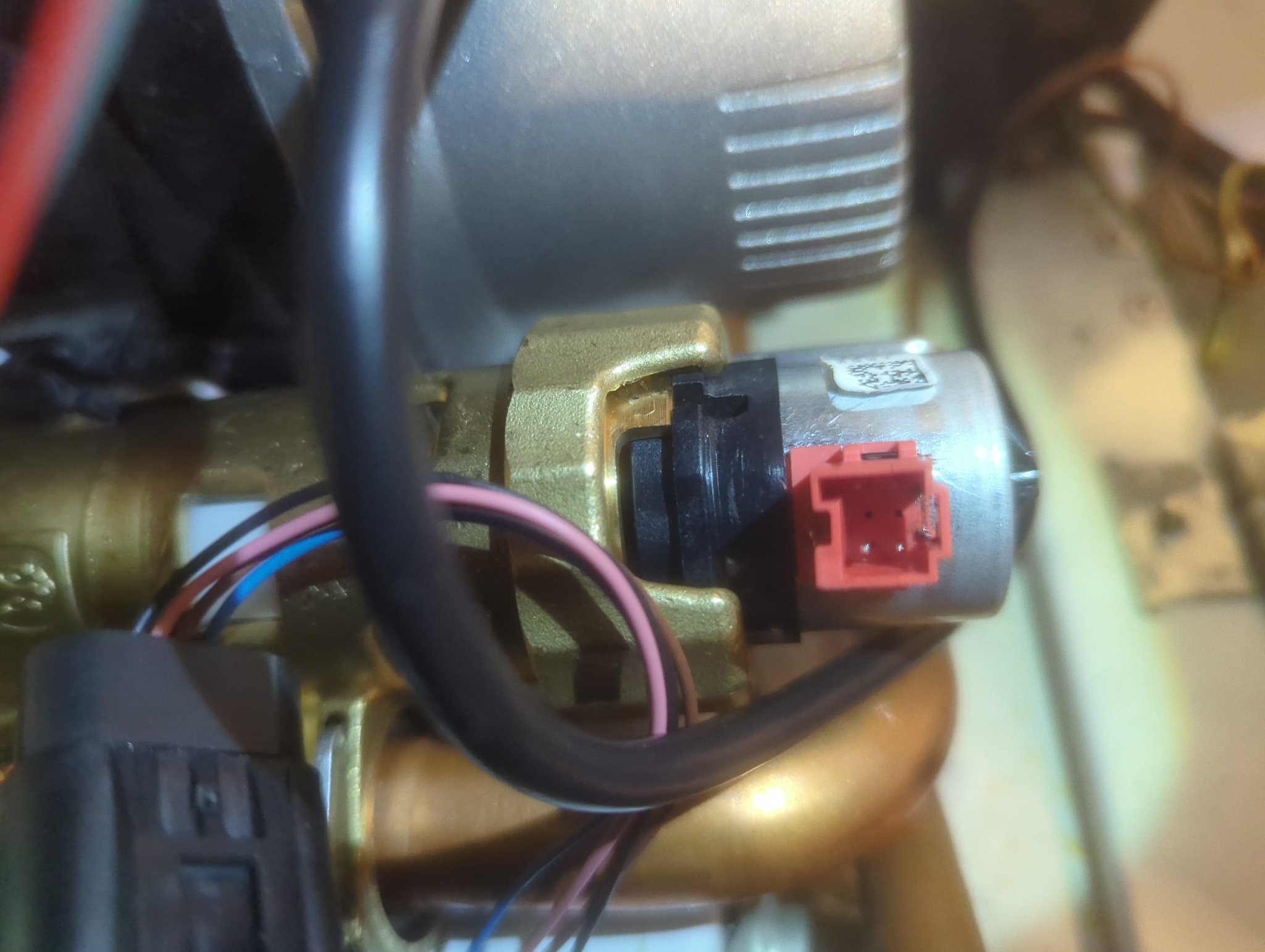

See the last zoomed in pic 1.4mb.
It's like a big jubilee clip. The ends are digging into the boiler housing.
The housing for that r d clip is totally loose I didn't even yank it, it's ready to come off.
Pins seem straight.

Yep, still looks ok to me. That’s just the circlip that Vaillant use, I feel it’s touching (not digging into the metal) then it’s fully home.
Pins seem straight.
Except you seem to be missing 2. There’s usually 4, possibly more, I only see 2. I’ve had a few where they’ve been bashed about, yours looks the same. Lack of pins, means lack of motor movement. You need to send the motor back to whoever sold it to you and or ask for a replacement.

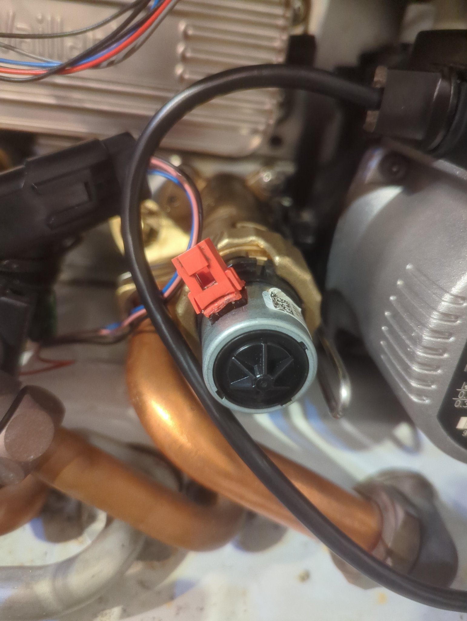

Best photo I can get without getting one from my van:
Not sure how your engineer managed to get hot water. Either they damaged the pins or they ran the boiler in P1, which by some fluke gave hot water.
There's 4 pins. Camera is just rubbish.

So engineer came back.
Checked if the pin in the diverter valve was moving couldn't confirm.
Did some tests manually in the diverter valve to see if functioning and switching and it was.
Put the front part back on (guess it's called controller) where the pin is meant to move and same problem. No hot water.
Replaced the original Vaillant one with a spare from the van. Only the first part within the diverter valve that controls the pin guess it's called the controller.
It worked we now have hot water and heating. However still have error symbols and fault codes. Engineer quickly said it's fixed and disappeared. With the original vaillant controller part of the diverter valve.

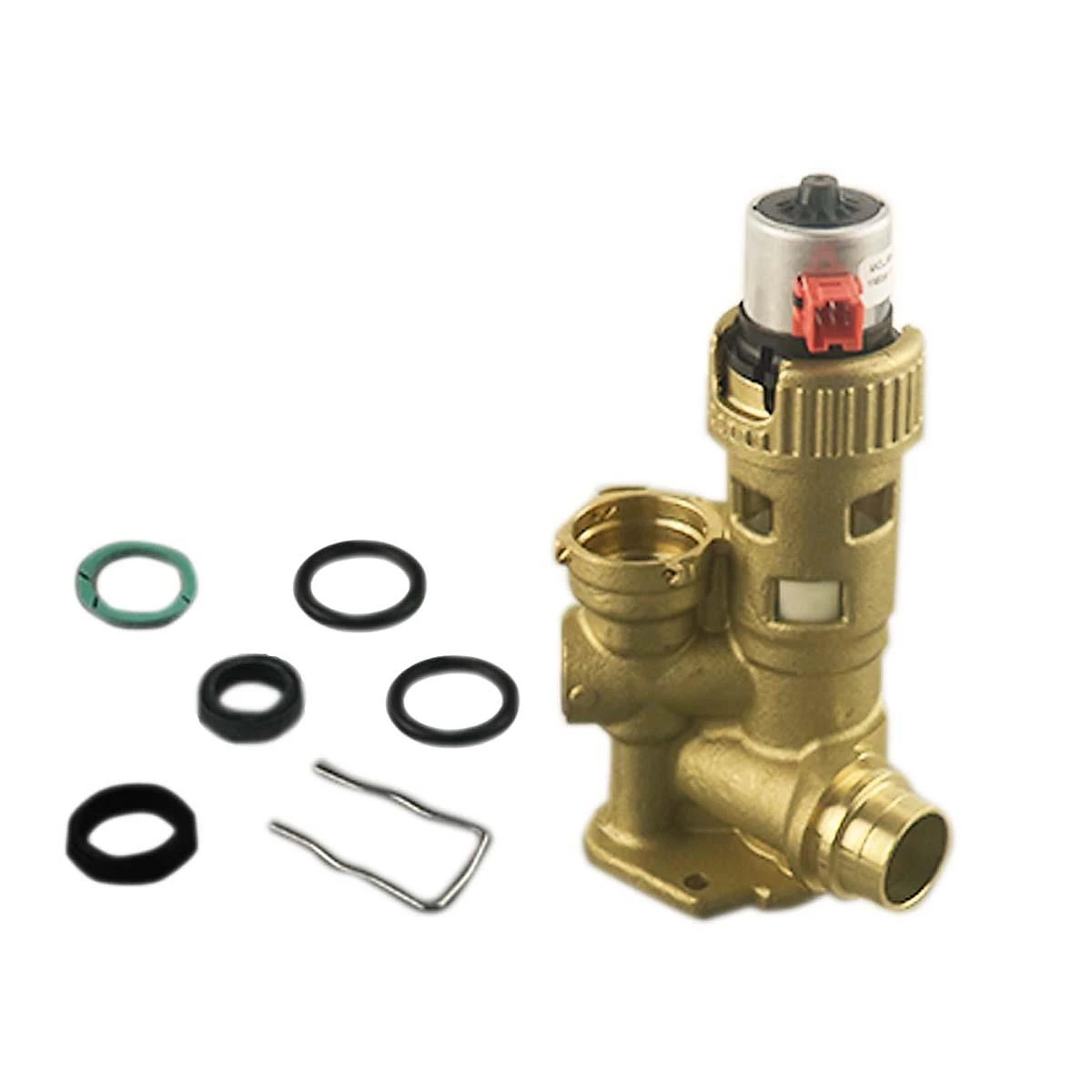

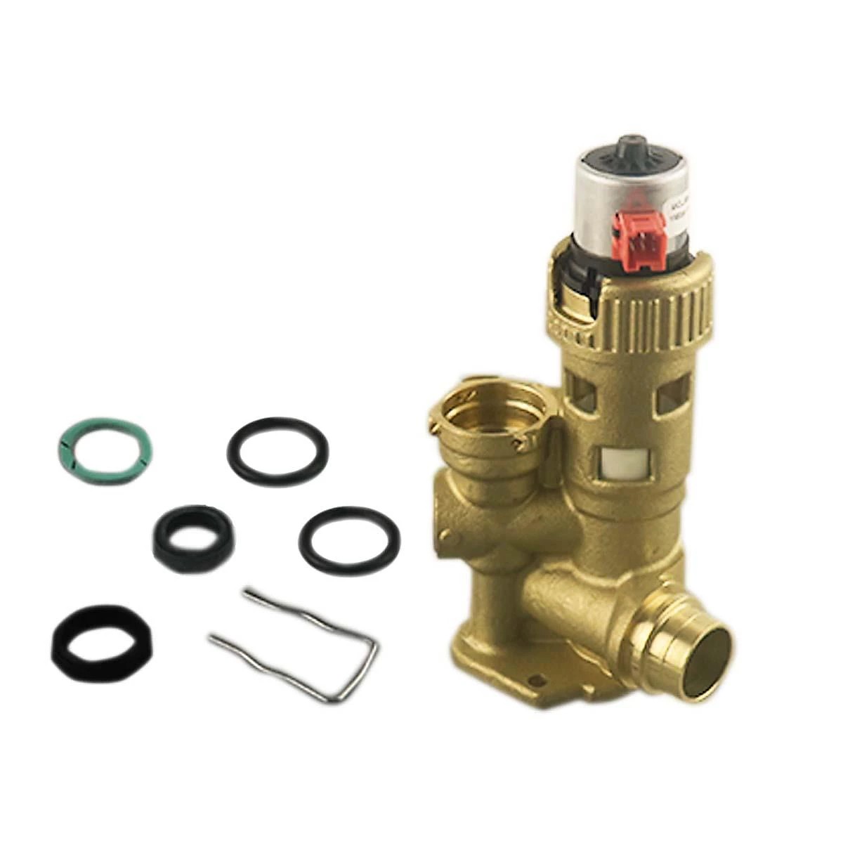

As I mentioned on previous posts but I didn't make clear, they are status codes not error codes. Apologies, I meant to check the motor for pin numbers but got waylaid. Will do it now and upload - brand new one I've opened just to show you what it should look like

As I also mentioned to you it seemed the diverter motor wasn't in great condition, so he's obviously swapped with one he had.
