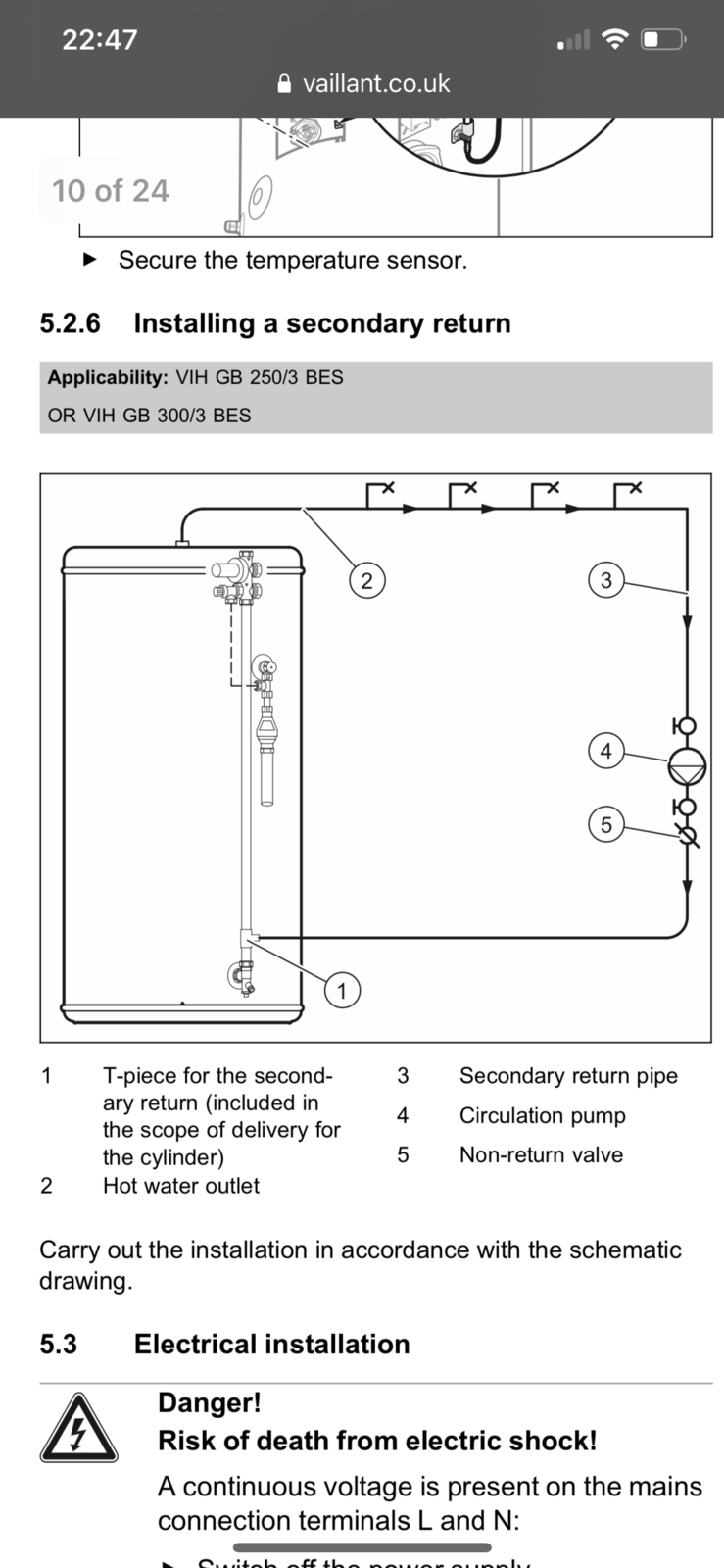

Vaillant unistor secondary return
20 Apr 2005
466
20
Gloucestershire
Is it possible to install a secondary return on the 200 litre model of the unistor? The instructions only make reference to the 250 and 300 litre models but the connections are identical across the range from what I can gather.
