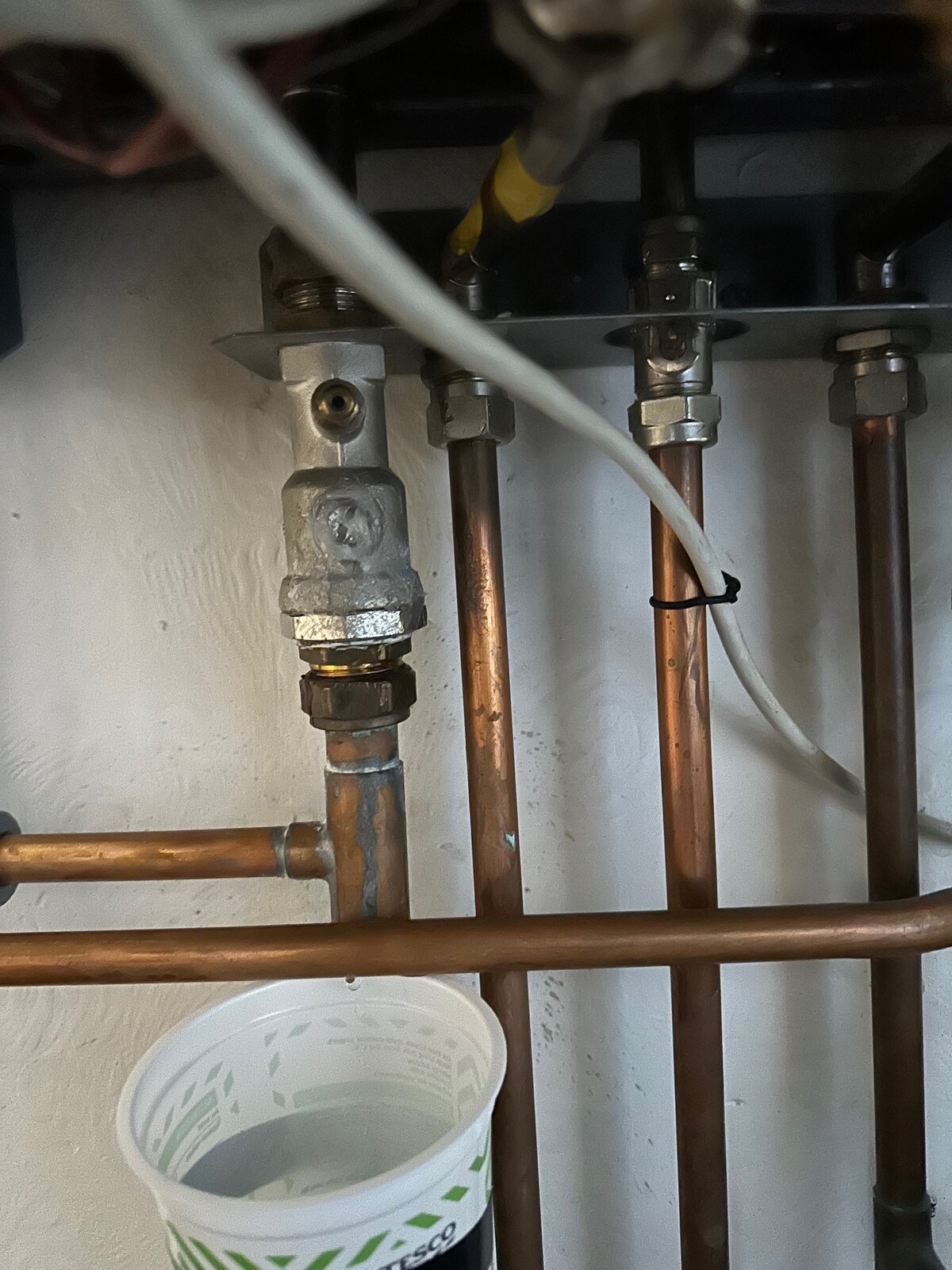

Hi,
I have one of these boilers and it's working ok.
I am after a heating flow service cock as my one is leaking.
Does anyone have a used one as I am not sure these can be bought from new.
Regards
Kyri

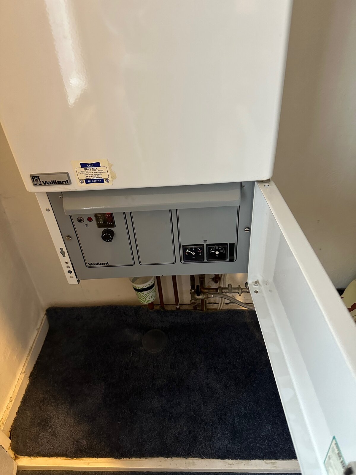

You would be better posting a pic of the isolation valve you want , there are loads of 242 vaillant boilers it just means 24Kw and the 2 means it is a combination boiler, gets very confusing when ordering parts
Here is a picture of the service cock I need and the boiler I have.
The boiler is working fine but just need the service cock.
Regards
Kyri

WOW that is an old boy , doubt you will get a replacement valve for that nut just replace it with anything that fits both ends at the end of the day no one ever uses isolation valves as they always leak after
I got someone to service it this week and they shut off the heating water flow to the boiler by turning that valve. Should they have touched it? That's why it's leaking, Can you service the boiler without touching that valve?
If i put silicon on the nut will that help seal the leak?
