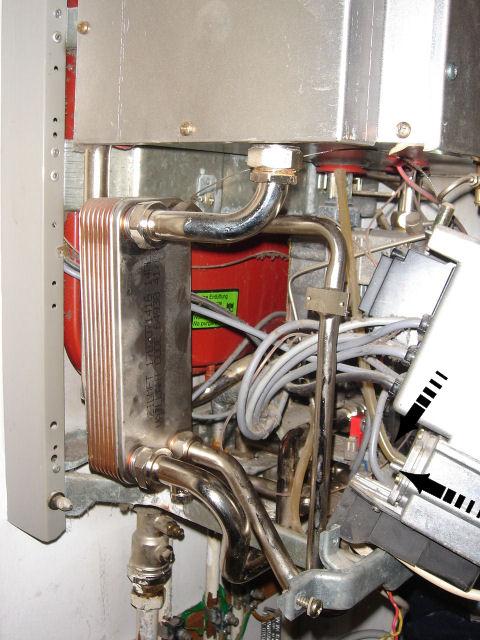

Have you disturbed the small flexible hoses on the back of the control box? Check thet are both fitted securely (at each end) and not split. These are used to control the burner gas pressure.
Thanks gasguru
I may have disturbed them as I had the control box pulled forward to get to the w18 link. Is this the clear 5mm pipe that goes to the bottom of the main heat exchanger. Don' remember seeing more than 1... :LOL:
Thanks for the picture,I can see both the tubes now.
