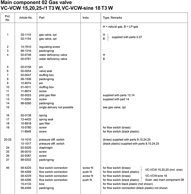

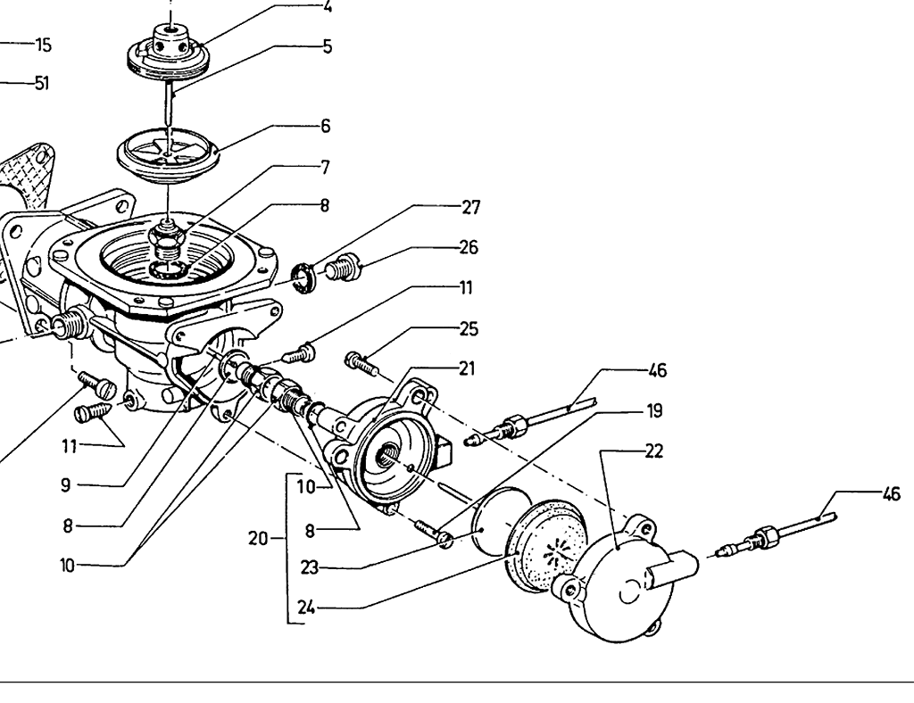

the pressure differnce switch is leaking from the pin area and the internal washer seems to be gone.The manual does not have the part number for the pressure difference switch ,does anyone know where i can get one.
