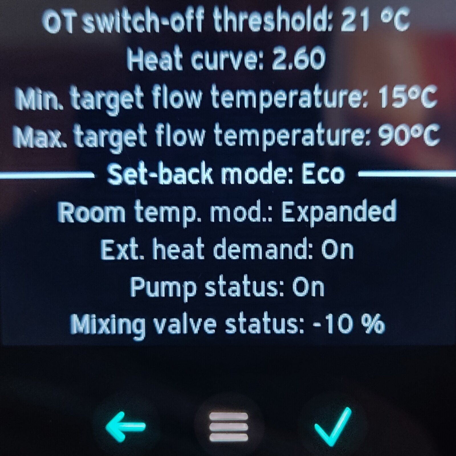

Hi @ScottishGasMan Thank you for your reply! I checked this morning on the menu. I couldn't find the setting you're referring to. Is it the setting under Room temp. mod? I currently have that set to Expanded as per Vaillant's tech support. Should I switch this to Active or am I missing another setting?

Sorry wasnt very clear, your in the circuit menu, press back button to come one level back, and scroll up to top where "installation" is, tick into that and then you will have adaptive heat curve in there.
While were on the subject, your pic shows set-back mode at eco, generally, with weather compensated systems we want to use the set back, so I'd change it from eco to normal, and then you have a minimum temperature that the house would drop to, makes reheating quicker and uses lower temps as its not lifting the house from like 10 degrees all the way up to 20 every time it kicks in.
The actual set back temp (the temp that the thermostat aims for outside your regular heating times) can be set under the control menu, in where youd set your heating times.
On mine I have set:
Setback temperature 18 degrees (this means outside heating periods the control will bring the boiler on at lower temp to maintain at least 18 degrees in the house at any time) you may want 16 or 17, but I'd personally not go lower than that.
CIRCUIT1 menu:
OT Switch off threshold: (this is the outside temperature when the heating will cut off) you can leave it at 21 and turn heating off in summer manually, I set mine to 16 degrees, so any time its above 16 outside the heating is automatically off, you tend to find 16 or above air temp will only be at times when theres enough solar energy hitting the outside walls to maintain a comfy tempearture in the house during the day anyway, and if it dips in temperature over night the heating will come on at lower flow temp just to keep the chill off.
Setback mode: ECO= No setback, outside of timed heating periods the house will cool down, NORMAL= setback active, so control will maintain the minimum setback outside of timed periods, stops the place getting too cool, and then causing it to take a while to heat back up the next time the heating is on.
Room temp mode: EXPANDED will be the best setting for yourself probably, I use active, but that means the boiler and pump run 24/7 and vary only the flow temp to maintain a constant room temperature, expanded turns heating on and off depending on the room temp and what you have set. Generally for boilers Expanded will be the best method to use. I'm setting my system up to take a heat pump soon so my settings lean more towards whats best for them.
This is invaluable thank you. I switched off eco as you said for the set back and also turned on adaptive.
