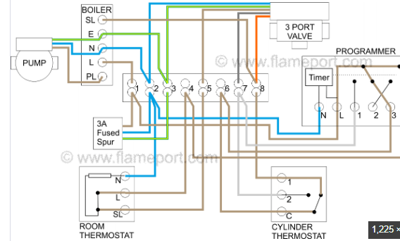

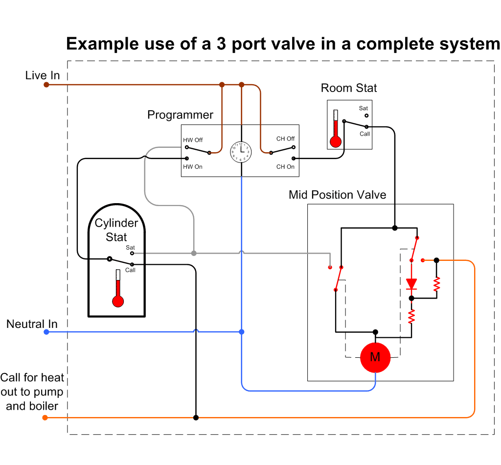

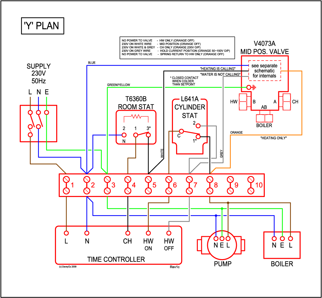

Here are two schematics of a Y plan, in both, the switched live starts both the boiler and the pump, very common in oil fired boilers with no pump overrun, but most, if not all (now) Gas fired boilers, the switched live just goes to the boiler which will have a permanent live to do the required switching, pump overrun etc.

So this would need checking the orange wire on y plan is switching 230v to 0 when turn controls on and off ?
Yes, check live feed back to boiler

Have you got a permanent live to the boiler?, if so and the Vaillant engineer is correct, "Vailliant engineer stated there no cable from y plan to boilor for pump and on Valllliant you need that or can gdt F83." then that permanent live will only logically be used for frost protection. If no permanent live supplied or required (for pump overrun) then the Y plan switched live just starts/stops the boiler & circ pump simultaneously. You should only get a F83 (assuming circ pump OK) if the boiler is firing without the pump running or if it starts firing before the pump starts or stops firing after the pump stops.

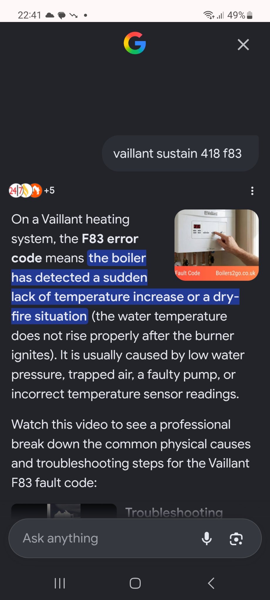

The inage shows it can f83 can happen due to incorrect temperature sensor reading which can be caused by the boilor not controlling pump correct as will be in my case as its not wired to boilor like it should.
If, after the boiler (burner) shuts down when either its switched off manually or is shutdown by the (last) room stat or cylinder stat and if the pump runs on for a few minutes and then stops, then the system is wired correctly and installing this other wire directly won't cure a F83 problem IMO, buts lets see.
THis is logic apparently behind it.
The Sustain 418 is designed so the boiler can keep the pump running for a short period after the burner switches off. That pump overrun carries residual heat away from the boiler and helps stop the boiler getting too hot internally.
If the pump is powered only from the old Y-plan wiring, the Y-plan can shut the pump off as soon as demand ends. If the pump is connected to the boiler’s pump output, the boiler decides when the pump stops, so the overrun can work properly.
