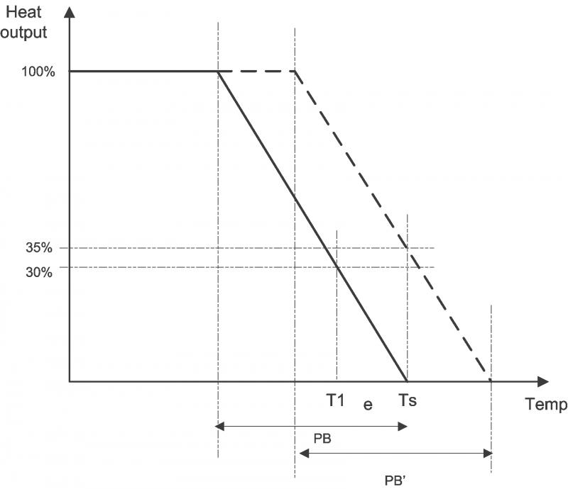

The proportional band is just the temperature range, below the set temperature, over which the boiler output is varied. If the difference between Actual and Target is greater than the PB, the boiler will run 100%. If the Actual is 50% of the PB below Target, it will fire 50% of the time. It doesn't matter if it's mild.
There is a question over what happens if the required firing time is below the one minute minimum. Does it run for one minute every cycle or does it miss a turn? I suspect it misses a turn - or drop out, as you call it.
When I've nothing better to do, I'll sit by the boiler and monitor it! :lol:
I think you are not accounting for the integral action of the controller. The proportional band will not normally be entirely below the set temperature, but around it.
Referring to the diagram, in this example the controller is initially set up so that the target temperature Ts is at the top of the proportional band PB. When the temperature reaches (Ts – PB), the system output starts to reduce and will stabilise at some temperature T1 where the output (30% in this example) is sufficient to balance the heat loss. The system will not reach the target temperature because its output is constrained by the position of the proportional band. There will be an error e = (Ts - T1). However, the integral action of the controller eliminates this error by pushing the proportional band up to the position PB’ where the target temperature is achieved (at a slightly higher output of 35%, because it takes more heat to maintain a higher temperature).
The position of the proportional band with respect to the target temperature will depend on the heat demand required to maintain the target temperature, which is effectively a measure of how cold it is outside. When it is mild, the target temperature will be close to the top of the proportional band because the output demand will be low. This is where we get into the issue of how does the controller output respond when it only requires a very low output.

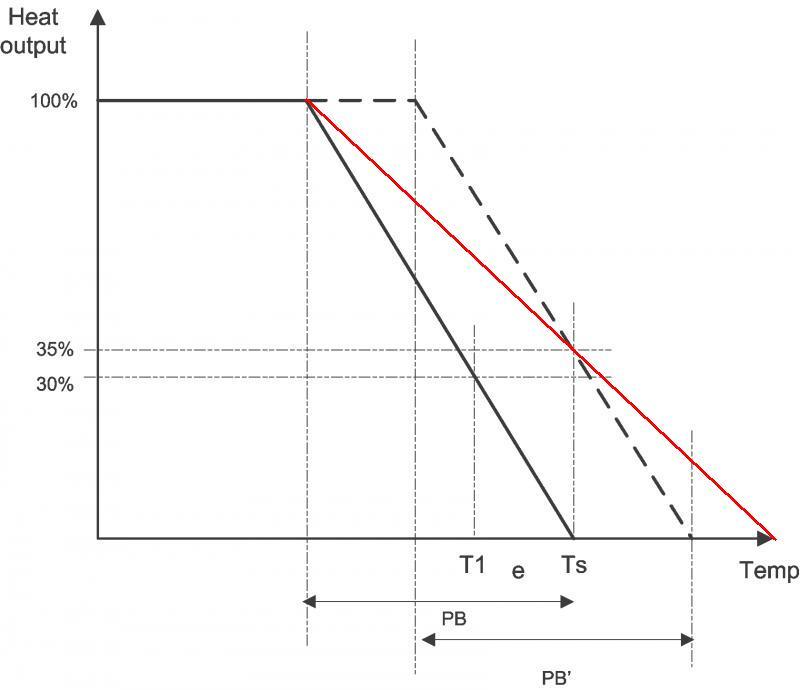

I can understand that, but I'm not sure that it's correct to say that the Integration part of the process moves the band up/down, parallel to the original band. Couldn't it also change the slope of the band?
The slope of the proportional band is effectively the gain of the proportional term of the controller. So with a proportional band of 1.5°C, the gain is 66% change in output per °C of error. When changing the proportional band parameter, you are changing the proportional gain of the control system and thereby changing the dynamic response of the system. The integral term of the controller removes the static error over time and ensures the long term control accuracy. Have a look at the description of Reset (Integral) Control Action in the Transcat note.

Agreed, but the initial setting is only an approximation of what the correct gain should be.
Agreed, but there is more than one way of doing this; e.g the red line.
It would be possible to do what you suggest, but you are then using the integral action to change the proportional gain of the system which will then affect the dynamic response. This would not normally be desirable.
But you can't assume that the initial proportional gain is correct; P and I are interdependent.
