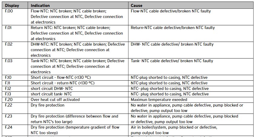

Hi all,
I've got a Aquaplus VUI 362-7 and seem to be getting a repeating F24 error, which means heating is stop/start and also i don't seem to get HW on demand, only the quantity pre-heated in the storage tank then it runs cold.
F24 from searching appears to be a multiple list of things to check, but mainly the pump or pump-head.
From anyones experience is this likely the error here? I've had a new PCB in the boiler not long ago, so i'd hope its not that!
Cheers
