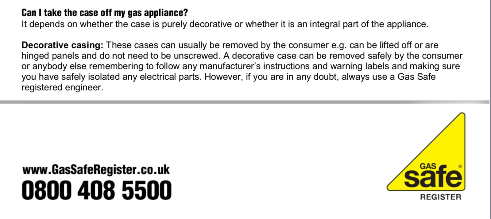

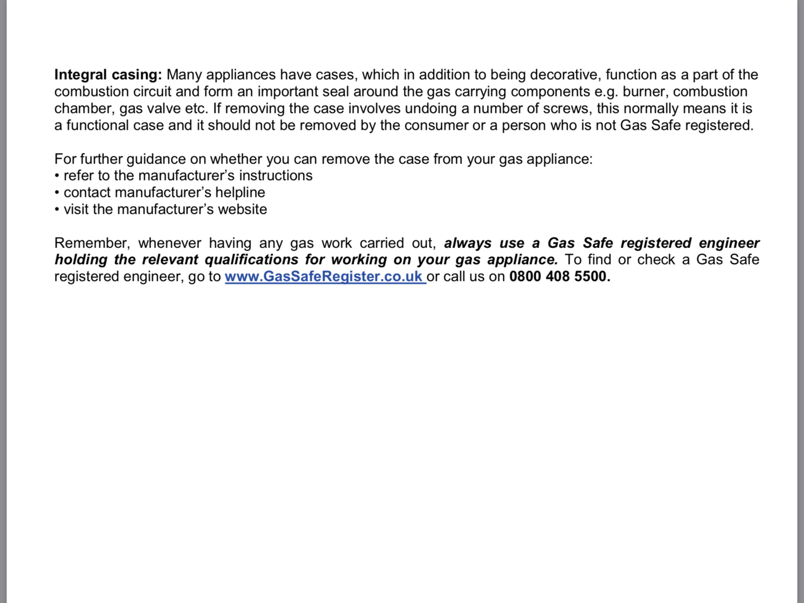

Why are you so bothered about these checks. You must be the only novice to do this.
Actually most professionals carry out these checks, and it’s required under the gas safety installation and use regulations 26.9.
It is a non issue.
Try telling that to gas safe and the HSE. Also, since you know this and obviously other gas related stuff, why are you asking on here then?

They dont. I know a bit more than average, but still find forums useful. If replying to people in future i would just go easy on the health and saftey.

if you have never seen an engineer check that issue then I would be getting a different guy in . It’s not scaremongering at all it’s carrying out all of the relevant checks . It’s arrogant people like you that think they know it all that really p1ss me off . You won’t be getting any help on here pal
I said most do, myself being one of them. Obviously @Stadan20 and @ianmcd agree, as would many gas safe engineers on here.
