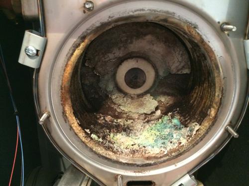

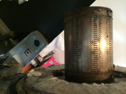

So, I've grabbed the photos that were taken of the boiler and it looks like there is green limescale looking material around the 'heating element' along with the inside of the 'drum' too. We have a water softener installed - an Aquadial. Presumably something like this would have been picked up on in a service perhaps?
Many thanks
What do you think of these images?
[/img]
That's not lime scale the insulation panel has disintegrated.
