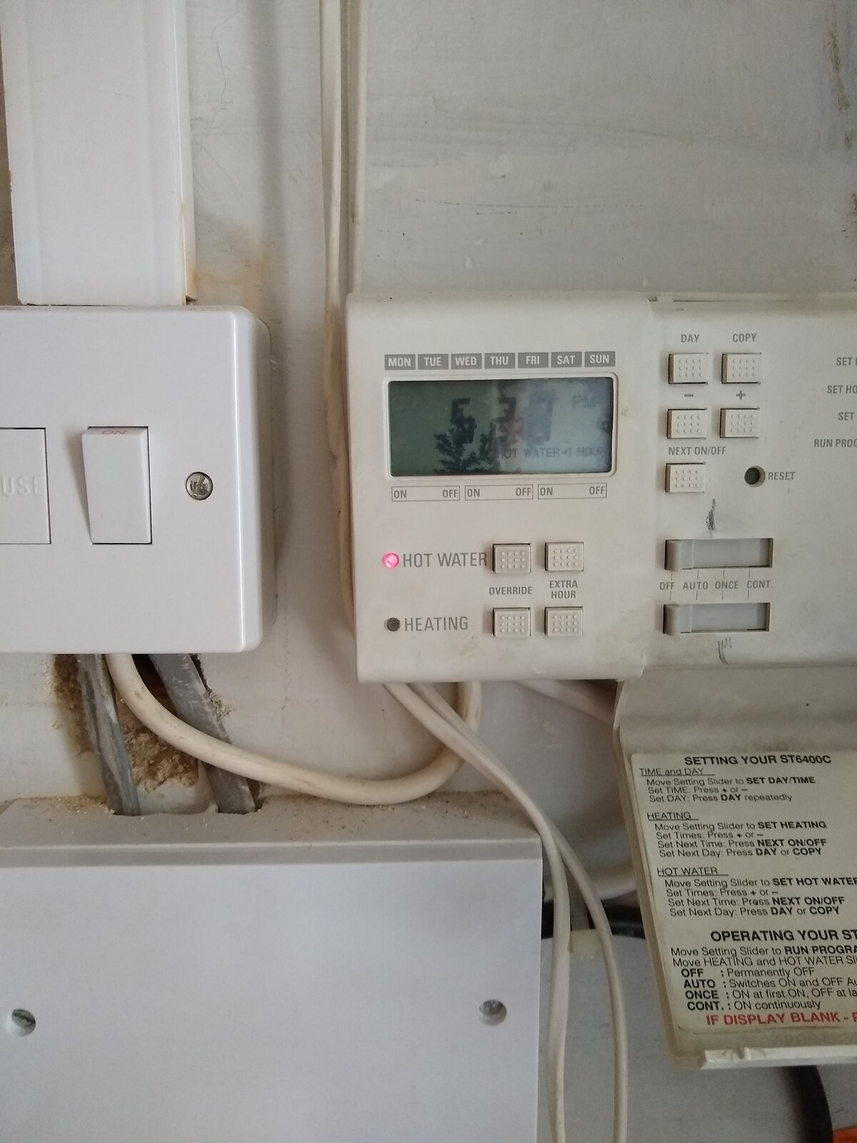

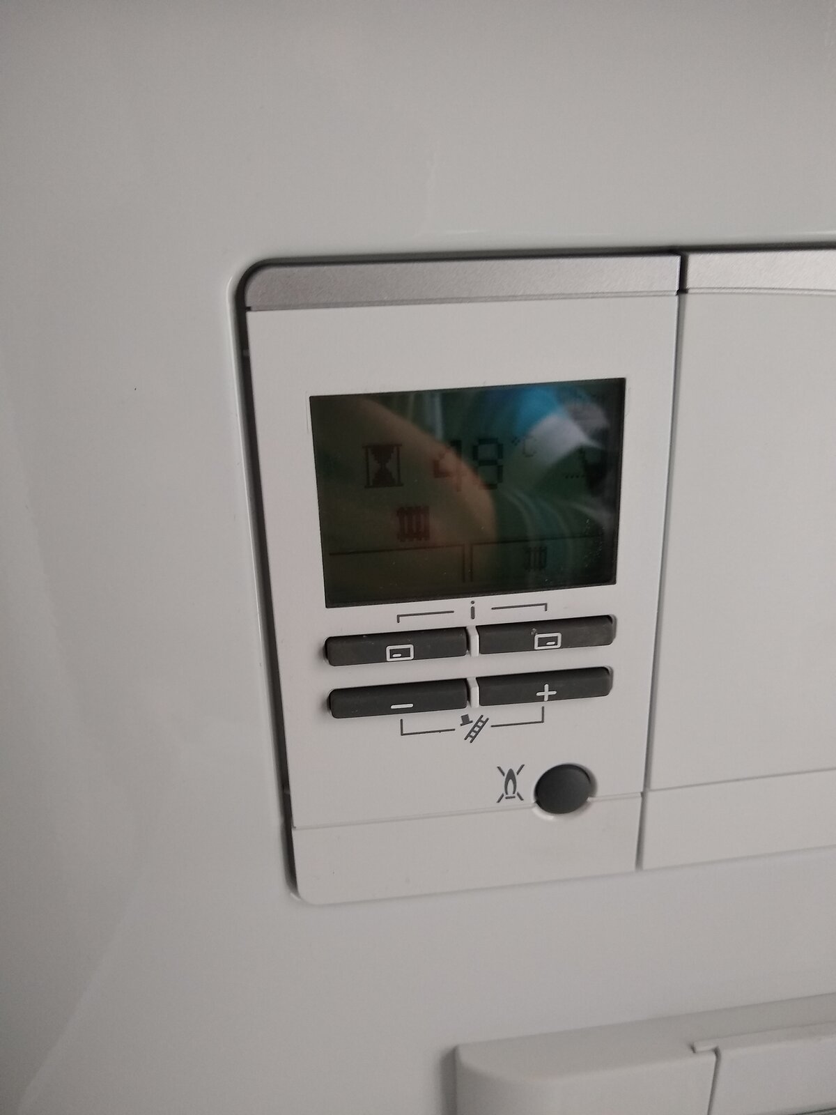

We've recently had a valliant ecotec plus 624 installed and when I turn it on to heat the hot water a radiator symbol appears. The tap symbol never comes on and a timer symbol occasionally flashes. It appears to be heating the tank up though. Is this normal/anything to worry about?

As you don't have Vaillant controls the boiler doesn't know what it's heating. There is nothing to worry about.
That's great, thanks. And the intermittent flashing timer symbol is all good too?
