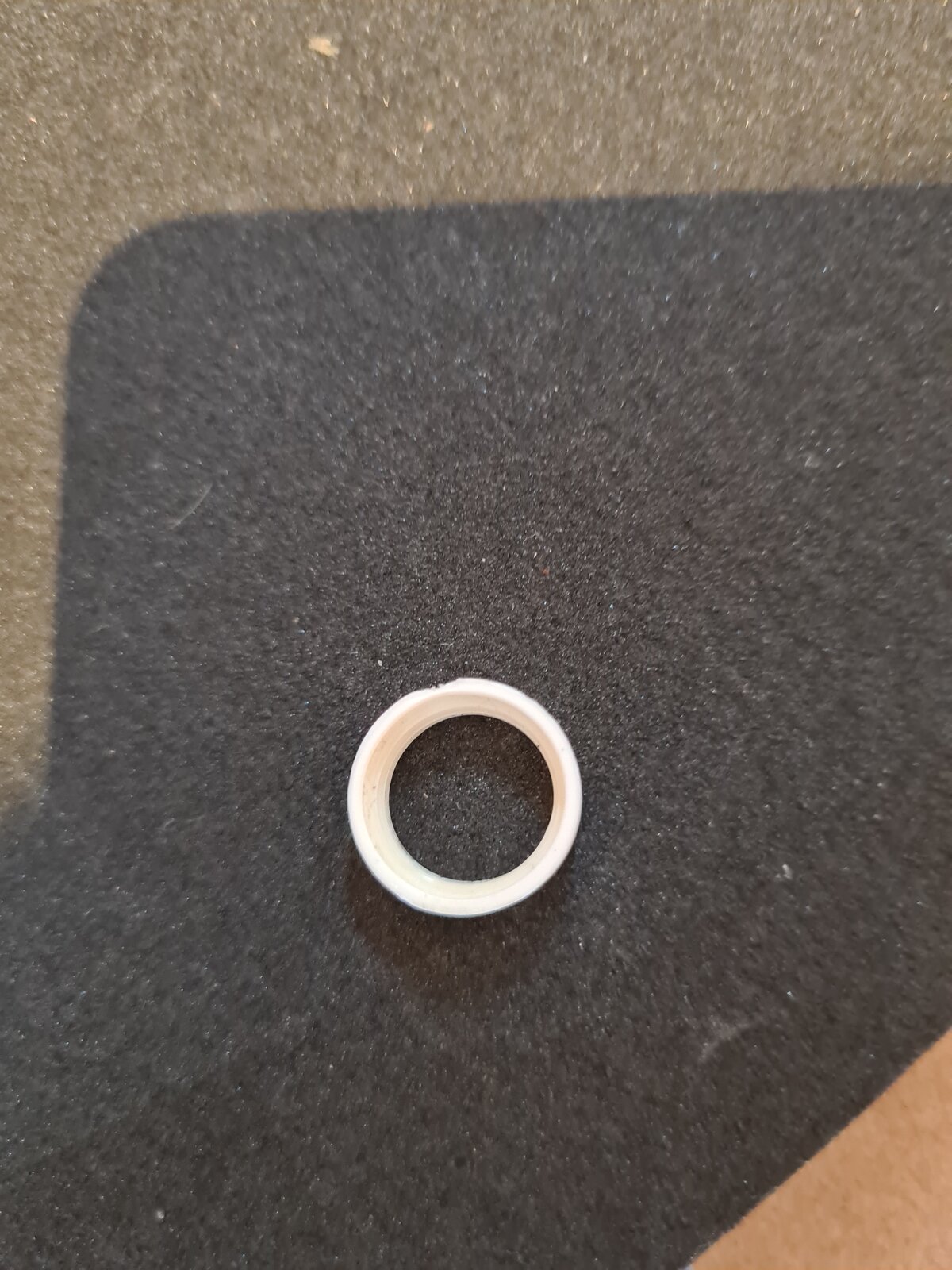

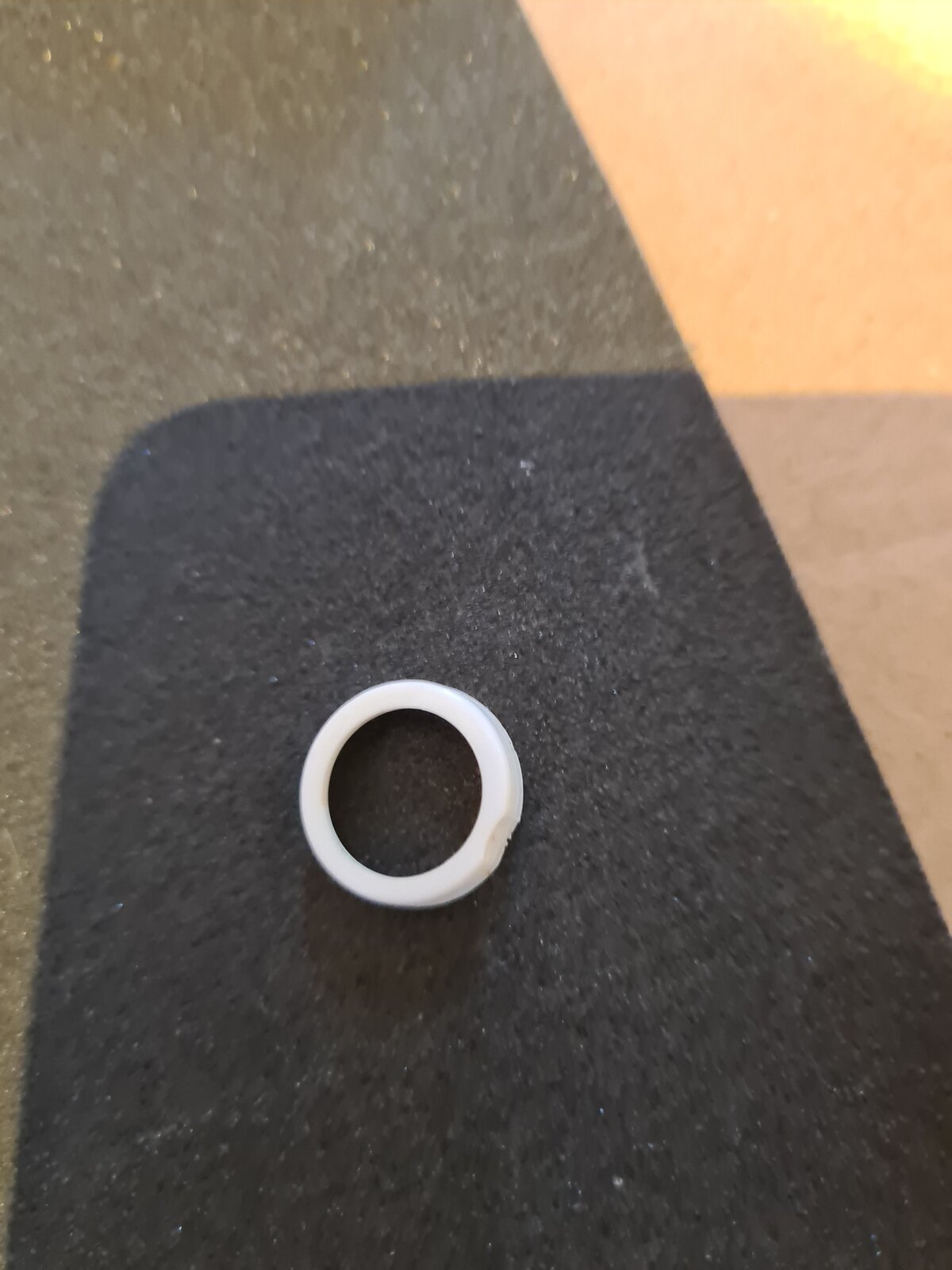

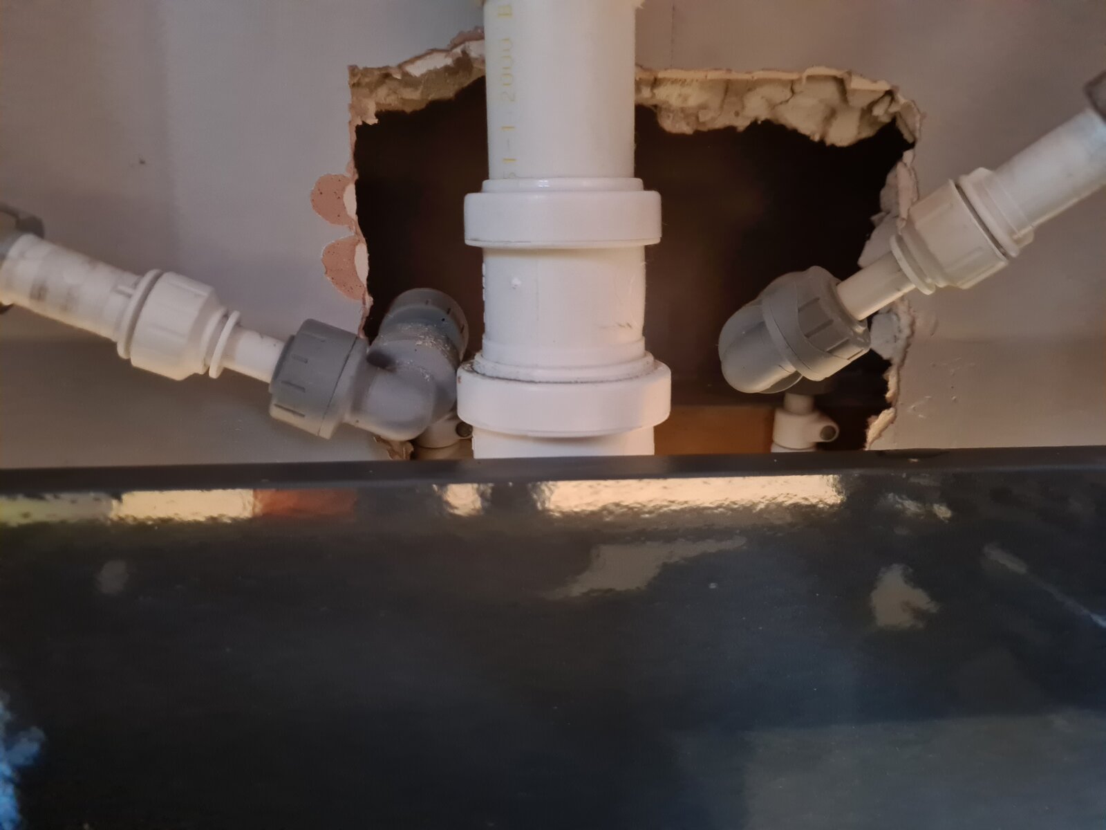

The taps miles too small . I took the tap out and having replaced everything found a plastic cap in the bowl. Everything's dry but for the life of me I can't see what the caps off so any ideas? I just don't want to end up with a flood. Pictures are the cap and installation.

Have you taken apart any of the waste fittings ? What diameter is that part ?
I took the u bend out, cleaned it and put it back. I removed the tap and disconnected the pipework by removing the white pipe entering the grey elbows. The collars ( I found a 2nd one in the towel I used) are about the same diameter of the smallest white pipe you can see.
The smallest white pipes are water supply pipes ,and you reckon they are the same diameter as them ?
That's odd ???
If that collar is 15mm it's part of one of push fit fittings goes in first before O ring.
Also you say your taps too small? are you sure there isn't a larger chrome ring that sits on basin before tap?
