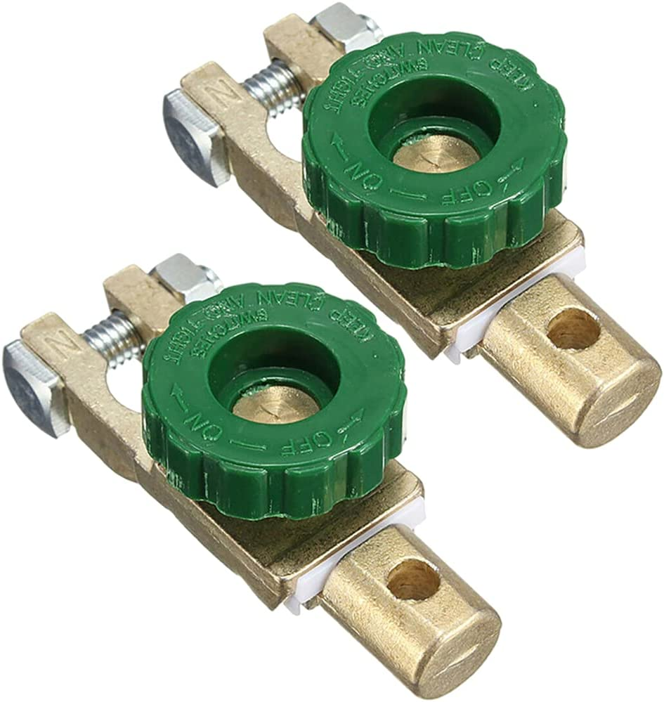

Anyone remember these ? How would you add these to a modern battery? :rolleyes:
Hi M,
Yes, I've never used them though.

On his last vehicle, he had a power switch fitted, to disconnect most of the current when not in use, apart from the alarm system etc.
Doing that, is dependent on how the vehicle is wired. My car spends lots of time parked in my garage - I have it on a dumb charger, which tops it up for 20 minutes per day, every day.
